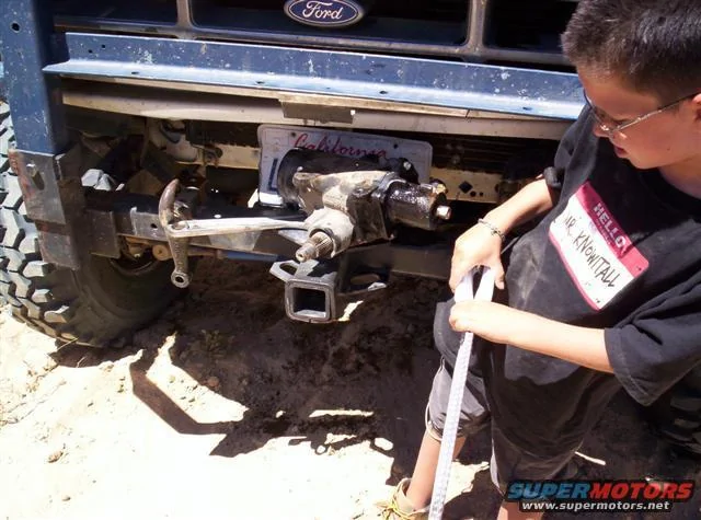

Im completely new to anything with IFS, but I used to help set up other people's jeeps at an offroad shop. One time my shop was called out because of a drag link break that happened out on a trail. Had to replace the end to get the jeep mobile again. When we explained why we'd attached a cheap-o parts store drag link end to a very expensive chromolly drag link, we had to explain that we'd purposely built it that way because the next thing in line to break would be his sector shaft! Theres nothing you're doing about that on the trail lol something to be mindful of as we begin to beef up the front ends on these Broncos. Leaving yourself a relatively inexpensive weak link somewhere, and carrying a spare could be a good idea.
And because I honestly do not know, what would theoretically break next on the bronco's front end if you were to use better tie rods?
Been there, broke the sector shaft, carried a spare box from then on out.
