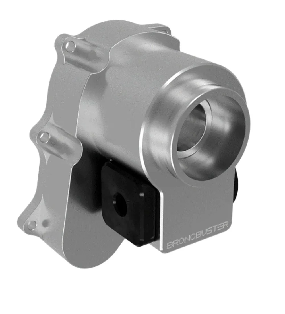

posting here for discussion. Pricing will be ~$1000 according to the comments.
Edit: it’s out and it’s $1200😲: https://broncbustertx.com/products/passenger-rack-and-pinion-billet-aluminum-housing
Ford Bronco Second Broncbuster Steering Rack Reinforcement F4EB72C1-DB17-4A7B-AD5B-DCC11B4B2EF1
Stage lll heavy-duty passenger billet aluminum housing
Stage lll Heavy-duty passenger Billet Aluminum Housing for 2021-2022 6th Gen Ford Broncos. CNC machined from T6061 and reinforced with a hardened steel bushing for long service life. Our design encapsulates the steering rack ball screw on the passenger side in a manner that not only eliminates the passenger rack housing failure but reduces stress on the electric motor by minimizing steering binding issues. All lifted Broncos will benefit from the enhanced steering and eliminate metal shavings that will likely lead to premature rack failure. If you modify your Bronco suspension geometry, you should consider this upgrade first.
* The Stock rubber mounts are retained and reused on this housing *

Good information and thanks to these guys for pushing the limits and trying to come up with solutions.
but jeez that video was long. 25 minutes of talking!
also, I understand that the 4x heavier housing is stronger, but curious how this beefier housing prevents the shaft inside from flexing?

if I understand correctly the housing is machined to function as a bushing the total way across instead of the stock which does not support the shaft but only has a small seal. It seems to be a similar concept to the current bronco bushing but in full CNC aluminum, I look forward to more info and testing to see how it does.
its the Passenger side of the shaft which is worm gear so i believe it would eat up a bushing over time. Plus the stock structure looks weak compared to the billet piece.

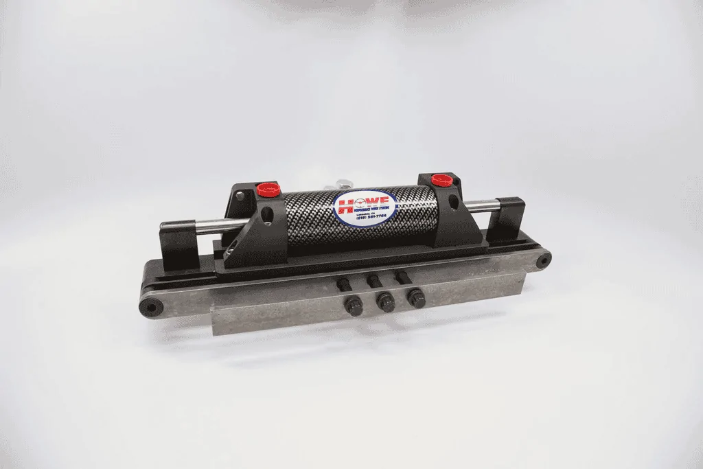

Almost what a real rack costs! This is what the KOH broncos run that I think Geiser built.

Lots of luck getting that street legal. Likely have to add a return to center orbital as well as a bunch of other stuff.

Those start out around $3500 and go up from there.
My son and I have used both their 6" and 7" rack and pinions in KOH IFS set-ups.
Nothing that would be illegal in that set-up.
It is a true rack and pinion that is connected to the steering shaft. It just has the assist ram on it to help turn the big 40" tires with ease.

Well that’s super cool. I had no idea it was still attached to the steering shaft. Even at that pricing, it may be pretty competitive with all the “solutions” out there.

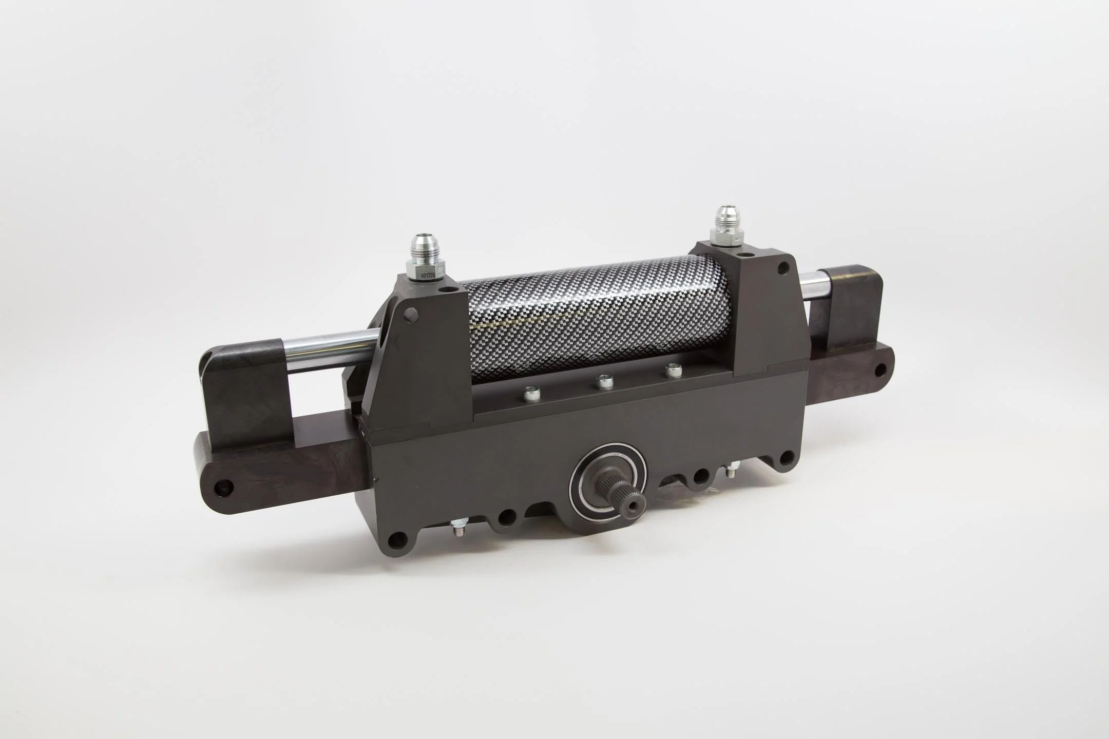

Here's the back side, you can see the input shaft for the pinion gear.
That $3500 starting price is just for the box, you still have to add a control valve and then a decent hydraulic pump, cooler etc. It'd be easy to get into the $8K range or more to run one of these.
Haven't messed with them in a few years, so that pricing estimate is probably way low too.
