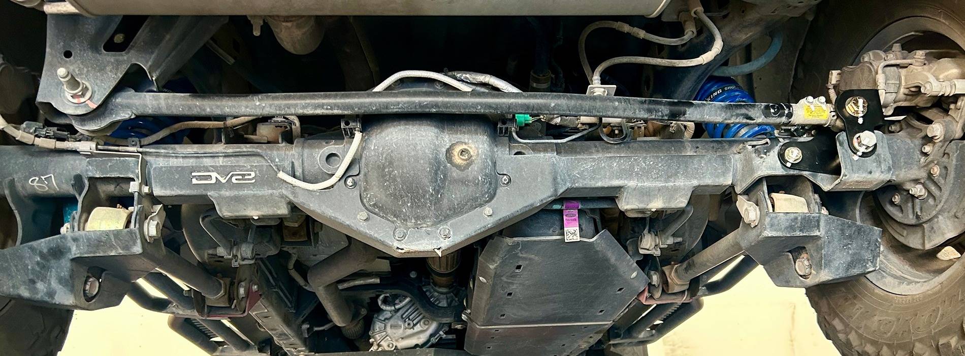

Ford Bronco Rear TracBar Relocation Bracket - Get One! IMG_7287
For a proper comparison - The Ranger Raptor has solved this issue with a center-link system. Regardless of how high or low the travel of the axle it always remains centered and handling/geometry are not compromised. Very cool tech I might add, shown below:
Ford Bronco Rear TracBar Relocation Bracket - Get One! ranger track bar

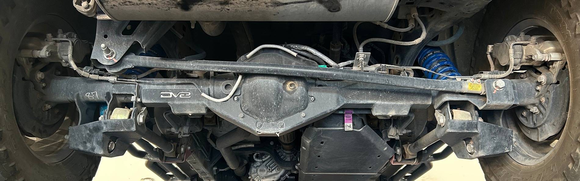

Now, back to the Bronco - Let's say we REMOVE BOTH the rear control arms and rear shocks that are attached to the axle - and the ONLY thing connecting the Axle to the vehicle is the track bar. With the vehicle on the ground, if King Kong (for lack of a better example) were to lift the body upwards, as long as the wheels remain on the ground, they should remain centered in the same spot about 25% of the way up. But the track bar will keep exerting more pulling force the higher it goes - wanting to DRAG the axle to the left. A relocation bracket LIFTS UP the connection point on the axle, correcting geometry and actually improving it by "delaying the angle-rise of the track bar." As seen in the pic below:
Ford Bronco Rear TracBar Relocation Bracket - Get One! IMG_7290 2
What this also accomplishes, is it spreads the lateral loads more evenly - meaning left and right movements (pulling to the right, pushing to the left) as the suspension goes up and down. This translates into better handling since the forces travel a shorter distance and are on a more level plane. This is felt through better steering inputs (road/trail feel). It is thus better, but not necessary, to have an adjustable track bar as well - so that a proper alignment shop can dial in the perfect length the track bar needs to be at, depending on your lift.
I hope this explanation helps clarify things :thumbsup:
