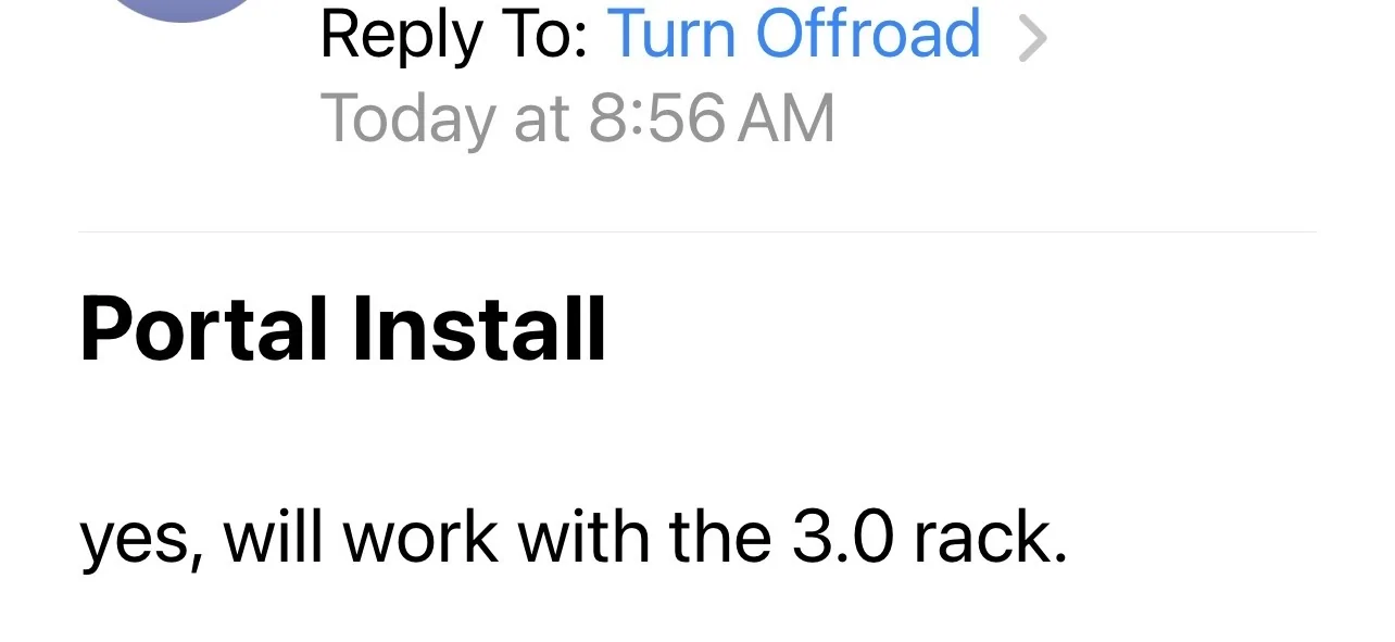

The original question wasn't whether Hoss 3.0 could be run with portals but more so whether it could be run with the steering tie rods that Turn Off Road actually makes that's all. It was about their steering upgrade nothing more just tie rods. I don't doubt their portals, I actually like them I was just expressing concern for steering because 74weld has the same track expansion but they beefed up the rack much more than the stock rack so this must have been for a reason. So can you answer directly if Turn Offroad Tie rods can be run with the 3.0 steering rack or not, I also expressed I was getting mixed answers and was confused?
Call Turn and get it straight from the people that make them.
Otherwise yes, the threads will fit. The boots however may not as they were designed for a 2.0 rack. The 3.0 rack is slightly bigger. Sometimes companies have enough tolerance to accommodate the 3.0 rack. Call them and ask.

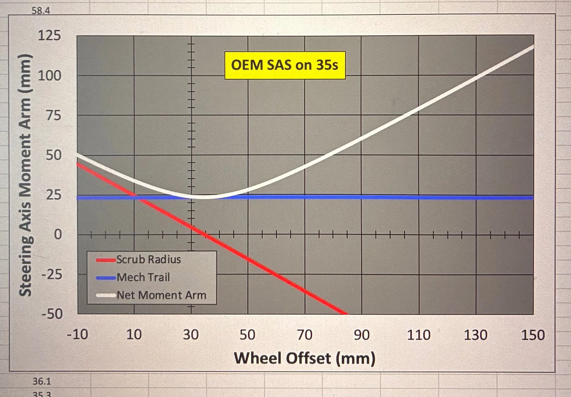

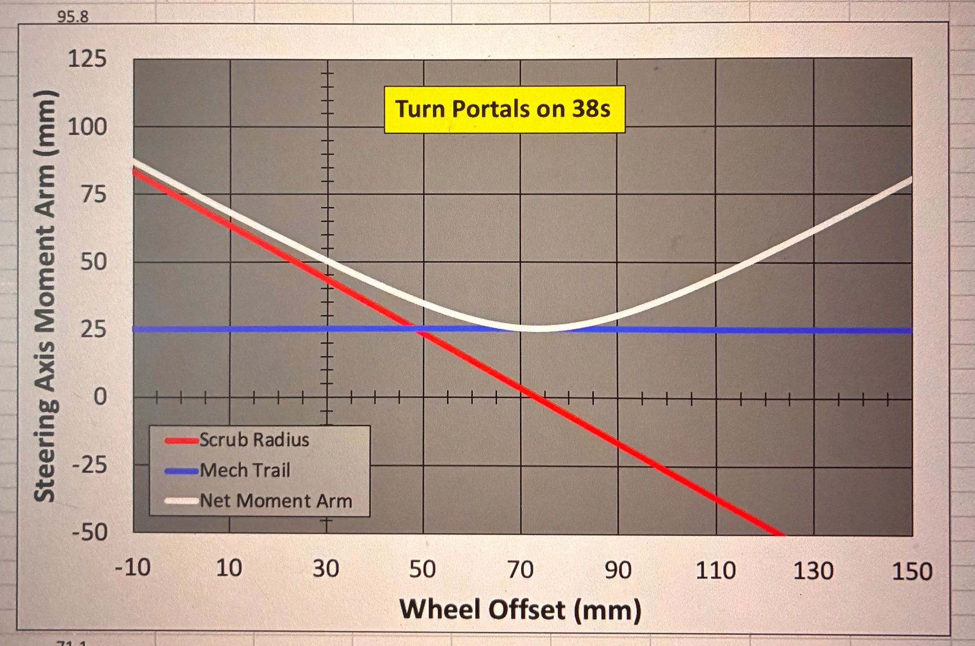

Just kidding. AI is awesome. It just quickly generated the net steering moment arm for SAS OEM and turn portals on 38s. Enjoy.
