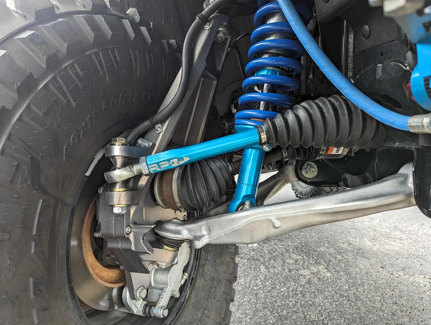

I am going to tell you with complete certainty, I have physically turned the wrenches..... If a HOSS 2 rack works then a HOSS 3 rack works.... Period. They are interchangeable. How do I know this with complete certainty? Because I have changed them out. Not on these portals but on the 74 weld portals, the connection is exactly the same.
Mine are a bit different but I changed out to the 74 weld rack and then went with a double shear connection. Minus the double shear they are the same.
Ford Bronco Turn Offroad Portals RPG Tie Rods

If the turn off road portals work with a HOSS 2.0 I promise you they work with a HOSS 3.0... You can even put the HOSS 3.0 tie rods on a HOSS 2.0 rack (or 2.0 tie rods on a 3.0 rack).... I do not recommend that.... BUT you can physically do it. The only connection between the portals and the rack is the tie rods.... SO if Turn created some new tie rod that only works with their portals (funny they do not mention that - design wise would not make much sense) and they can be threaded into a HOSS 2 rack... then they can be threaded into a HOSS 3 rack just as easily. I personally have sets of HOSS 2 tie rods and HOSS 3 tie rods and another set of RPG tie rods sitting at home right now.
