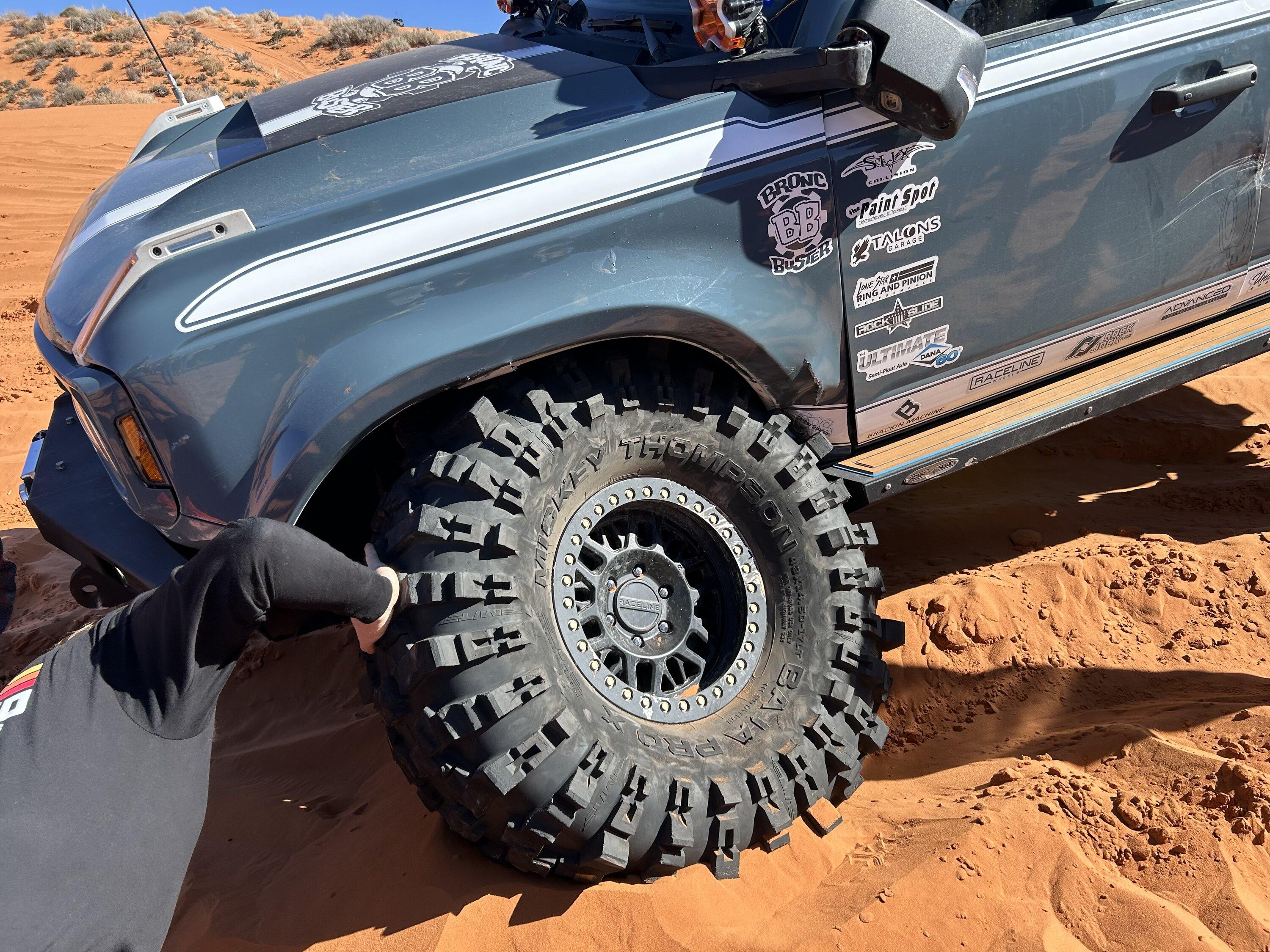

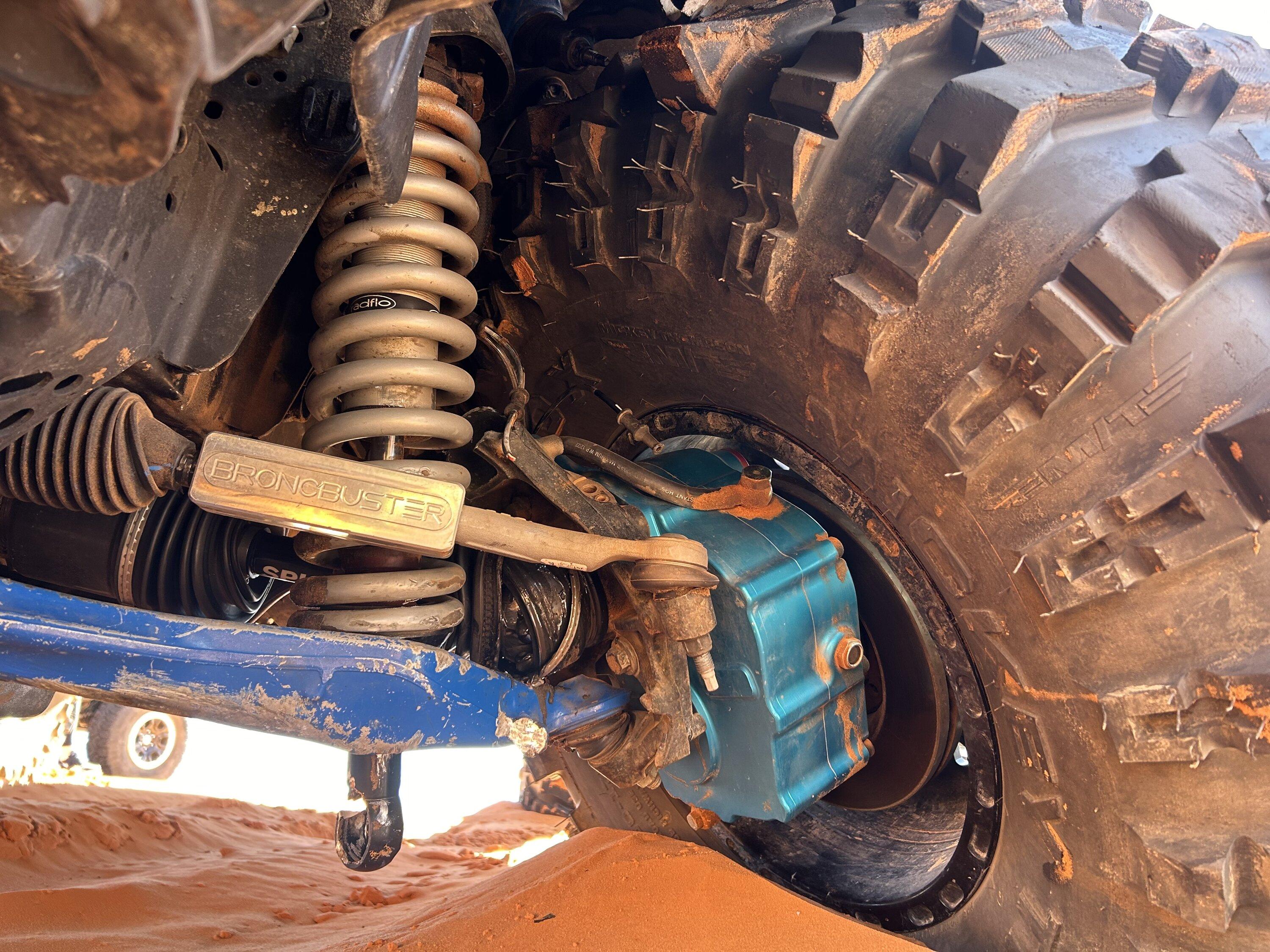

This just in. Happened today in Moab. My understanding is 74w has their own billet knuckle. BB bolts to stock knuckle. This is my answer to the OP.

Sorry to see that happen but would have been my guess. Happened sooner than I thought it would.

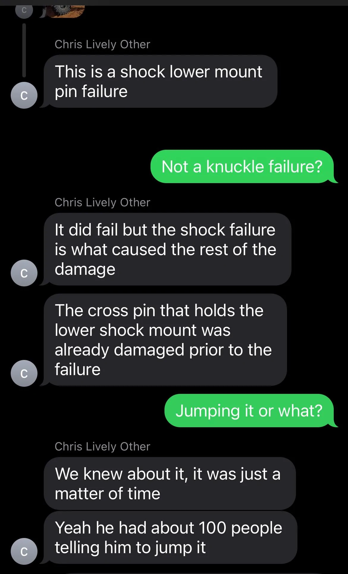

To be fair, the lower shock pin failed causing the above on BB

I don't buy that for 1 1000th of second. That knuckle broke, then when it hit the coilover it broke that too

The top of the knuckle is broken off.... The knuckle came inward and broke the coil over mount.... The coil over mount no way broke and then moved outward to break the Knuckle then moved back inward.... That Knuckle broke first and I think there was (past tense) a whole bunch of discussion about that probably happening at some point, even in this thread it was mentioned. Just way too much stress on that casting that the knuckle was never designed for.

43" tires on portals with dumbass behind the wheel, not surprising at all to me...the leverage those tires and portals add want to twist the A-Arms apart...Even if knucklehead made a billet knuckle then he would just destroy the UCA and the UCAs mounts. the OEM UCA is very flexible and it will be the next in line to fail.
