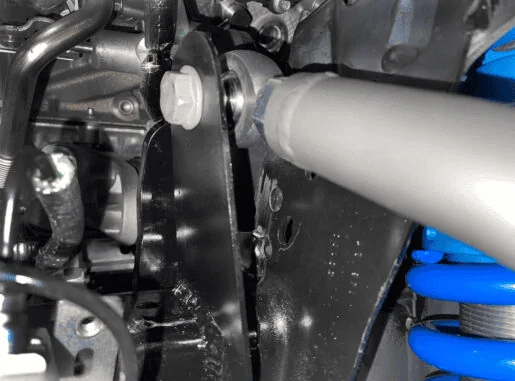

43" tires on portals with dumbass behind the wheel, not surprising at all to me...the leverage those tires and portals add want to twist the A-Arms apart...Even if knucklehead made a billet knuckle then he would just destroy the UCA and the UCAs mounts. the OEM UCA is very flexible and it will be the next in line to fail.

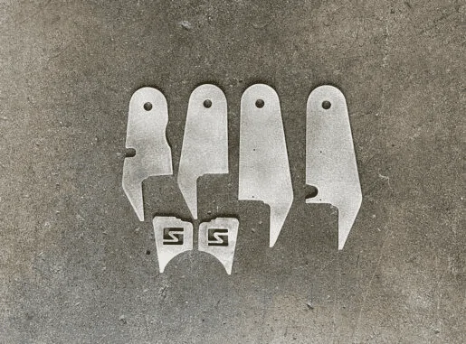

I have seen one company address the mount.
https://solomotorsports.com/shop/parts/ford-parts/suspension/2021-ford-bronco-uca-double-shear-kit/
