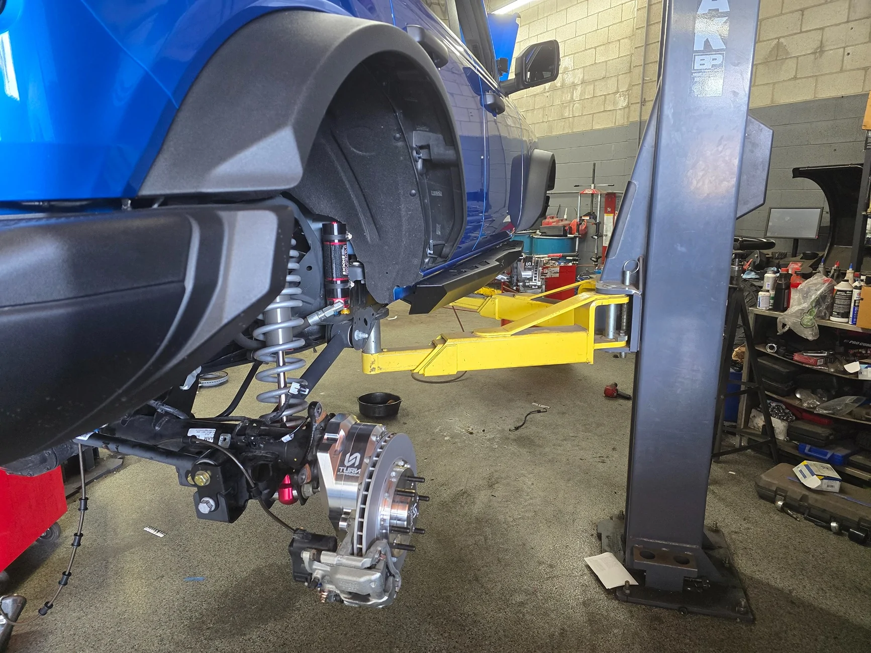

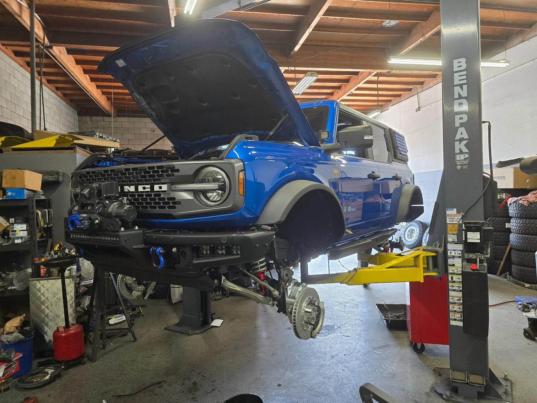

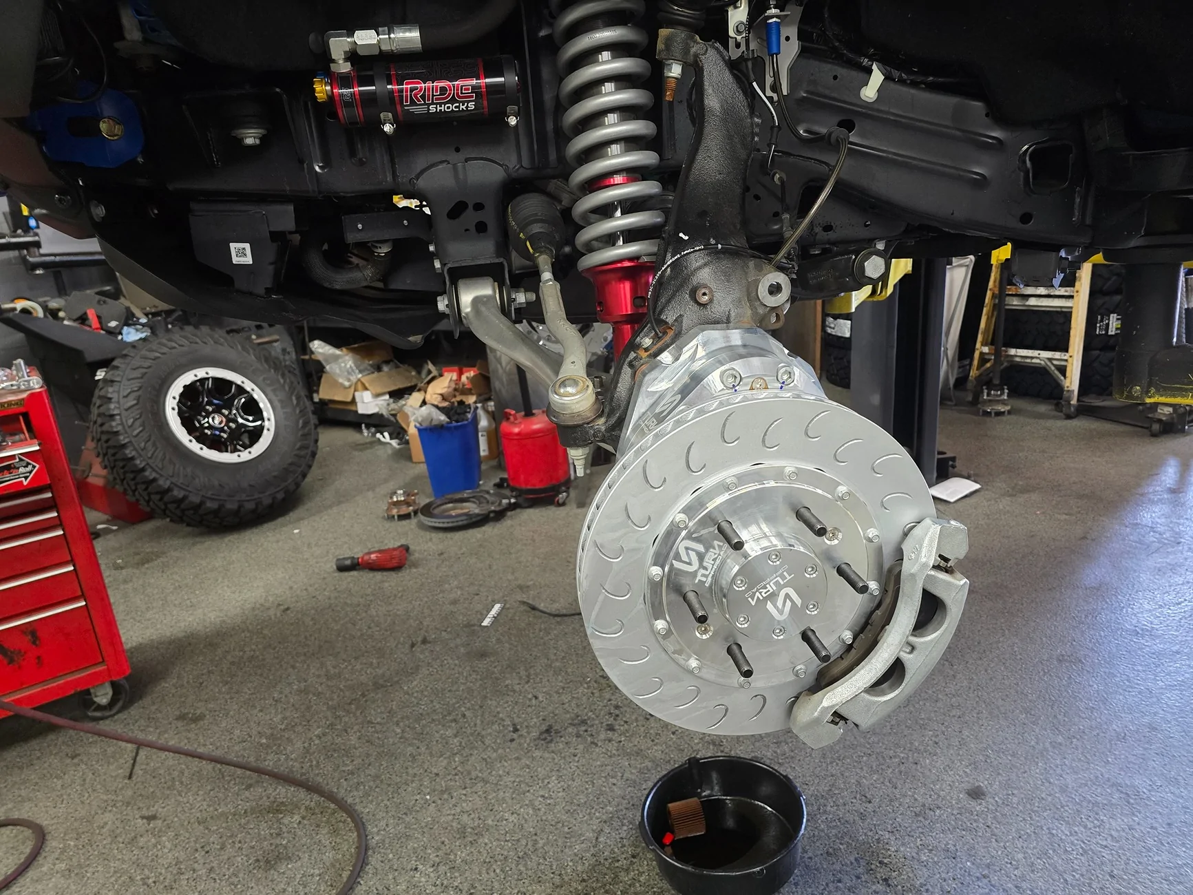

Coming along nicely. Smooth install so far and they look great. Portals will be done tomorrow but decided last minute to go with new wheels so will be a couple days waiting for wheels to come in.

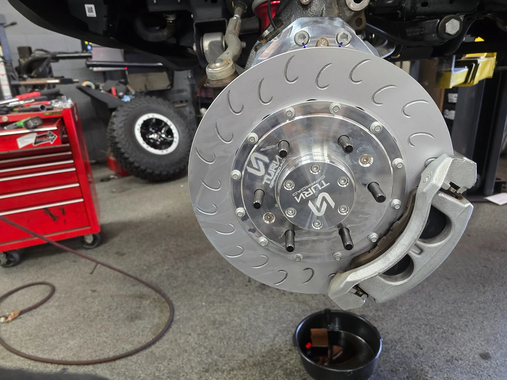

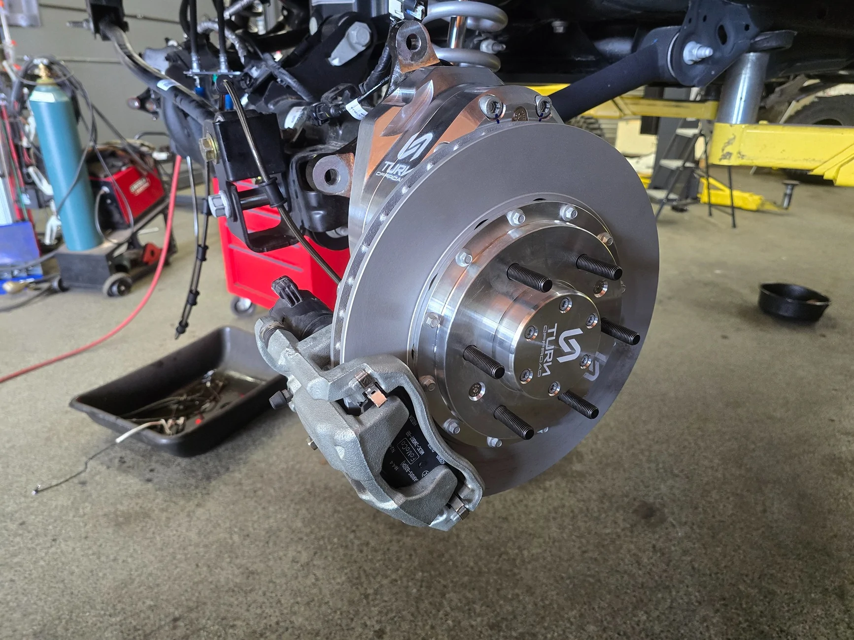

I don't like how the steel rotors bolt to an aluminum center assembly. Different materials, with different heat expansion and heat releases Loctite. Also would have liked to see the factory brake rotor mounts integrated in for more rotation strength.
But not that good good Alibaba Loctite!!! (y) (y) (y) :whistle: :whistle: :whistle:
The wheel flange appears to be 20CrMnTi

It's magnetic? Material looks like machined aluminum in the pictures.
I'm waiting on mine to ship, so have looked at the photos a few times. They've updated the page a few times since they went live, and in some newer photos you can see the flange better. They also just posted up the bill of materials which list is as 20CrMnTi. I do plan to use VT137 threadlocker which has good performance at sustained higher temperatures
