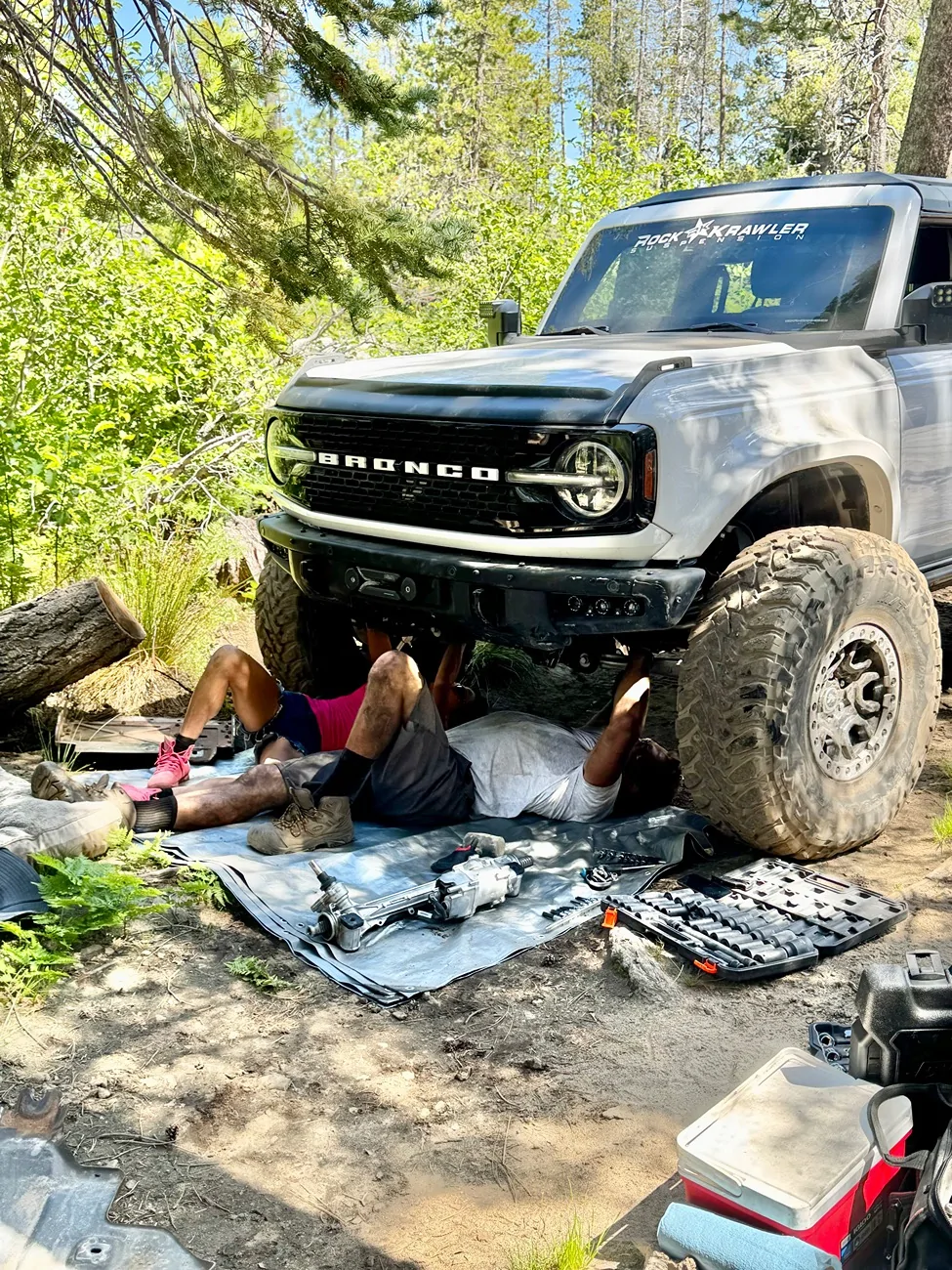

Just replaced our steering rack on the trail. Can confirm that the tierods are easier to change than the entire rack. Who knew?
If anyone is curious on how long it took-84 minutes start to finish. Including unloading tools. We’ve swapped a few of them but also took the time to clean the tierod threads with a pick. Your results might be better…or not…
If it took y’all 84 minutes, I’m sure it would take me three times that, and who carries a spare rack? Well yall of course. Lol.
When you have parts from 74weld it’s probably best to always have spares…
It took @mpeugeot and I like six hours in a driveway. 84 minutes is some NASCAR pit team speed!!
