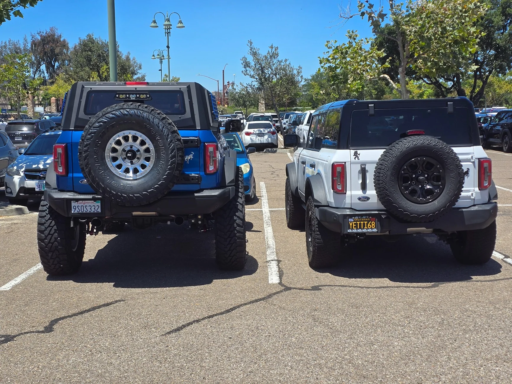

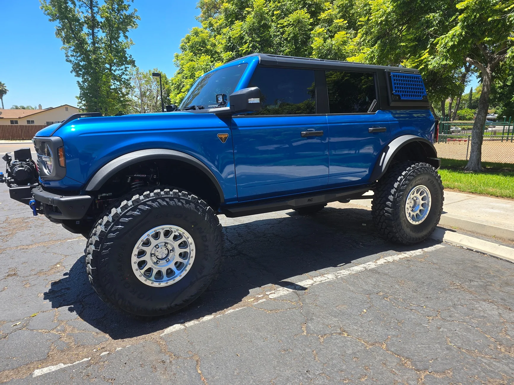

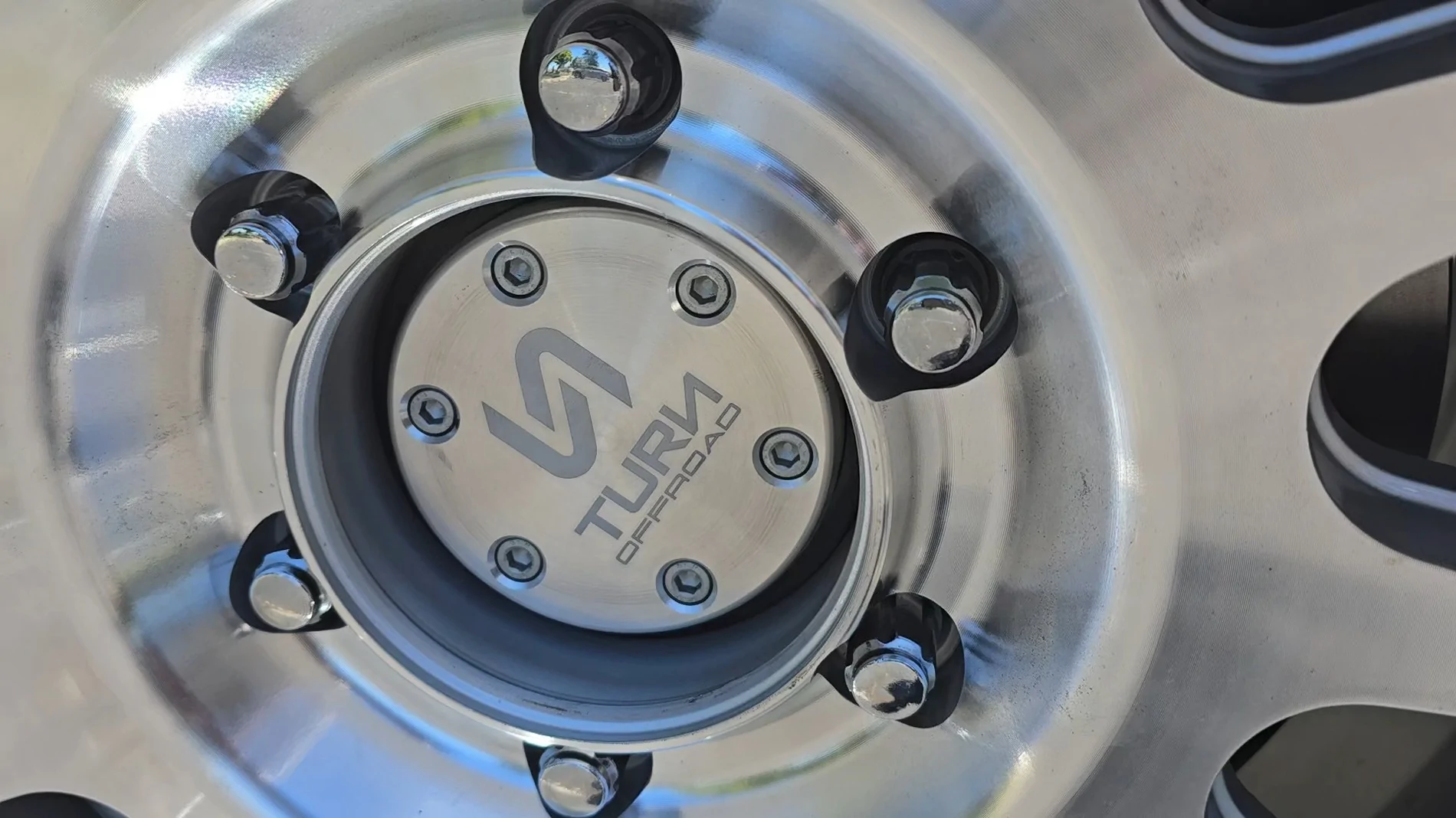

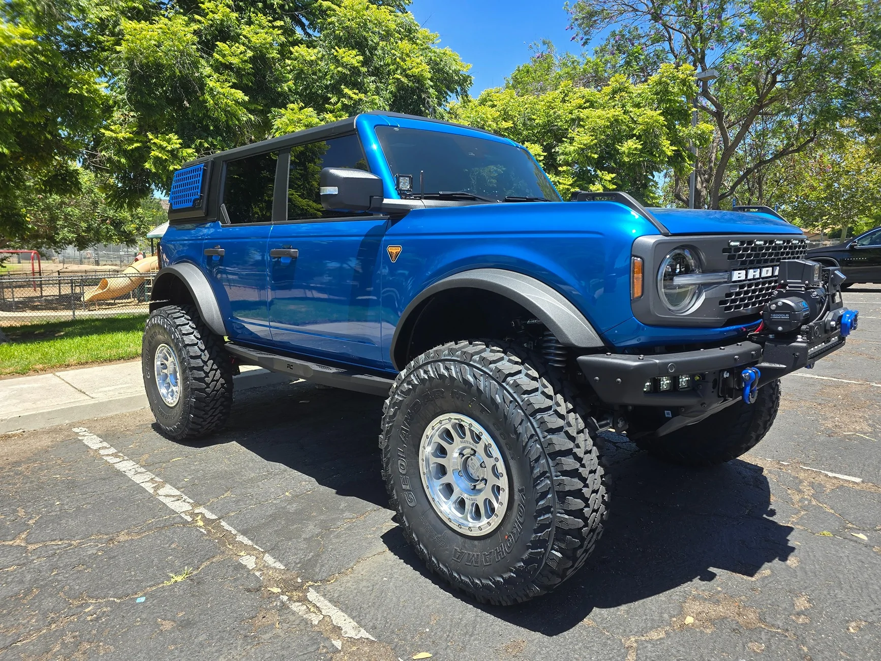

She's done! So far drives amazing. Went with Method 709HD 25mm offset and 40x13.5x17 Yokohama Geolandars. Loved the same tire in 37's and they are surprisingly light.
Wow that looks absolutely amazing man. What size wheel is that? Please post more pics from every angle possible lol.

Looks good!
When you get a chance measure the width from the outside of your tire tread and report back to the thread 🙏🏼
I am curious why you went +25mm offset instead of +45 or +55.

Also, If you get a chance can you please measure how much tire poke you got beyond your fender and how much vertical gap between the tire and the fender you have now.

Thanks! They are 17x8.5 +25mm wheels.
I'll be going out to get more pics hopefully tonight or tomorrow.

Thank you! Leagues behind your rides but coming along.
Outside of tread to outside of tread is about 85.5". Outer side wall to side wall is probably about 87.5 with eye balling.
For whatever reason Turn syas they dont recommend any higher positive offset than +30. The only deciding factor with choosing +25 is because its the highest positive offset these particular wheels came in. I was originally just going to run my stock +30 sasquatch wheels but wanted to switch it up.

Looks absolutely amazing I'm glad you went with the 40s, that was a good call, if youre gonna go with portals might as well go with the 40s.

That’s impressively narrow. You could get some longer a-arms and really step up the performance

Tire poke is 3.5" front and 3" rear.
Vertical tire and fender gap doesnt say much as it will all depend on where you have your suspension set at but im right about 8.5" front and 9.5" back.
