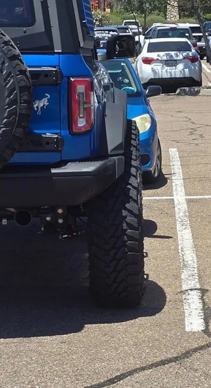

Looks absolutely amazing I'm glad you went with the 40s, that was a good call, if youre gonna go with portals might as well go with the 40s.
Well see what happens when i get it flexed out. From reading the 74W portal thread and seeing what all those guys tried and their experiences, I fully expect some rubbing and some new projects to resolve that.
SierraBronco
Mar 27, 2024
5,276
14,246
Vertical tire and fender gap doesnt say much as it will all depend on where you have your suspension set at but im right about 8.5" front and 9.5" back.
Gotta lower those numbers…😉

She's done! So far drives amazing. Went with Method 709HD 25mm offset and 40x13.5x17 Yokohama Geolandars. Loved the same tire in 37's and they are surprisingly light.

Thanks! They are 17x8.5 +25mm wheels.
I'll be going out to get more pics hopefully tonight or tomorrow.
You already have this one. MDM can see this if he looks. I’m actually surprised you don’t have more poke. Looks great.
