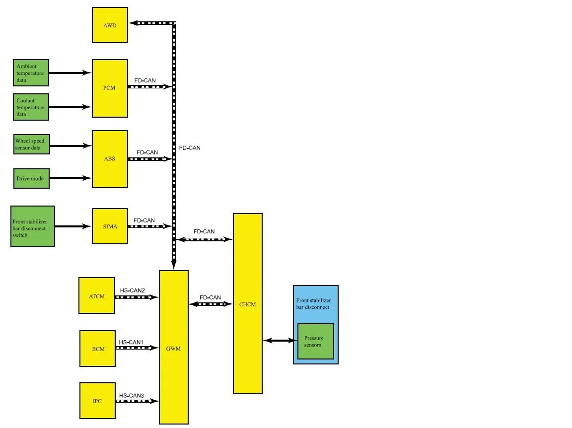

Yep, CHCM or chassis control module.
The only thing the ABS supplies is wheel speed and drive mode data for the CHCM.
well since it screws up the goat modes I respectfully disagree. I do believe the ABS module is very involved in this function.
for example in some modes, like mud and ruts, the swaybar is automatically disconnected. So the ABS module is likely received information from the CHCM, at that point? or is it the other way around? and the CHCM received the command from ABS?
Edit, your likely correct as I've tried Braptor ABS forscan changes with the goal to get the swaybar to stay disconnect at higher speeds...with no success. 40mph might be successful with CHCM as built changes???

Yes, ABS is involved, but changing ABS alone is going to mess with a bunch of modules. You have to remember that they all talk/work together on the network. ABS is just one of many modules that receive/send information when a different drive mode is selected.
If they do not see the correct information coming from the ABS, a lot of things will not function correctly.
Here is just a small amount of the information from the workshop manual.
The ATCM (All terrain control module) which is the GOAT mode rotary dial is the logic module for the front/rear ELD and all GOAT mode features. It also contains stabilizer bar disconnect logic for when a specific GOAT mode requests the disconnect.
The CHCM is the logic module for the front stabilizer bar disconnect system. Multiple modules/system inputs are used for the front stabilizer bar disconnect system to enable the connection and disconnection of the stabilizer bar depending on the request or the drive mode.
Other modules involved include the PCM, AWD, SIMA (hero switch module). These all send and receive data when a request for the stabilizer bar to connect/disconnect.
Some of these may not need to be changed, but many of them will throw some type of fault if it isn't getting correct information.
This diagram is for the CHCM to show some information of what each module is supplying over the network.
Ford Bronco Sway-bar Disconnect Delete Challenge for all you Programmers Stabilizer Bar Disconnect System Diagram

I'm gonna try Braptor as builts again on some other modules and try to keep track of what the changes are doing...I really want the swaybar to stay disconnected up until 40mph like the Braptor.

Has anyone explored the idea of mapping out the pins on the connector, then maybe use a resistor (jump) ? basically make it a workable dummy plug? my guess its looking for some volt signal to the unit.
