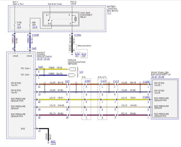

I think it will work if you unplug the CHCM, then flash ABS and AWD w/asbuilt for wildtrak. (then you gotta do the P160A relearn BS, but O well). You could then just wire the drive rod valve + and - to an aux switch for manual control
this will work!
