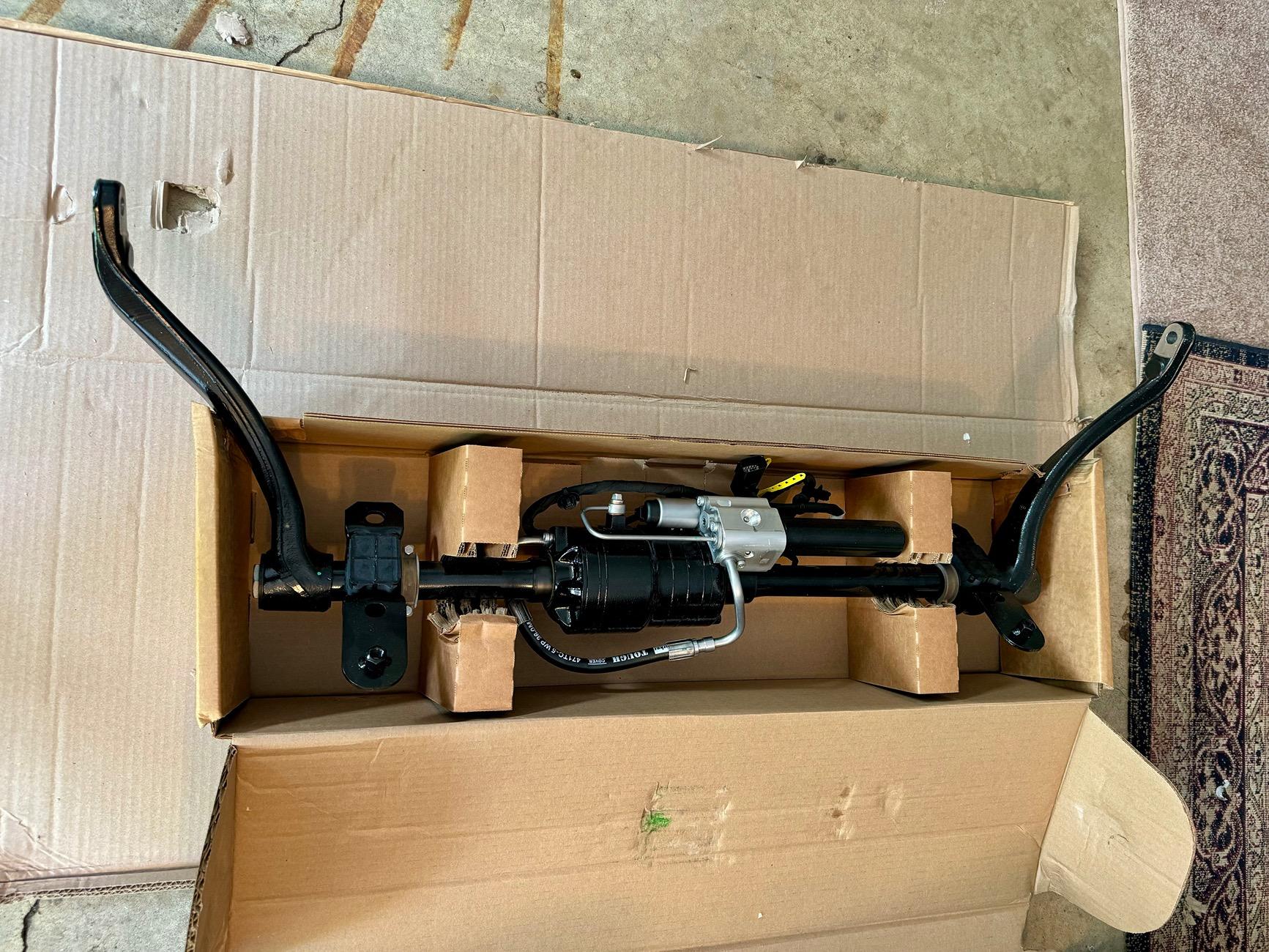

The OEM electronic sway bar disconnect is a one piece unit. See pic below.
yeah, and I’m probably going to get an e-disconnect, but the stock manual sway bar is a single piece. I don’t see the need for a manual disconnect to be attached as a set on each side
