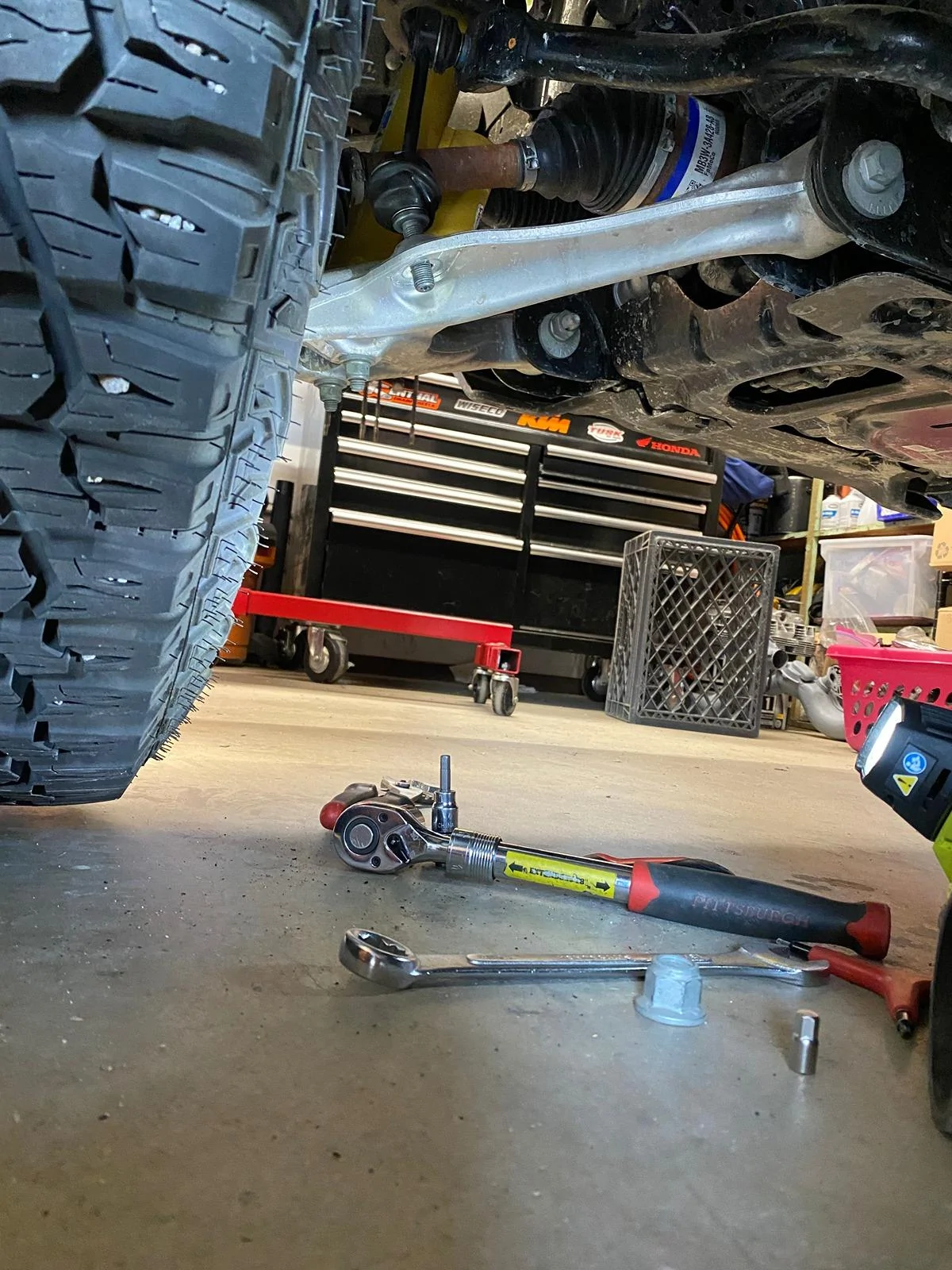

Nope, just take the bottom of the link off and zip tie the link to the sway bar.
I tried that on one side and even jacked up the bronco to get maximum pull on the link and only got it to move up about an inch. Is there a trick to this?
You have to take both sides loose at the same time. But put it back on the ground before you take the other side loose. Those are bonded rubber bushings where it pivots. It’s gonna snap up there if you take the other nut off now while it’s in air.
Yup. Both nuts off - then it will pop up. When you put it back, get both bolts back in before you put a nut back on. Don’t need to jack it up or anything
Take note It has an Allen key in the center of the bolt to keep from destroying to boot. First few times I pulled mine I didn’t even notice and the bolt never spun, then the last time I nearly wrecked the thing.
