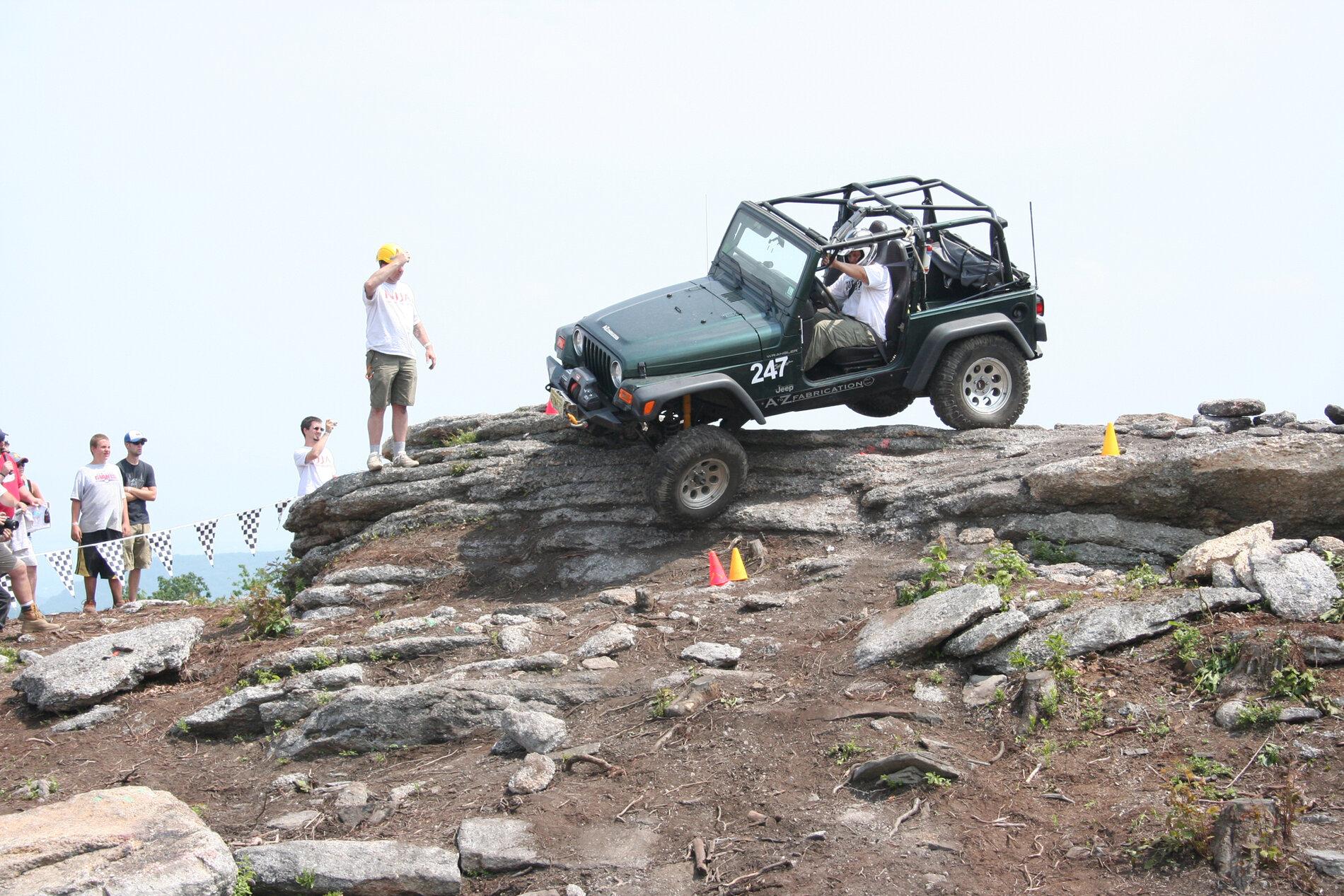

There are cases where it's really helpful to limit tipping as much as possible. Here's an example:
Ford Bronco Sway Bar Disconnect Functionality MotorHomeDamage20080614_09_42_13
The driver front tire is providing some resistance to tipping. Not much, but enough to keep one's shorts clean :).
