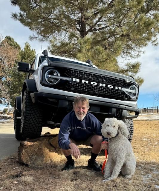

I installed Private Label Manufacturing sway bar disconnects yesterday, on a new 23 2 dr Wildtrak. Would have loved the factory disconnect as it is hydraulic and can actuate under force and reconnect at speed.
My previous ORV was a 05 LJ Rubicon, and the manual disconnect definitely helped with Moab rock crawling. With it disconnected I did not like it on the highway. Though, I did not like the LJ above 55 mph anyway.
Now for the Bronco: I tested it on my landscape rock with and without sway bar connected. Connected it slightly lifted the rear tire off the ground--tippy when I got out. Disconnected it was solid.
The jury is out on the PLM disconnect, but initial quality seems decent, a 10-mile highway drive was not different than factory links. I do not like the way the PLM stows, will be making something to swing up and secure to the sway bar when disconnected.
Colorado Bronco Upfitters is developing a retrofit with factory like programming, certainly a LOT more than the $300 PLM disconnects, but on my wish list.
Ford Bronco Sway Bar Disconnect Functionality Bronco rock with koobs
