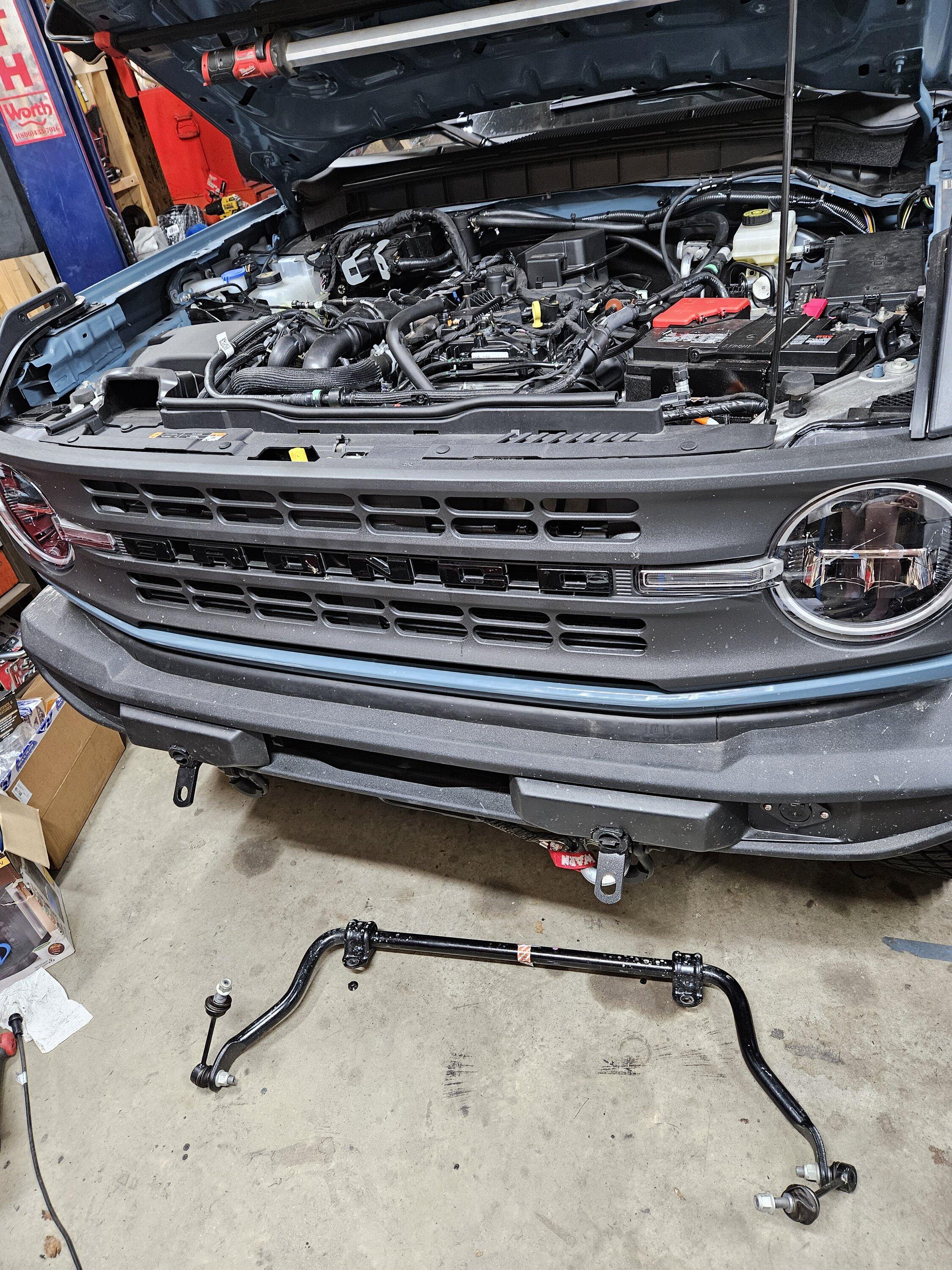

So I was able to play around in the garage a little & here are my findings:
When you unplug it the only code / warning lights that come on is a message to service Sta-bar. You click the OK button it appears to be good. No DTC codes what so ever. Awesome!!!! Right ???
Not so fast my friends. A quick turn of the mode dial & no drive modes are available. Meh.
Shifts to 4L ( Forgot to try 4H & 4A) F& R Lockers Engauge, Trail turn assist lights up like it's going to work. Traction control pops up . Notification pops = Advance trac disabled ( Not sure if this is fully disabled, but I tried the hold the button to fully deactivate as shown by Loren & Vaughn but have never seen it work on my truck 🤷‍♂️ Anyway looks like the only real side effects are having to acknowledge the service light & the loss of any & all GOAT modes.
Can I live with that :unsure: Maybe if it came down to paying for a replacement & I prove the other functions in the field, but not right now.
So the challenge still stands 🤠

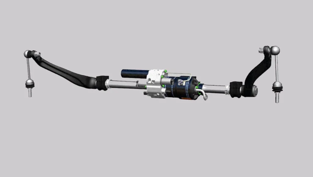

Here is a challenge for all you Programming Gurus:
Find how one can delete the automatic sway-bar without causing any trouble lights or other electronic adverse affects other than the difference in handling.
I'm getting tired of mucking with this thing every time I work on my axles. It would also be nice to have the ride smoothed out in 2H & 4H & not always having to be in 4L to disconnect. I also want to be ready for when this boat anchor dies as it is not light.
I've driven a decade plus with no sway-bars on my XJ as I got tired of disconnecting them all the time. I have no problem taking responsibility for my driving.
Can this be done...I hope so 🤠
