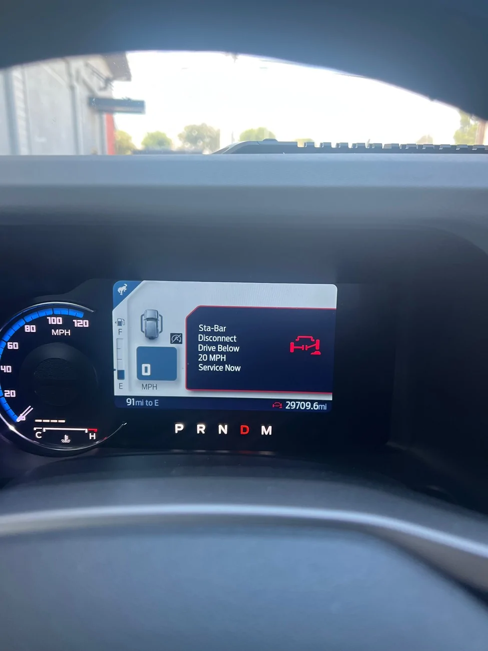

The system is all connected to the computer. Since the Sway bar is disconnected permanently i get an alarm on the system that says service now and handicapps the entire car in safe mode.

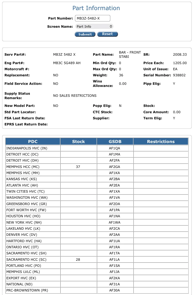

So I have a 2022 Badlands with the automatic swaybar disconnect, it had an error around middle of June leading to it needing to be replaced. The shop has been all shoulder shrugs on when this thing will be delivered and replaced. In the meantime time I can't really use my Bronco more than just getting around town. This has really put a damper on the summer and a few trips I had planned.
Any idea on when these part come in or is luck of the draw?
There’s currently 65 available in the country. No reason they shouldn’t already have one.
In the meantime, If you have a cable and Forscan lite on your phone, and you clear the DTCs on your CHCM module and get rid of the message getting full function back until the next time the swaybar event happens, At least on mine I get that error every once in a while for "Low Pressure" and reset it..

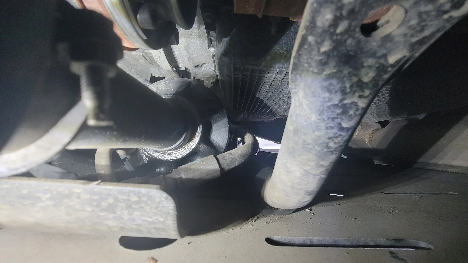

How bad was the leak? I have a seep on mine, looks like.
I wish I had pics, but the dealer took care of it all. Does yours have the error message on the dash? Mine was bad enough that I had this:
