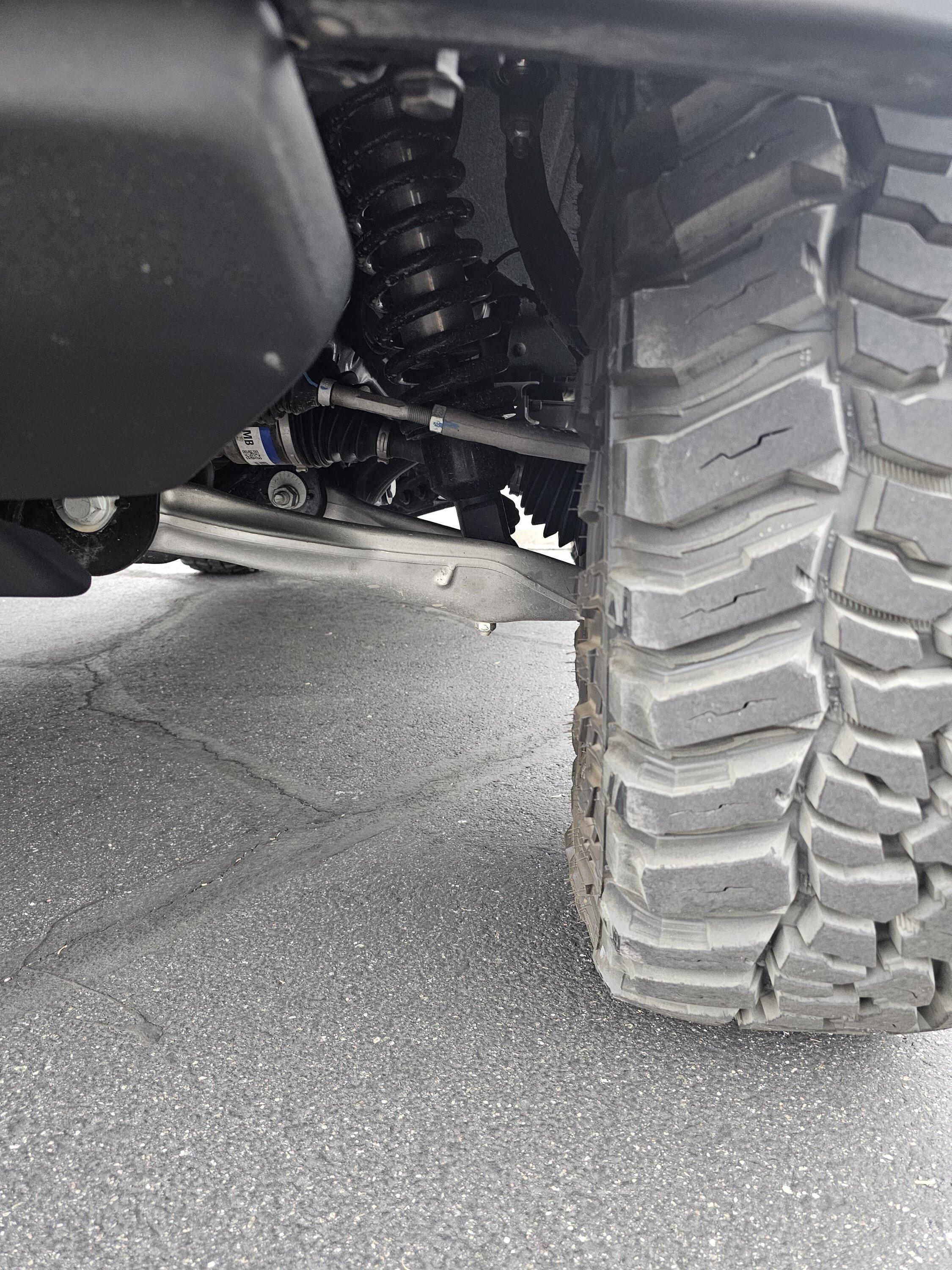

I should have taken a picture before the lift, however, I think the angle is pretty close to stock if I remember correctly.
I am probably not wheeling as much as i did years ago when I had my Jeep JK and XJ, certainly not going to be doing the trails I did in my highly modified XJ. I traded a 2023 Rubicon for the Bronco for many reasons, one being comfort - and doing more moderate trails now.
Problem is that one rock, you know that one you don't see. The stock bushing just can't handle the stress and deforms. Now you are just slowly doing more damage over time. This was one of the local broncos that I helped install some Rough Country bushings in. He was definitely on borrowed time! Steering issues are usually related to lift and tires but bronco are susceptible from birth.
