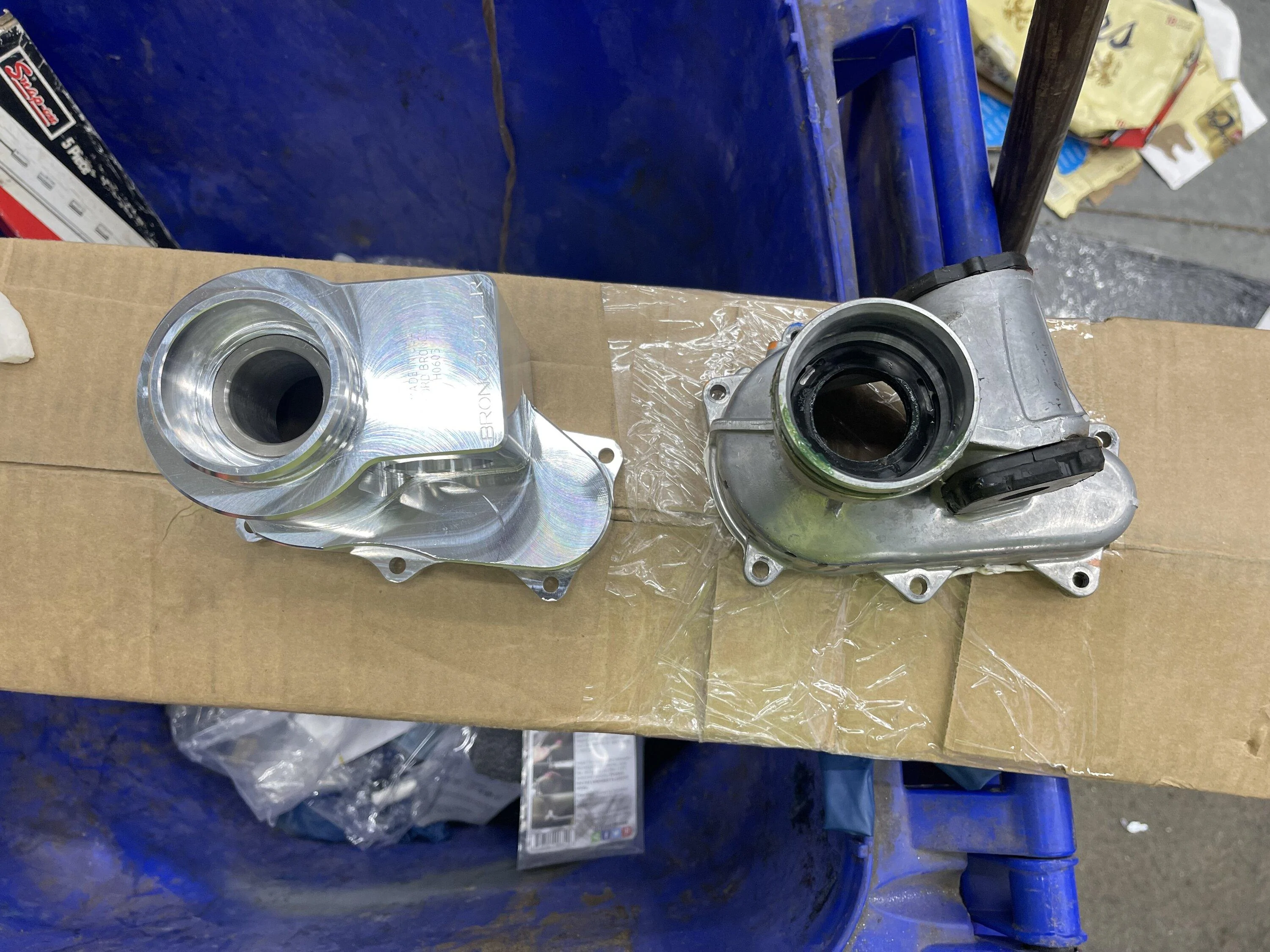

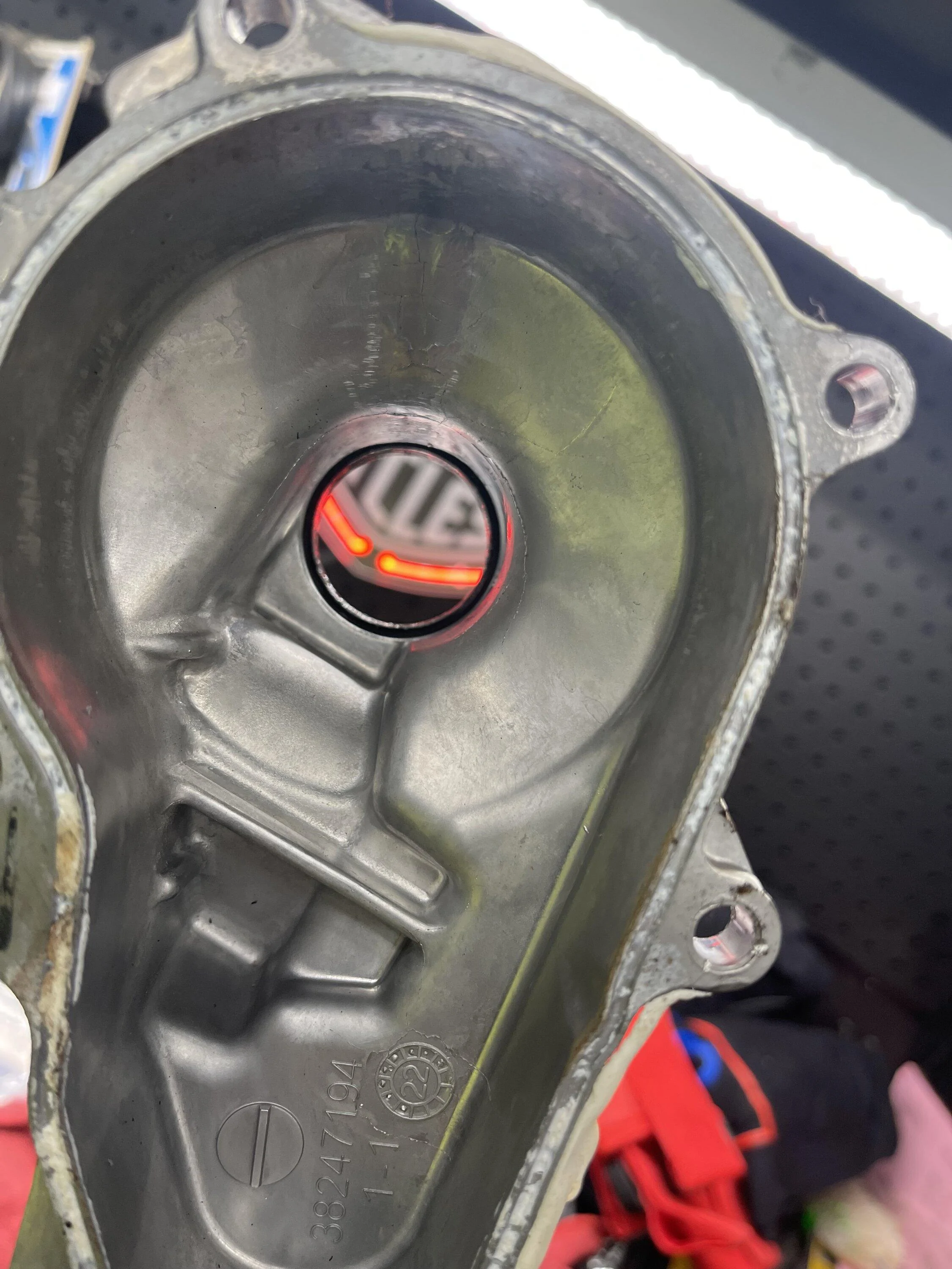

Did the BB kit all 3 at 700 miles. The stock 2.0 had signs of wear on the PS seal here is mine look at the seam in the pot metal then zoom in on the seal to see the deformation this is with 37’s for 651 miles 35’s49 miles imho the stock rack needs the BB or any variation of a new end cap as all of the tie rod force is transmitted upwards into the housing
Looking at the weld74 stg 1 kit for a friend the only thing I don’t like is the snap ring to hold the bushing in. I like the press in bushing of the BB referencing the pass side cap

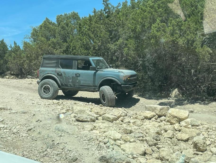

What happened to bronco busters?
Someone else reached out to me about this too. Rumor was someone stumbled upon them out broken with a possible knuckle or something. Trouble is, nobody has verified the source of this photo and per Broncbuster IG posts, people have been sharing videos of him driving in town on this very bronco dated 8/7/23…
I also don’t like rumors so I contacted BB directly and asked what was up with this photo. He had no idea where this photo came from and assured me this Bronco was not broken nor had broken. He went as far as to walk out to his driveway, shoot video of the bronco and send it to me. Nothing appeared broken y’all.
So this photo may either be some trickery of a computer or camera angle but I have verified that he did not experience a breakage.
I can confirm that nothing is broken.

The photo is from Hidden Falls adventure park from I believe 8/5. No trickery, but possibly just the angle of the photo and showing the ackermann steering. It does show the EXTREMER scrub radius at a minimum though, which is interesting.
In my personal opinion it looks like the wheels are pointed different directions, but I cannot confirm that.
