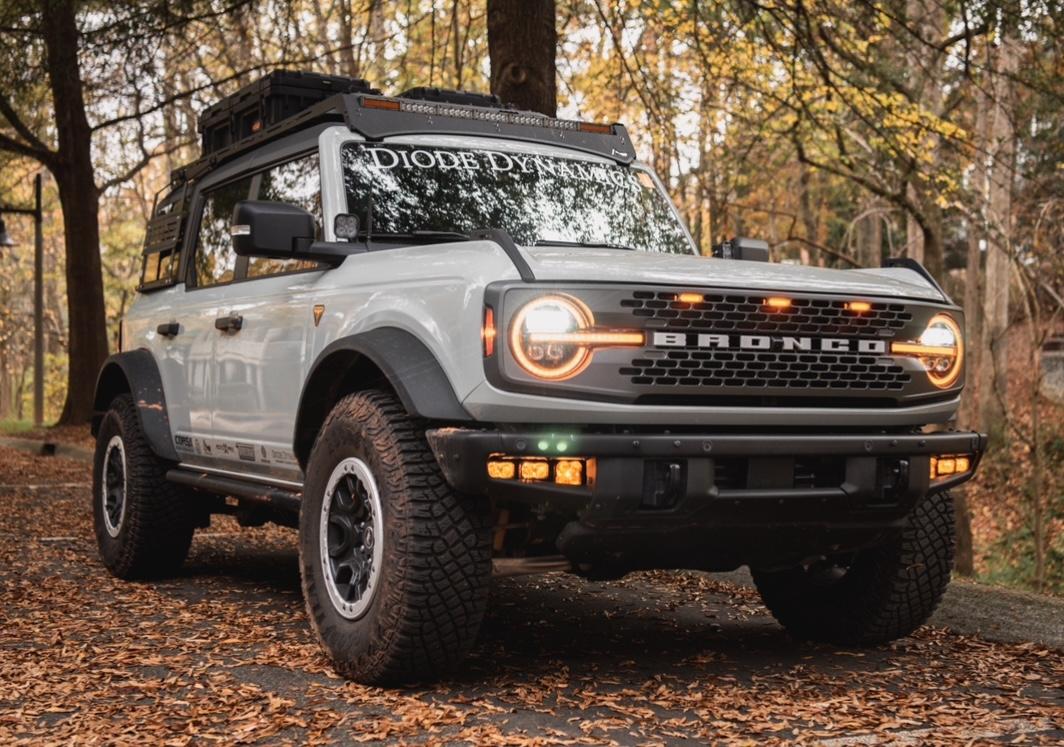

I treated myself and the Bronco this Christmas to a 4” coilover lift, upper control arms and an adjustable rear track bar, and have plans for 37s next. My question is what other upgrades should I consider doing when the lift gets installed? Tie rods are an obvious upgrade that’s needed, especially with a lift and bigger tires - any real defining pros and cons to the sleeves vs a beefier tie rod kit? I’d rather replace tie rods than a steering rack but I’m curious to hear some of y’all’s experiences with different options, different brands, etc. Any other components I should look at upgrading at the same time?
I’ve done a good bit of reading and research on my own but am hoping to hear more personal experiences
pic for attention :)
- Weld 74 makes a stage 1 for around $1K https://motorsports.74weld.com/bronco-stage-1/
- Diff drop
- KO2 37's
- Tie rods of your choice
BTW, your rig looks great. Looks clean with headlights.
- Diff drop
- KO2 37's
I considered 74Weld's Stage 1 but it says it's best for "light" off-roading, and the Stage 2 is best for those running 37s. So my question then - is it a waste of money going Stage 1 and not Stage 2 if I know I'll be on 37s? Or will Stage 1 be just enough support that I'll still be fine with that and the upgraded tie rods? I guess that's a question for 74W.
Truthfully I may just run OEM tie rods for a bit, carry an extra set with me, and realistically see how often/easy they break before pulling the trigger on something
(BTW, thank you!! I love the new headlights)
