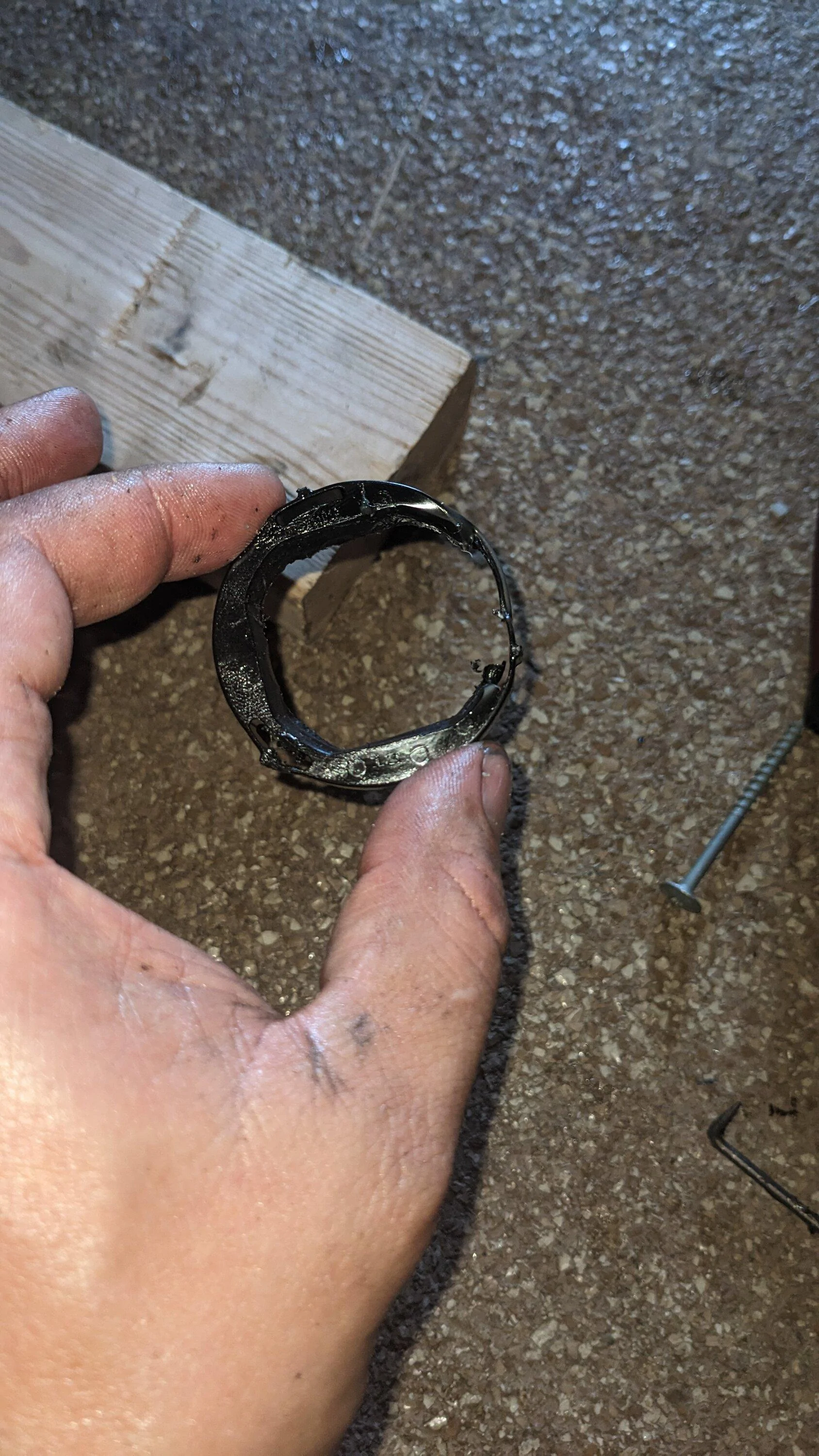

Everyone keeps refering to the factory rings as bushing when they really aren't. If you have taken one out you will quickly know this was in no way designed to be a bushing.
It is a cheap piece of hollow plastic that uses spring like plastic clips to hold it in (there is a huge gap around the whole thing).
I mean, this is neither here nor there when it comes to this discussion about replacements but there is no way those factory black rings were ever intended to absorb any sort of shock or anything.
They basically remind me of some sort of guide, almost like packing material that just kept parts from banging together as it was being assembled.
I remember someone at one point who was in the industry stating they were only in the rack because they aided in assembly. Makes sense.
This is why I really like the RC bushing, people are directly exposed to the actual problem. Once you physically look, see and touch something you become a much more informed consumer. The whole reason I run a aftermarket bushing in my driver's side is I wanted to see what the HOSS 3.0 bushing looks like.

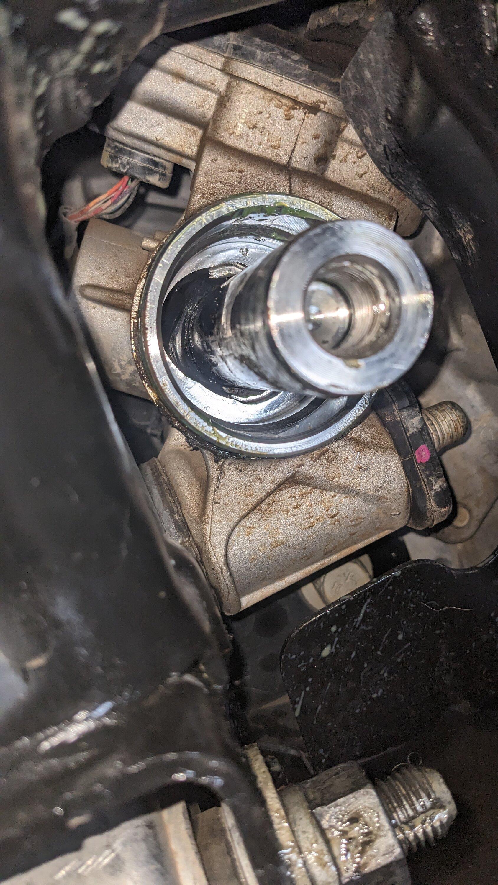

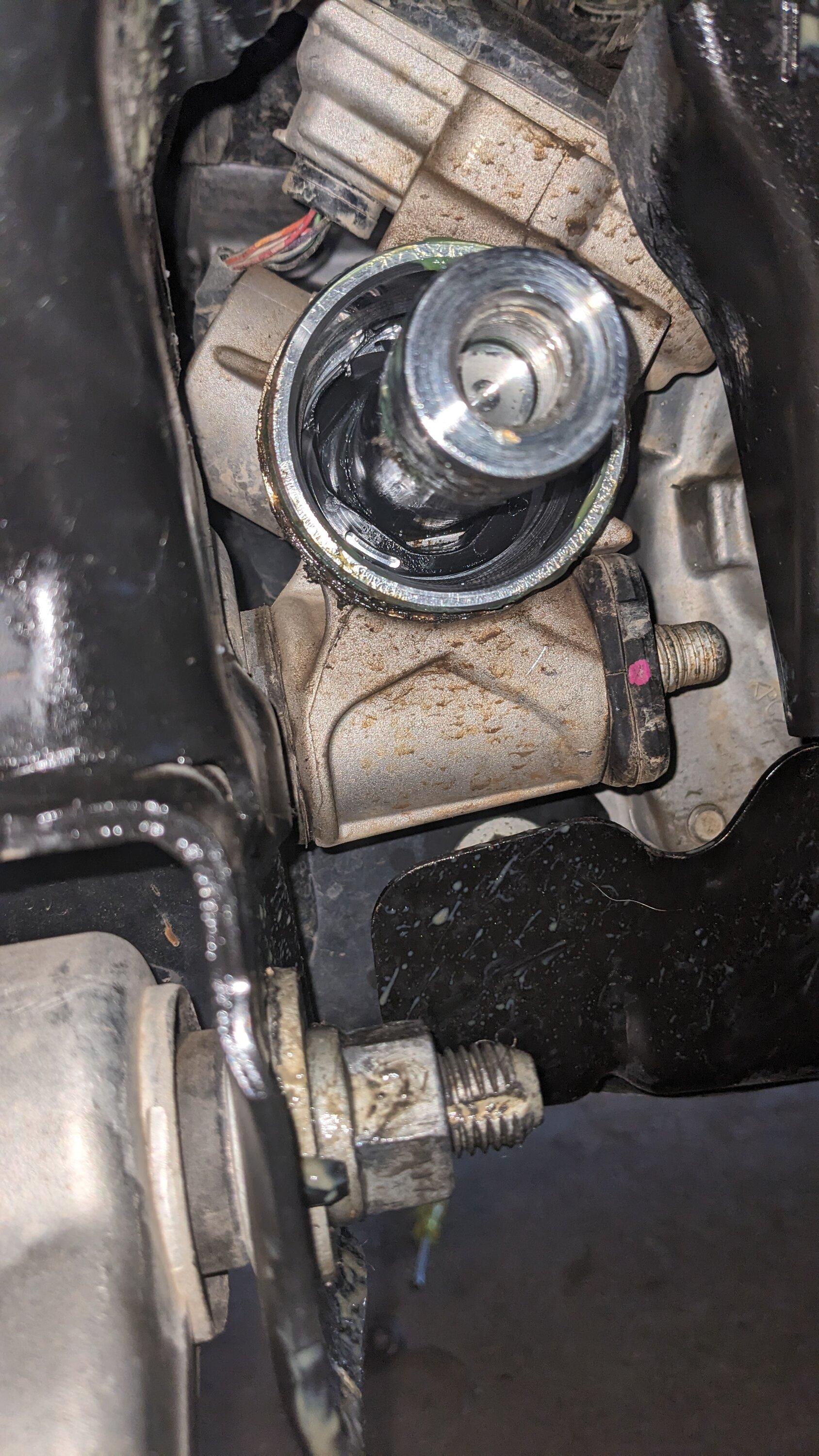

Problem is that one rock, you know that one you don't see. The stock bushing just can't handle the stress and deforms. Now you are just slowly doing more damage over time. This was one of the local broncos that I helped install some Rough Country bushings in. He was definitely on borrowed time! Steering issues are usually related to lift and tires but bronco are susceptible from birth.
These pics are helpful. I have a more clear understanding of the bushing's purpose to support the steering shaft/screw (not sure of the correct name for it) that connects to the tie rods and the pinion gear from the steering wheel.
