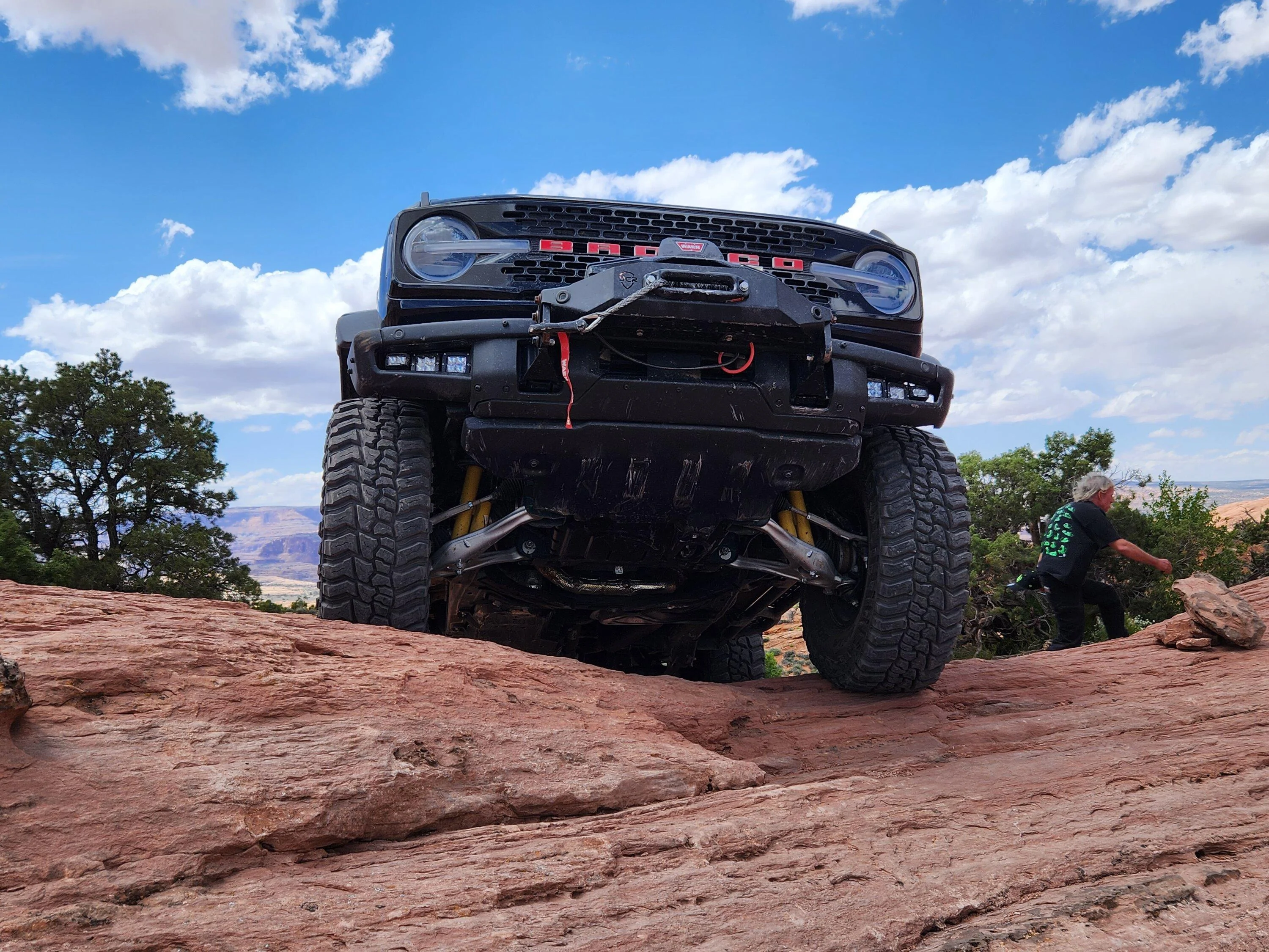

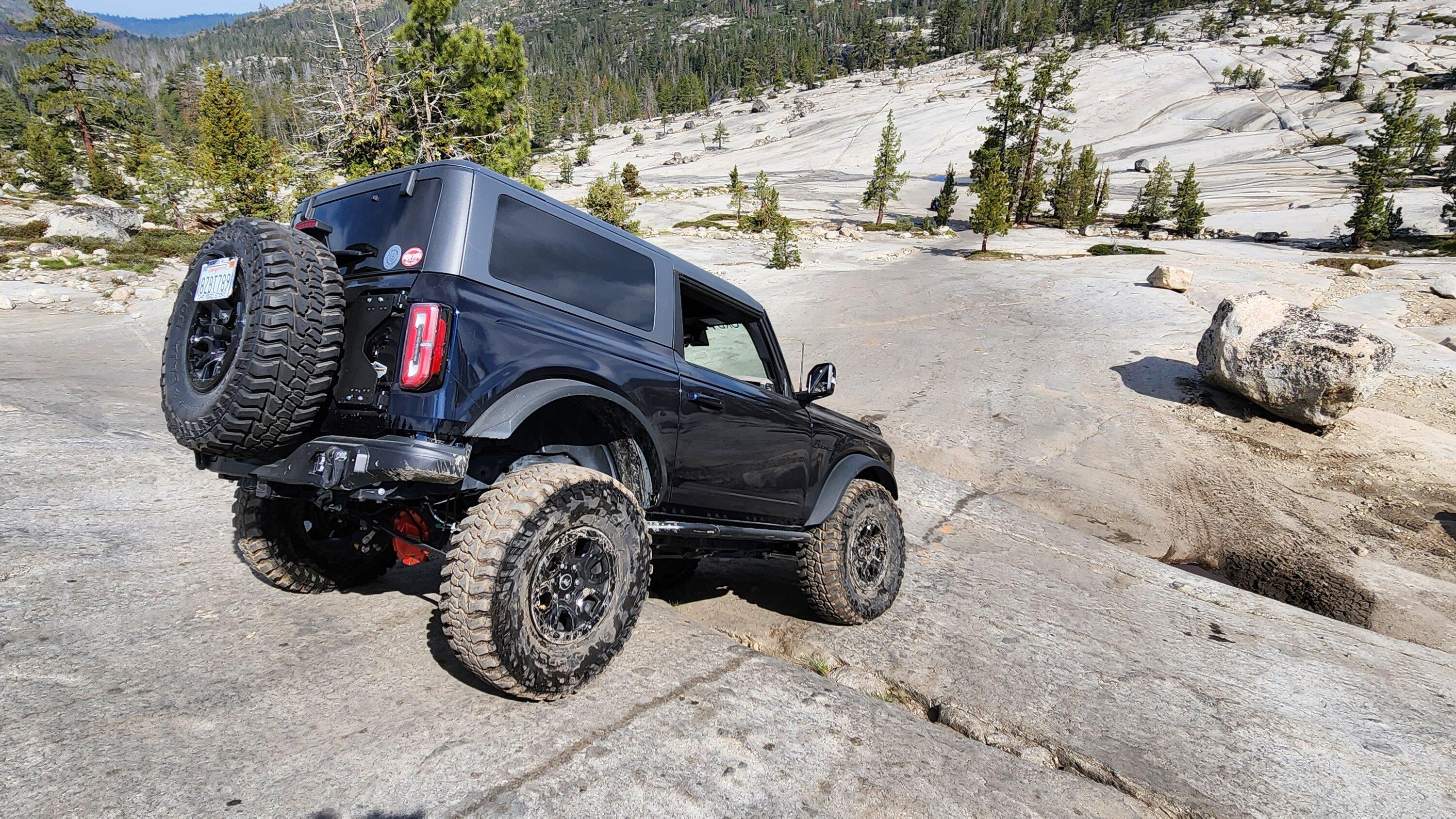

I am not following why RC's bushing cant be a part of this discussion. While I agree that RC has questionable suspension products, a bushing is a bushing. Paying 10 times the cost for a name is not something I fancy.
This is the thread for the RC bushing discussion.
Steering rack bushings cheap options and alternatives. Reviews pending!
https://www.roughcountry.com/bronco...hn1wL27airmmDwNiAGxNtP911axD2jWRZbZSg2jEmoAcU
Broncobuster $349.00
RC 49.99
RC, a lot of us run them and run them hard Moab the Rubicon.
But need to decide for yourself.
Ford Bronco Oh Snap! A Steering Upgrade Options & Considerations Write-Up 20230504_125555
Ford Bronco Oh Snap! A Steering Upgrade Options & Considerations Write-Up 20230624_095423
