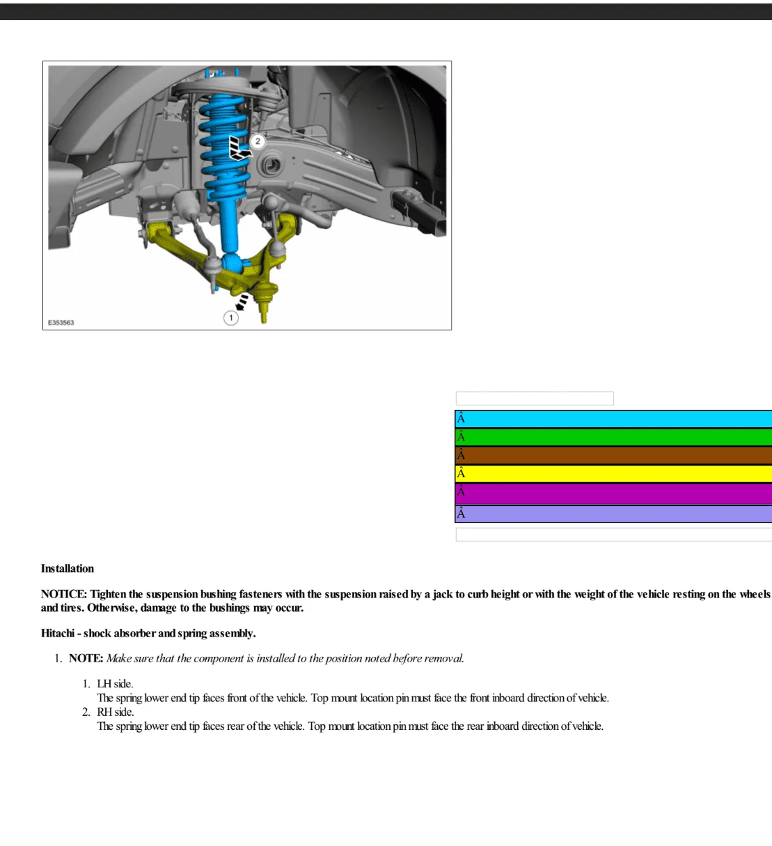

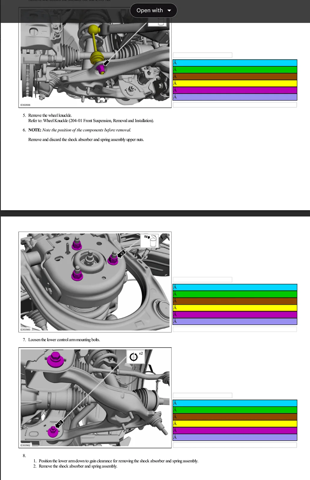

There are two methods of removing and installing shocks on these.
Method A. Remove tie rod from knuckle, remove sway bar end link from knuckle, remove upper control arm from knuckle, Remove axle nut, push out the CV stubs, then the top nuts of the strut, and then pressure down on the lower control arm to wrestle the strut out.
You absolutely have to remove the CV axle nut and put it out of the hub to prevent damage to the CV if you do method A.
Method B. Remove the lower control arm to the frame.
I prefer to do A, since it doesn't completely jack up the alignment.
Sounds like your guy just brute forced it, which DOES NOT WORK. I bet you have a separated CV joint.

That is wild.
It does not jack up the alignment too bad, just mark a line on the cams that goes onto the crossmember. Then when reinstalling line up the marks and you should be close enough to drive to the alignment shop.
Agree the "brute force" method does not work as it pulls the CV apart, I've seen others do it.
