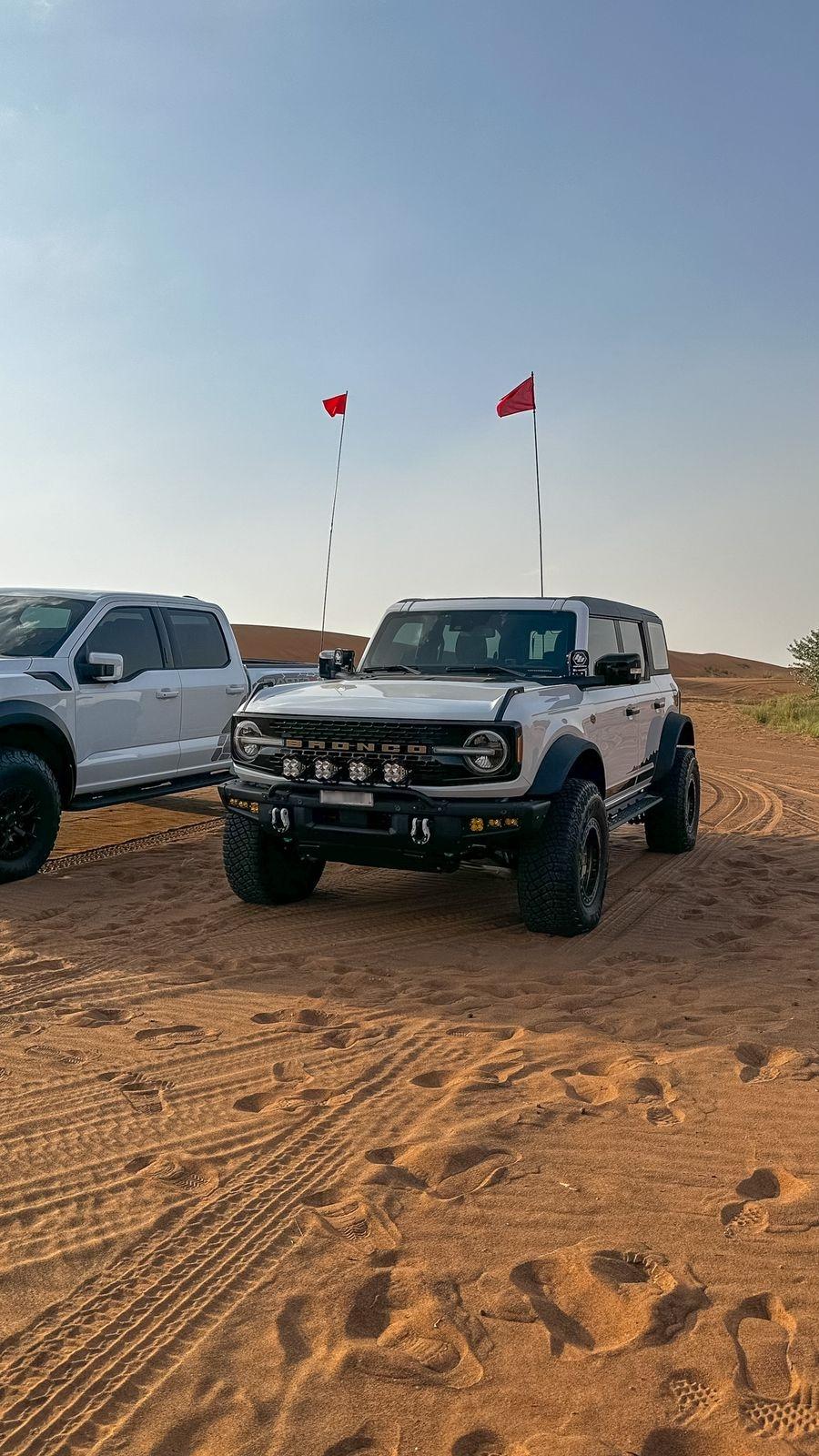

So I have the same issue as OP. Just wanted to say that after I changed tires, the pull to the left side has significantly decreased, but it is still there slightly.
Also it only happens in the beginning when you floor it in 4A.. as I continue with WOT and center steering slightly it stays straight. It's as if the back squat and front lifting moves steering to the left.. I have a theory that maybe my sway bar is bent or something. As someone suggested earlier, will try to remove the sway bar links and try to see if it makes any difference.
I will also try with traction disabled, I have the ABS kill switch so will just disable all of that and give it a shot later today.
Anyway, I've gotten used to it and it doesn't bother me so much anymore, makes absolutely no difference off-road either and I've been running the car pretty hard in the desert for the past year or so.. I too have a custom tuned kings setup with the full RPG arms package.. very happy with the performance so far :) the car eats the competition offroad so far so I'm happy haha
