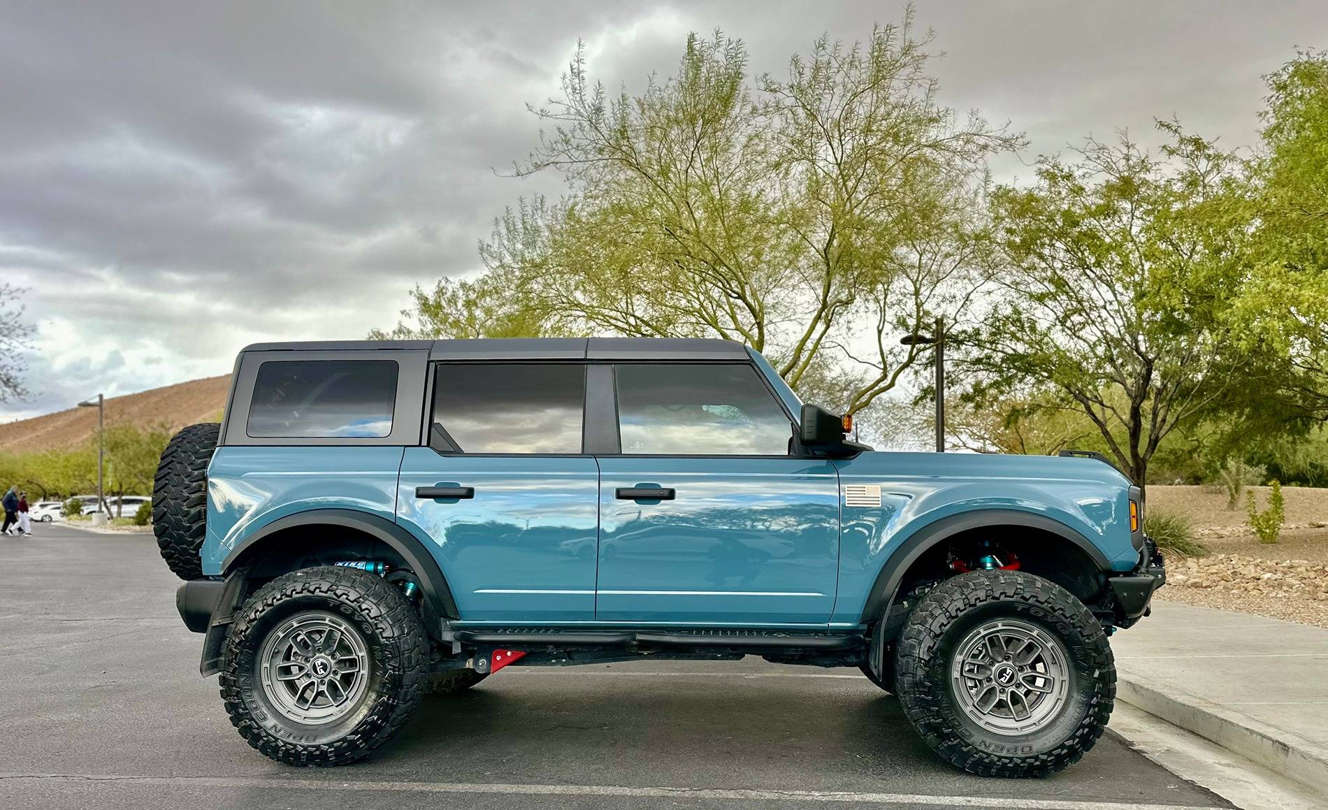

So, got an "offer I couldn't refuse" from a friend and got these 2nd hand.....Coming from The Sasquatch w/ Eibach Pro Lift Kit setup for almost 2 years. The KINGs are really amazing shocks. And If I had to do this all over again - I still would have gone the Eibach Spring route. That setup is just SO GOOD for $450. It's such a great upgrade and has performed so well for me. I'm still tweaking my KINGs of course and fiddling with tire pressure and adjuster "clicks." Also finalizing ride height next week. Thus far I am happy with 34psi cold on my Toyo Open Country M/T 35s. 11 clicks Front and 9 clicks Rear (from full soft) - for the street. Unless I am on a much faster trail or have a full compliment of passengers, I will not be adjusting them for the regular trails I run and just lower my tire pressure. And wow.....they DO shine the faster you go!!! :thumbsup: :handsinair: :cool:
Good lookin' ride!

Hey all :) Figured I would give you an updated pic after we raised her approx. 1/2 inch. At first I thought maybe a tad high but I love how she sits now :cool: (still on my 35s). I have the settings finalized and she rides so perfect, not only on dirt but also on the street :thumbsup:
Ford Bronco Finally :) - KINGs IMG_8612
