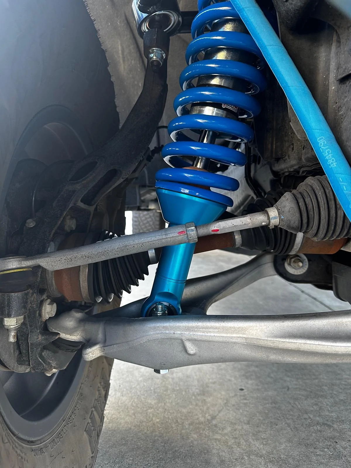

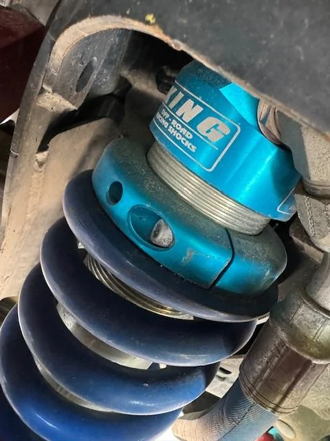

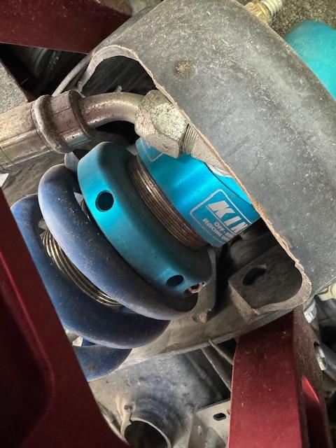

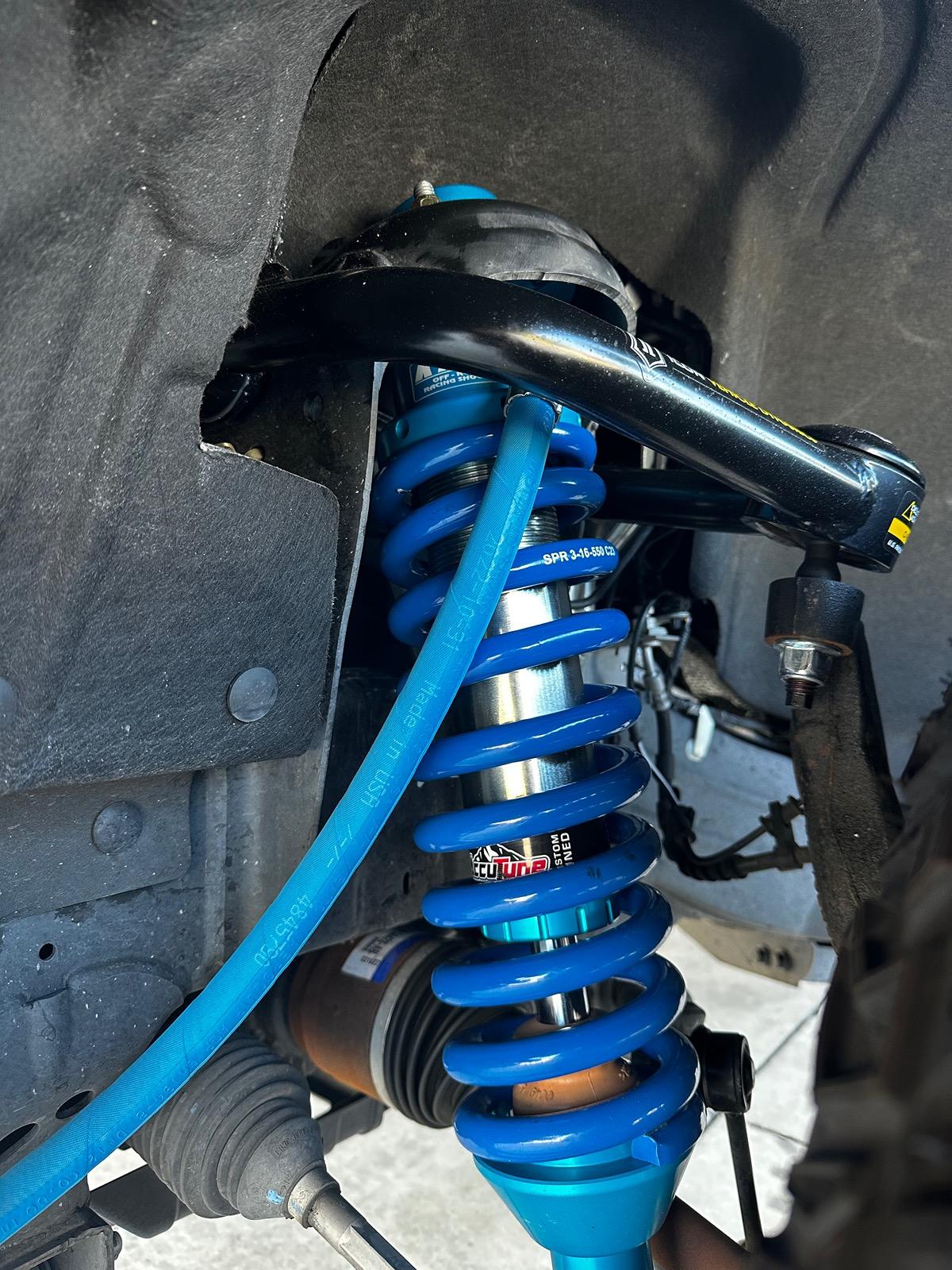

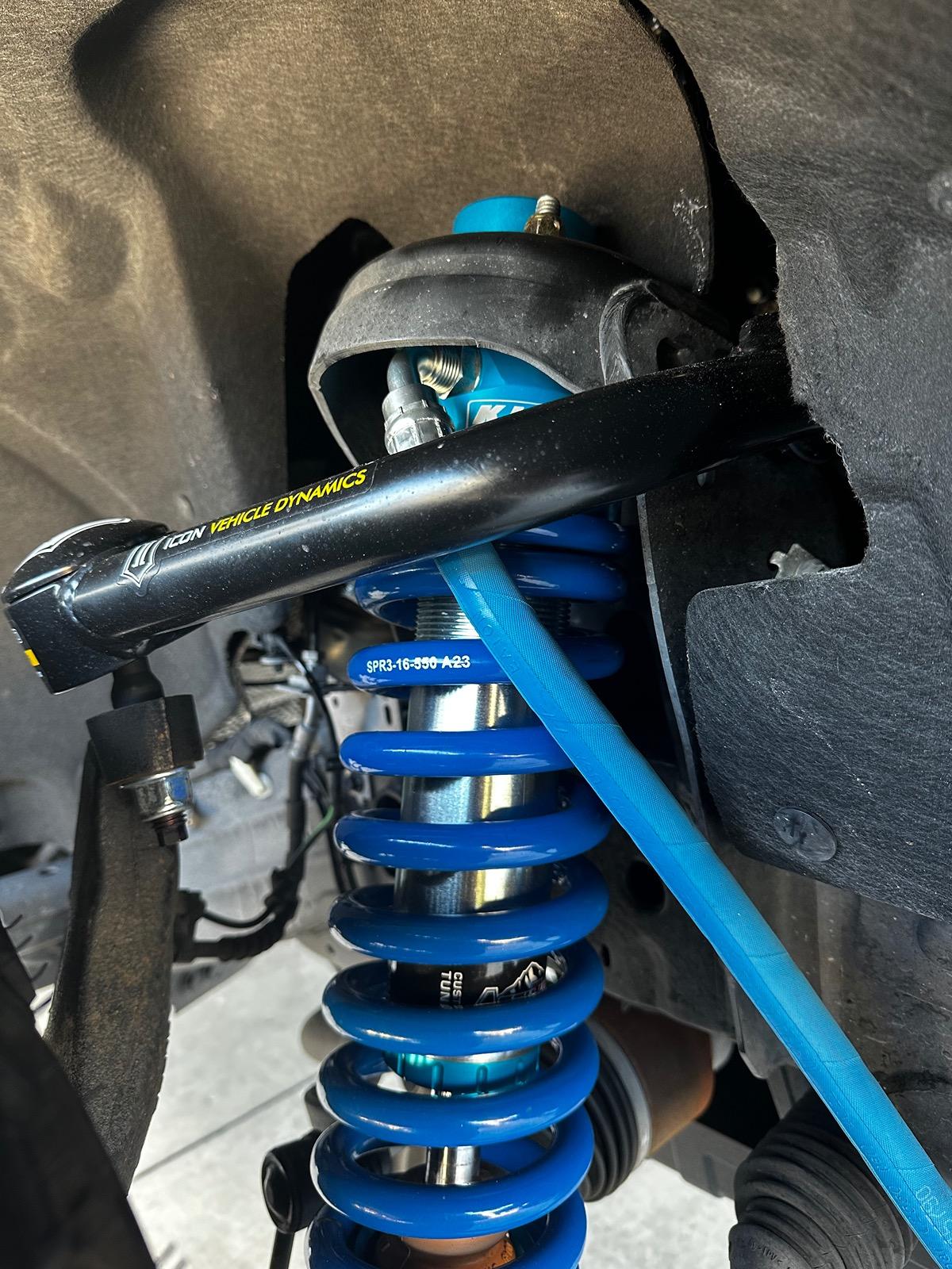

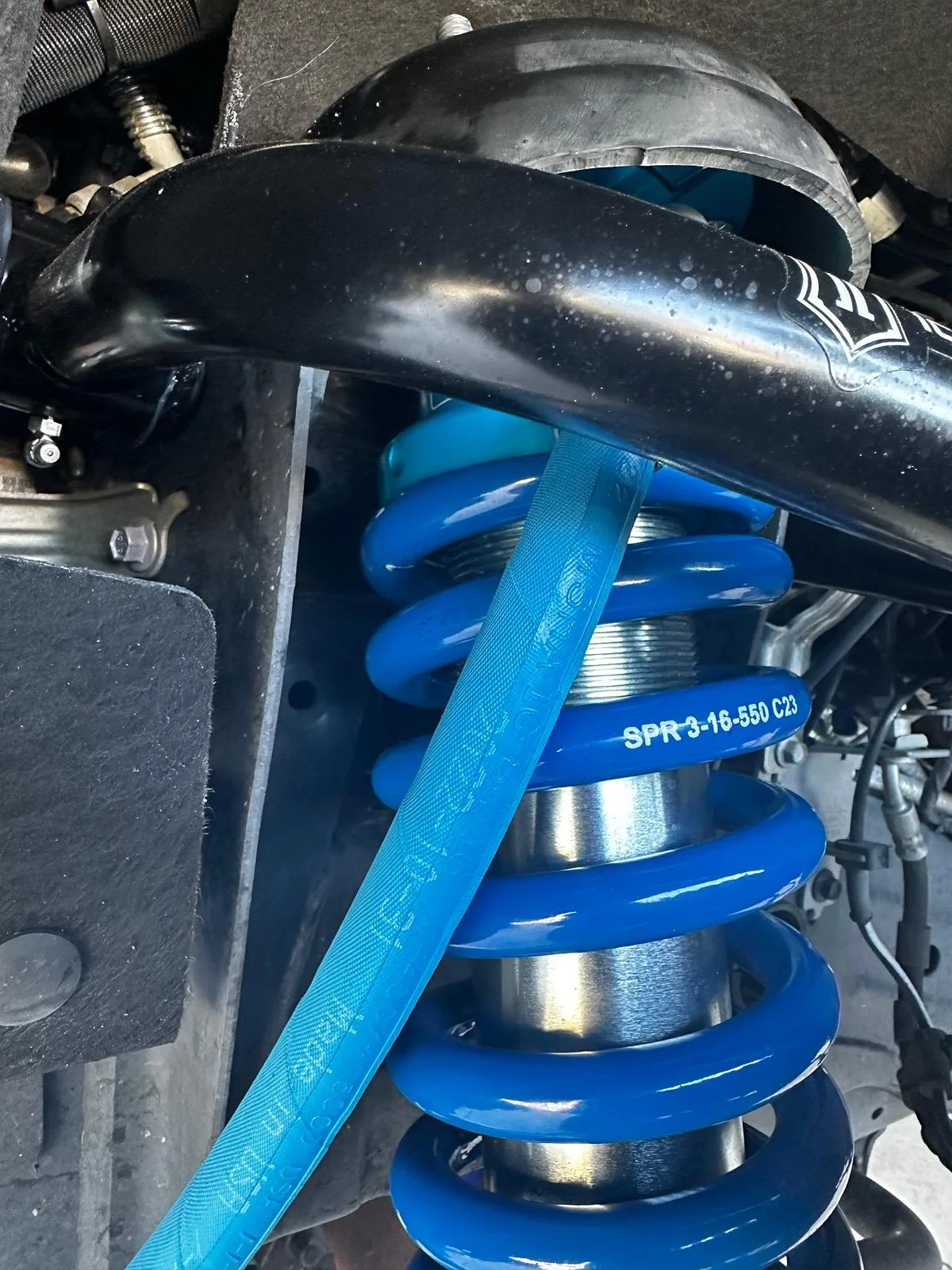

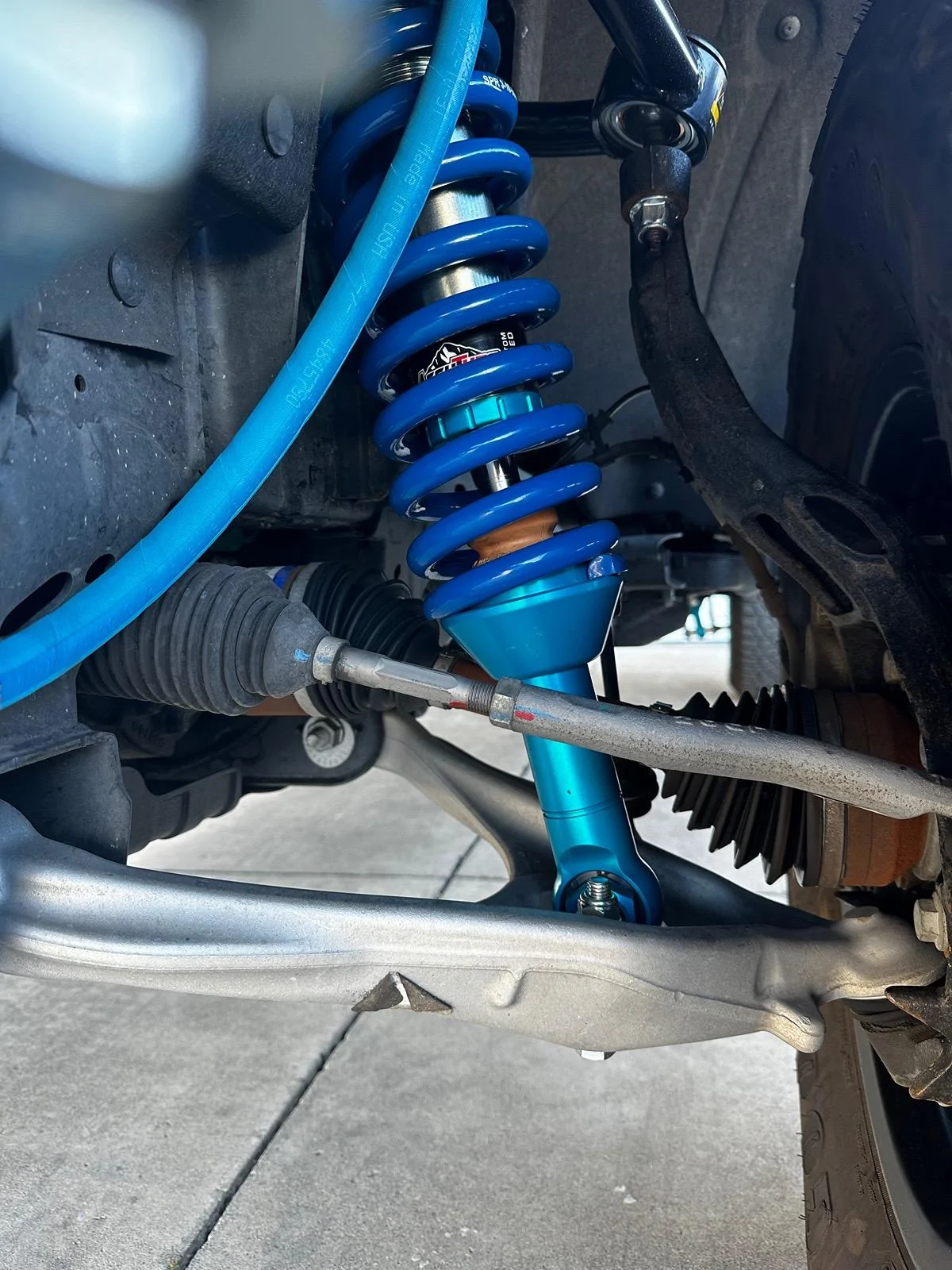

Update:
I checked the clickers and the front right was almost all the way firm and the front left was all the way soft. I haven’t driven it yet but I set them both to all the way soft.
here’d some pictures in regards to the other issues you suggested.
I can’t really tell from the pics, but it looks like the springs don’t have much preload at all. That could be because you don’t have as much weight on the front bumper as I do (mine has a winch) or because Accutune changed the valving in the shocks, so you’d have to ask them what they recommend.
Mine are the stock setup from King. I checked them a few minutes ago and I’m running 4-5 threads on the spring preload and 12 clicks on the clickers. @5GENIDN and @popo_patty may be able the chime in with their settings.
I’m not saying it’s NOT the CV, but I wouldn’t give up on the shocks just yet. If I found the clickers were set to full-stiff on one side and full-soft on the other, I’d be questioning whether the shocks were really adjusted for your truck setup when they were installed.

I have no threads showing since I don’t have any weight up front just an svc Baja bumper.
I put them full soft on both sides and have since changed them to 5 clicks from counter clock wise.
No pre load on either side. They have the cv saver from accutune and were built by them for my bronco, are you saying the installer installed them incorrectly?
I wouldn’t go so far as to say they installed them incorrectly, but I think it’s fair to say the shocks aren’t configured correctly for your truck (yet). It shouldn’t have rolled out of an expert shop with the clickers that far off.
Since Accutune built them for you, give them a shout tomorrow and talk to them about it. Explain the symptoms and get their feedback. If they have a relationship with the installing shop, I’m sure they’d be glad to have a conversation with them to help get you squared away.
