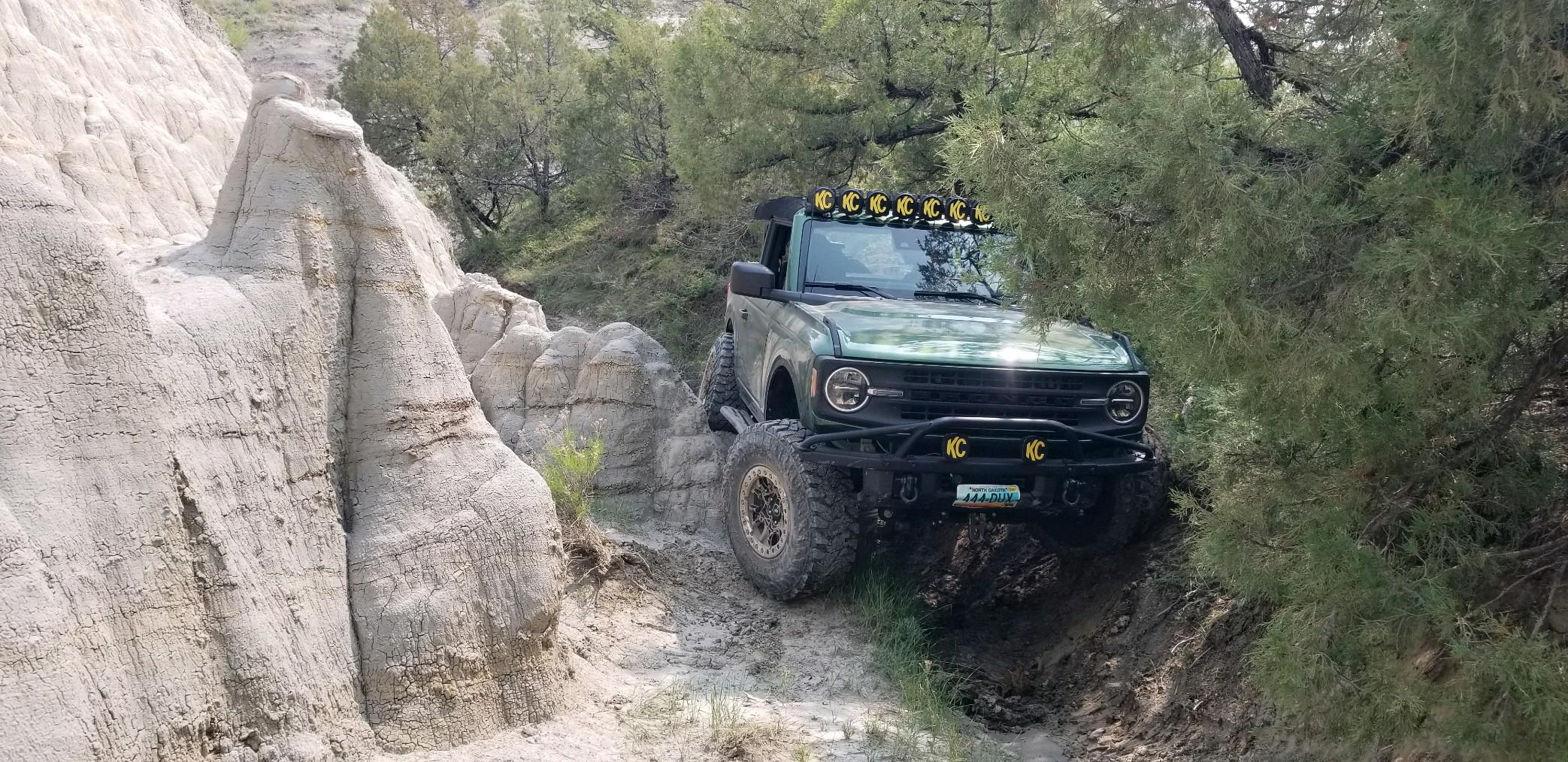

A beadlocked tire will not come off the wheel. You can rip the tire to shreds and the bead will still be locked into the wheel. You can also get into a situation where the wheel will spin and not the tire a beadlock will prevent this from happening. That is mainly the issue in drag racing but I have seen it happen in the mud as well.

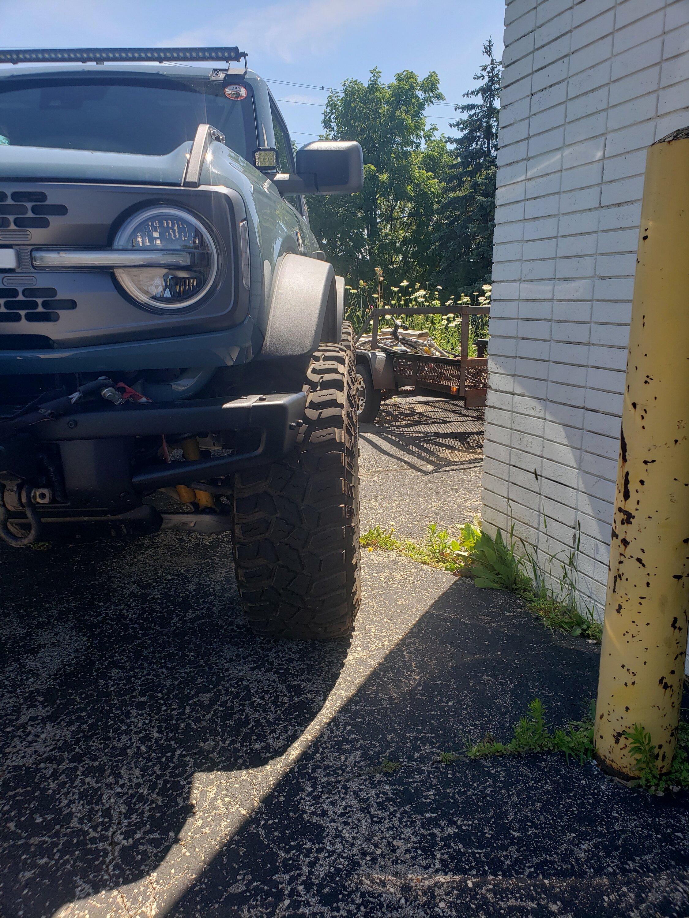

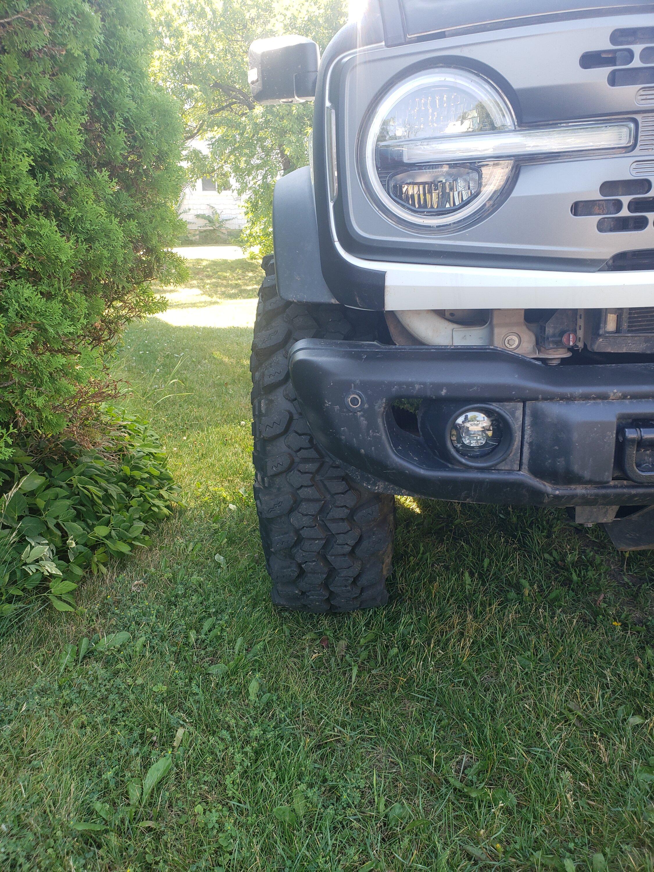

Badlands wheel is slightly narrower. I have both, and both have beadlocks and 1.5" spacers...note the tire on the BL is 37x12.0, the squatch has 37x12.5
