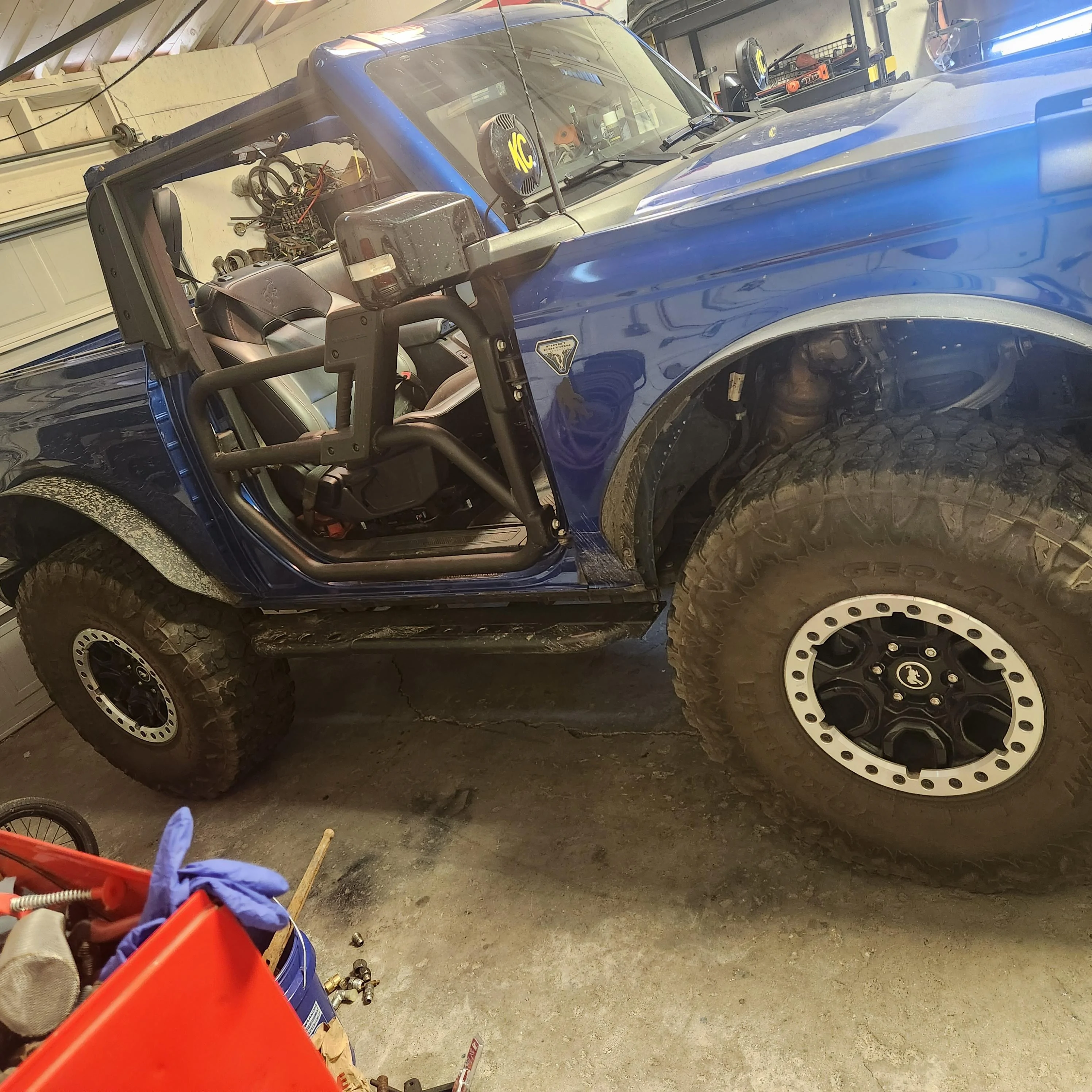

I have. I now own 3 sets. @BigMeatsBronco has them on his 40s too. I think its one of the coolest features of the 6g. I just found a set of squatch takeoffs, and ordered another set to go to 40s (some trails here have a tire size limit, so gotta keep my 37s mounted and ready!)

I air them down into the single digits for technical stuff, the problem isn't how low, its knowing if there are any high speed parts of the trail you are going to run. At higher speeds a tire that low will overheat and spall internally. As far as maintenance, I put them on just before labor day weekend 2022, rechecked torque before leaving for Moab in April 2023, and some bolts I was able to get about a quarter turn...most were still torqued. I plan to retorque at each oil change going forward. I have had them for about 10k miles, and no leaks
