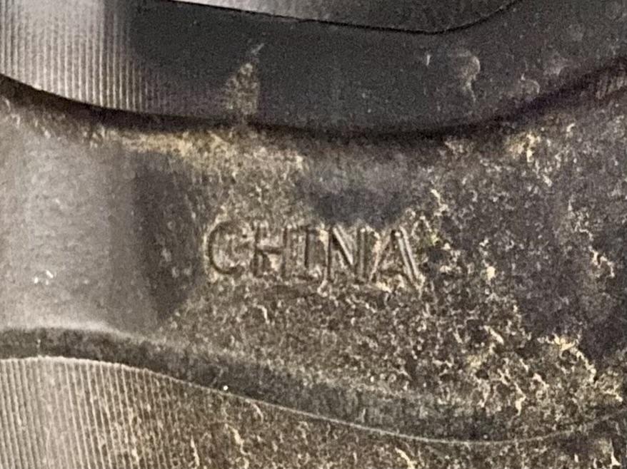

Dam it, made in China. 😂
As are the Sasquatch wheels they mate to…
Ford Bronco Ford Performance bead lock ring - Real World review? IMG_8426
They are still quality components, though. I have run my beadlocks both on and off-road 100% of the time for roughly 10,000 of my 13,000+ miles since installing them.
