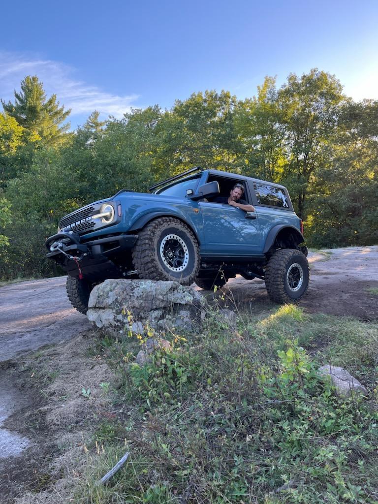

I have. I now own 3 sets. @BigMeatsBronco has them on his 40s too. I think its one of the coolest features of the 6g. I just found a set of squatch takeoffs, and ordered another set to go to 40s (some trails here have a tire size limit, so gotta keep my 37s mounted and ready!)
Do you have any more pictures of that khaki bronco in the back of that 2nd pic by any chance?
