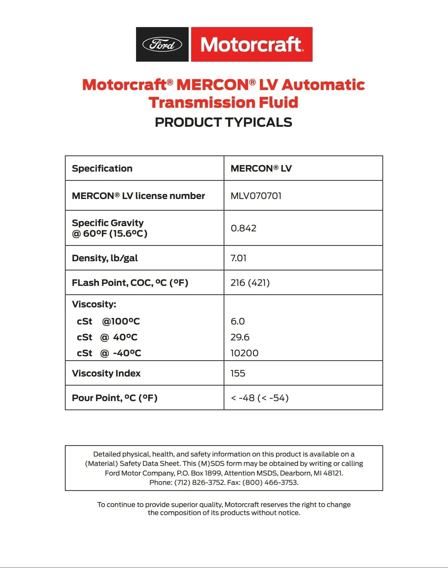

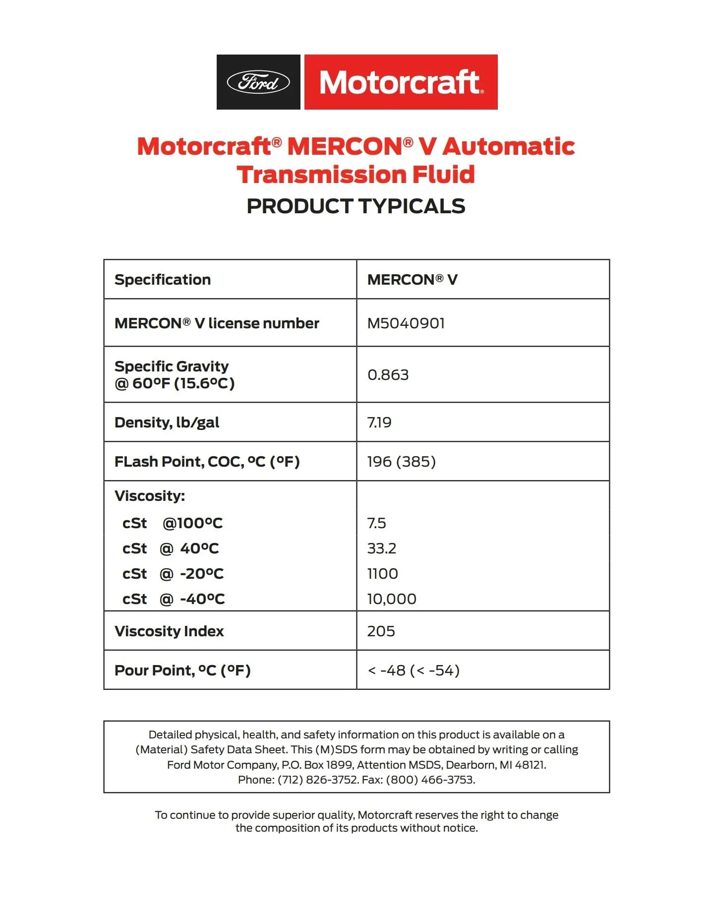

Curious as to why you went with Mercon V versus the specified Mercon LV. Also curious as to why you would use an unlicensed version of Mercon (even though it is not the correct type)?

Mercon LV is the correct fluid for the transfer case--not sure why the OP went with Mercon V. You can pick up 5 QTs for $39 on Amazon. I bought two because I plan to change it a few times before calling it good:

Mercon V is better if you live in cold climates. Had on hand. LV 5qt arrives tomorrow. Will switch out…
How does that work? Mercon V is thicker at every temperature.
