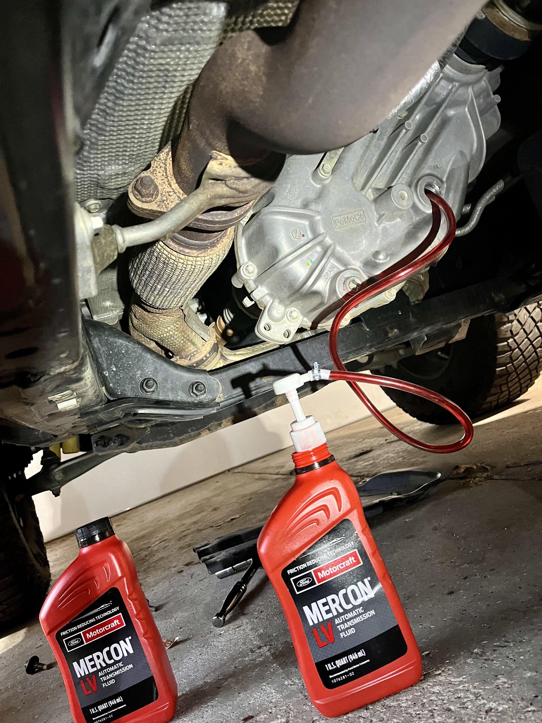

I drained and refilled front and rear diffs and transfer case last weekend. 15k mileage. Straightforward except thought I would add the following tips:
  1. Make sure you have a good fluid transfer system to fill. The fill holes on the Bronco aren't terribly hard to get to, but you will need some good flexible hose to avoid a huge mess.
  2. Carefully pull the brake line mounts off the bolt. I used panel clip pliers, which worked really well. Not something you want to break and I doubt local dealers stock this part.
  3. Follow the tightening sequence for the torqueing the rear differential bolts. Found here.
My front diff wasn't bad, but the rear diff fluid was chocolate in color. I'm glad I did the drain/refill and used better fluids. I plan to keep the cadence at 15k-20k since I drive off-road a decent amount and it is cheap/easy maintenance.
