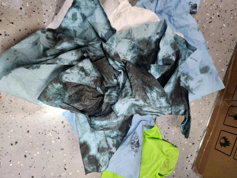

I did the full stack--front axle, transfer case, and rear axle. I have 2500 miles on my Wildtrak and learned from my Rubicon to do this early. Unlike my Rubicon there was no machining swarf on the axle magnets, so perhaps Dana has started doing a better job or Ford is holding them to a higher quality standard versus Jeep.
There was the usual metal "paste" on all magnets, though for only 2500 miles, it was fairly thick. All fluids were heavily filled with metal (as seen in the attached videos). The rear axle was comparable to the Jeep for metal content and you can see it in the draining oil on the face of the axle flange. Advantek axles historically produce more metal than similar counterparts and nothing seems to have changed from their introduction until now.
Also, all three were low--none of them were level with the bottom of the fill plug as stated in the service manual--another great reason to change it early!
I will start a build thread soon and will add a sheet with the UOAs that I will do over time. Here are some photos. Enjoy!

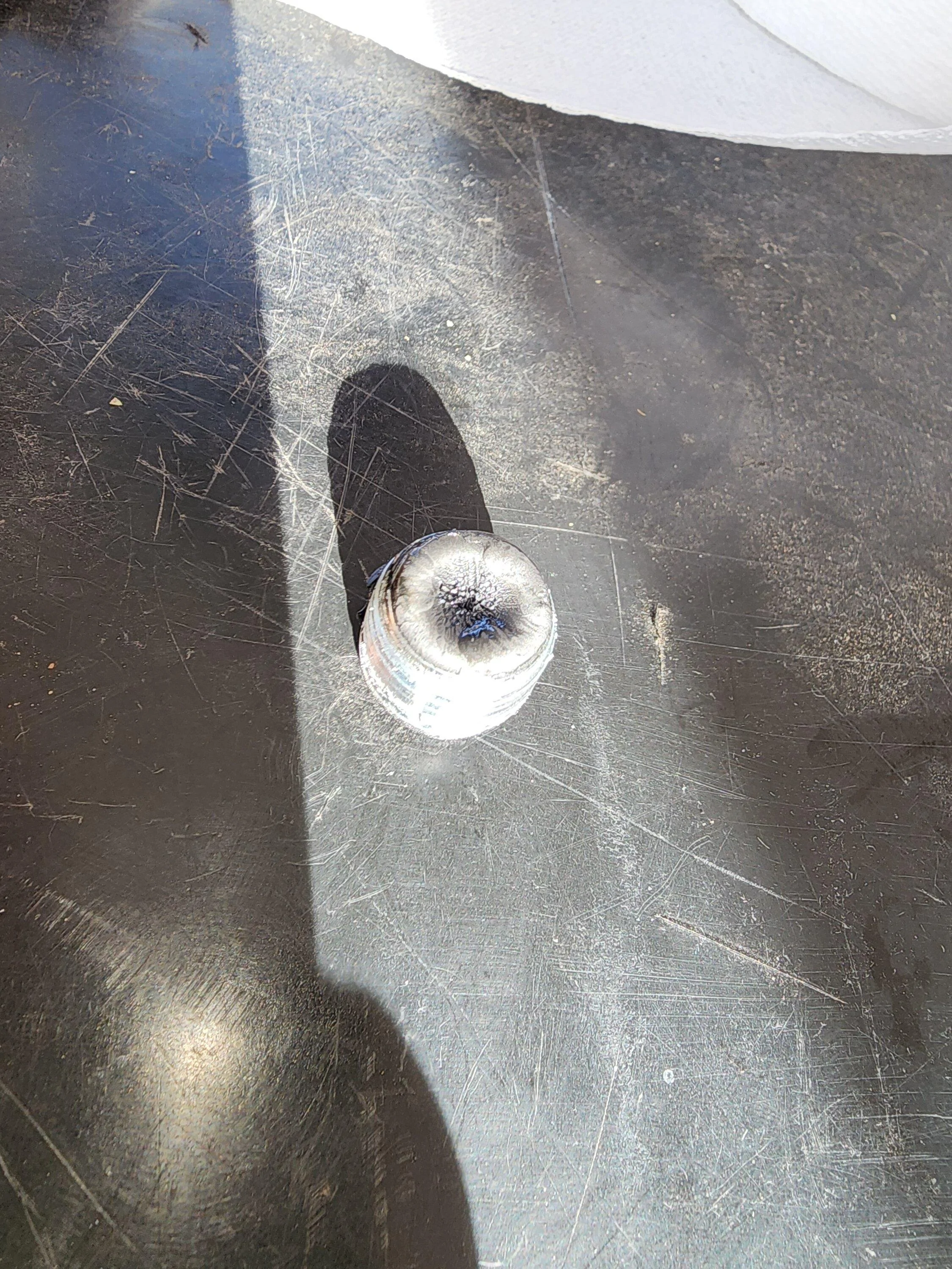

Transfer Case Plug (it is magnetic):
Ford Bronco Change Driveline Fluids Early! 20231103_135210

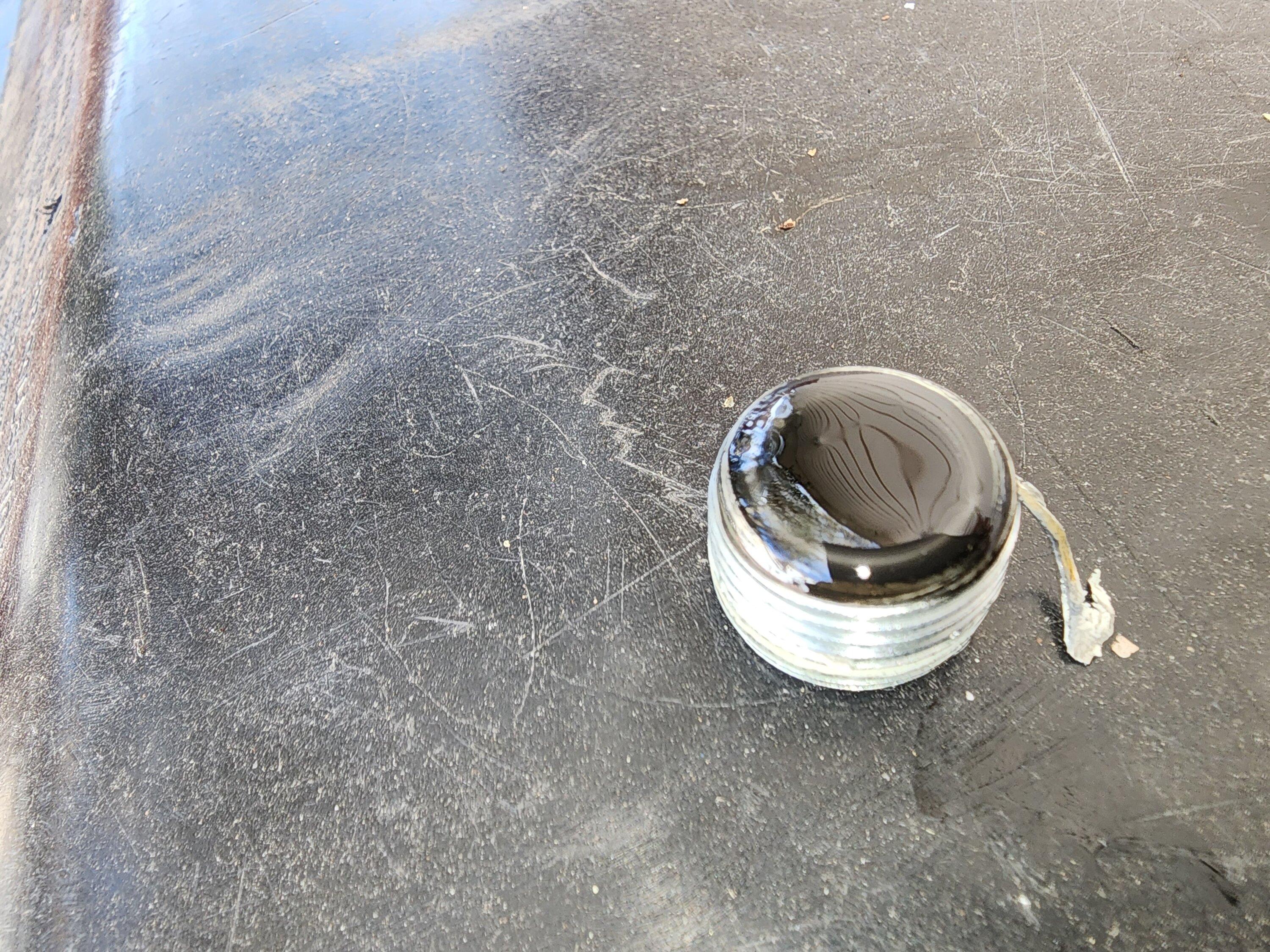

Rear Axle Plug (also magnetic)--Front Axle is also magnetic:
Ford Bronco Change Driveline Fluids Early! 20231103_155847

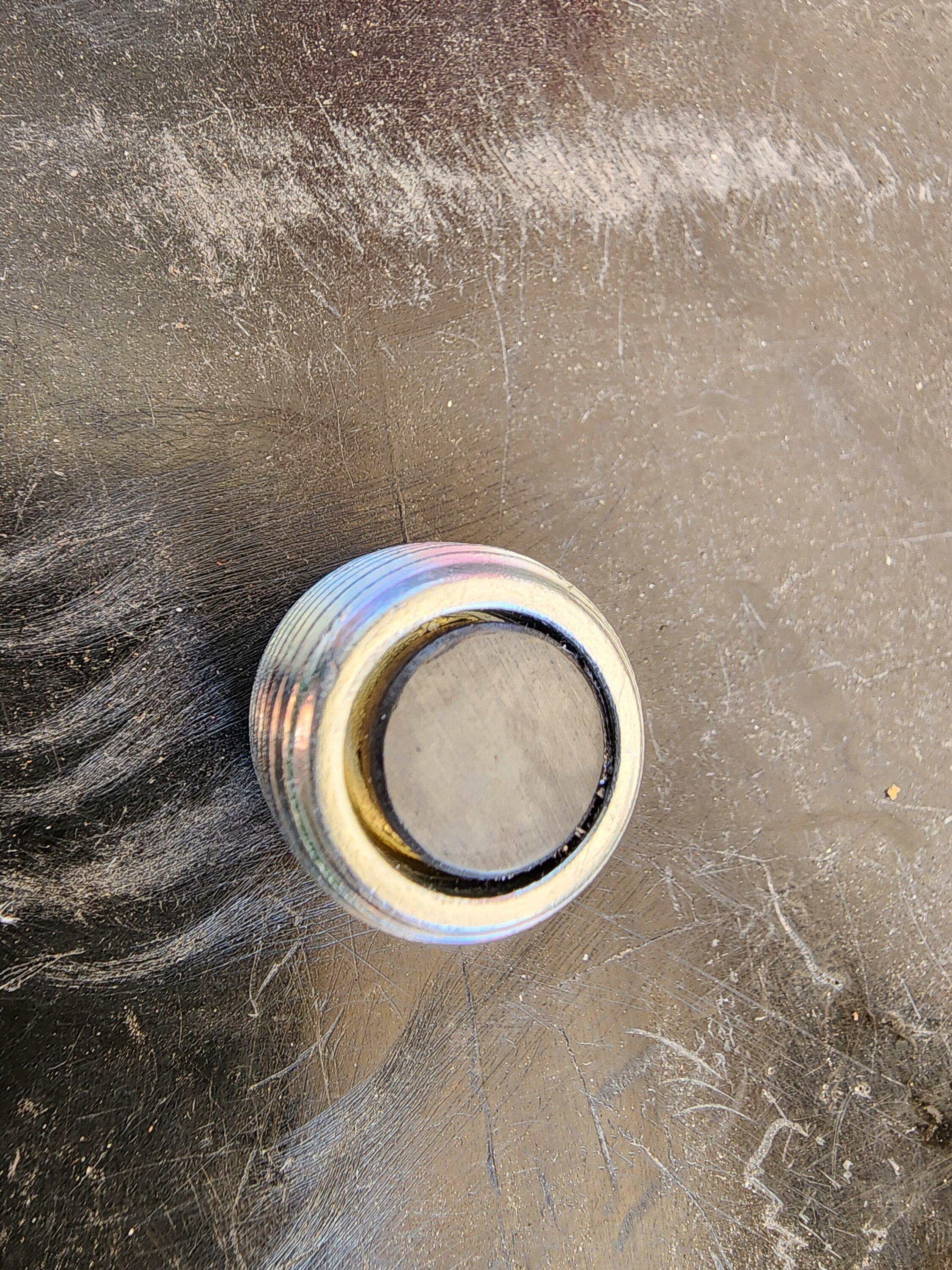

After Cleaning:
Ford Bronco Change Driveline Fluids Early! 20231103_140004

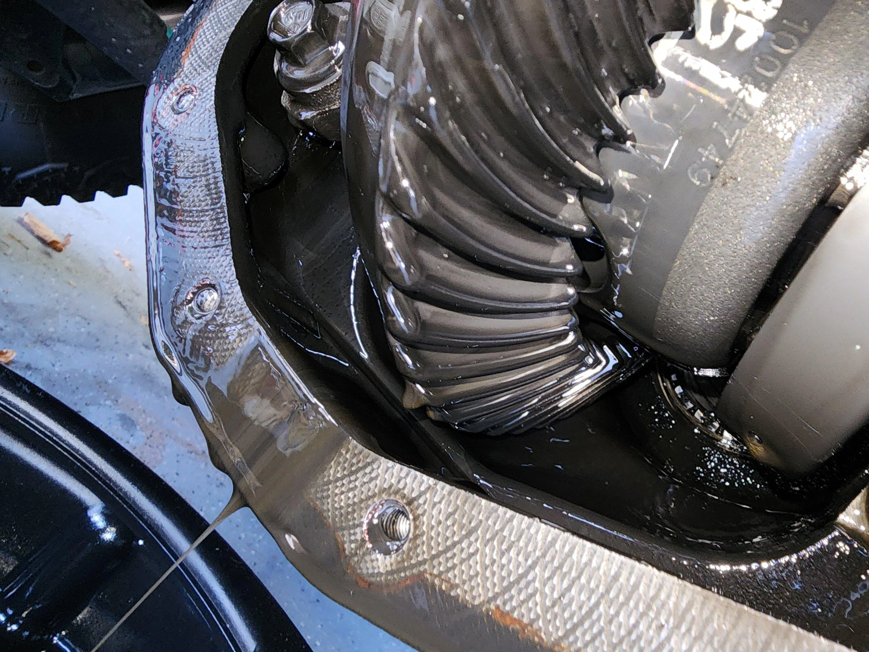

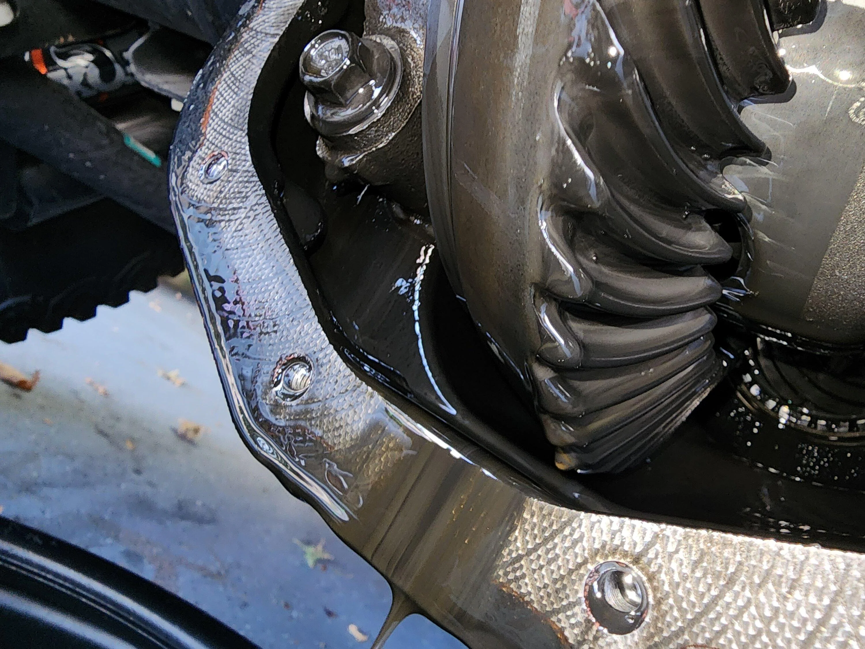

Rear Axle Internals (note metal in clinging/draining oil):
Ford Bronco Change Driveline Fluids Early! 20231103_154827
Ford Bronco Change Driveline Fluids Early! 20231103_154838
