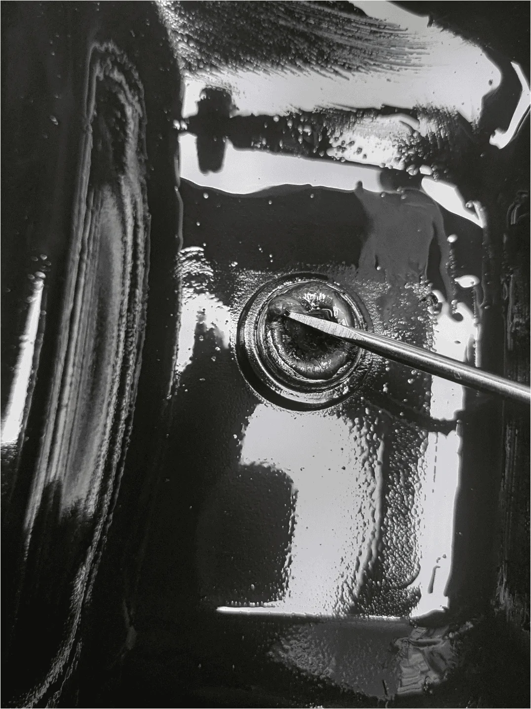

Front differential. Waste oil in similar condition as to the rear with metal paste on the drain plug:

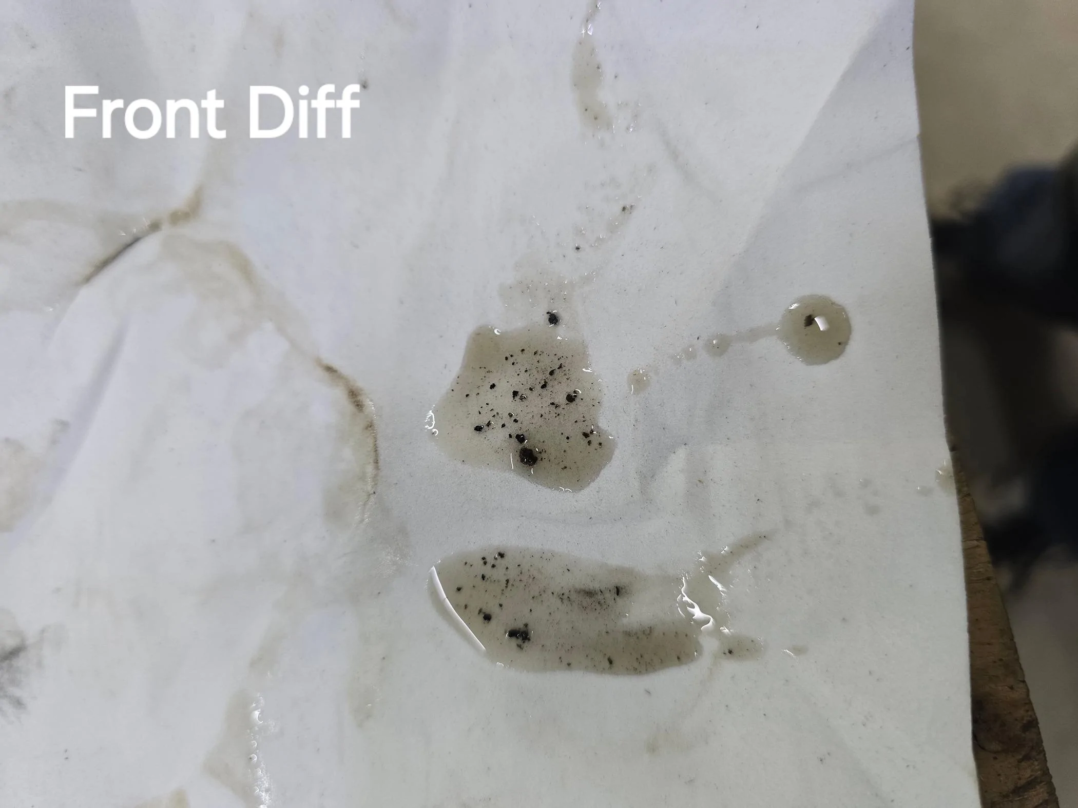

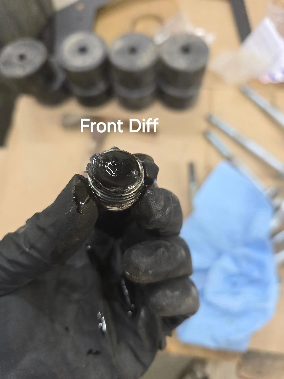

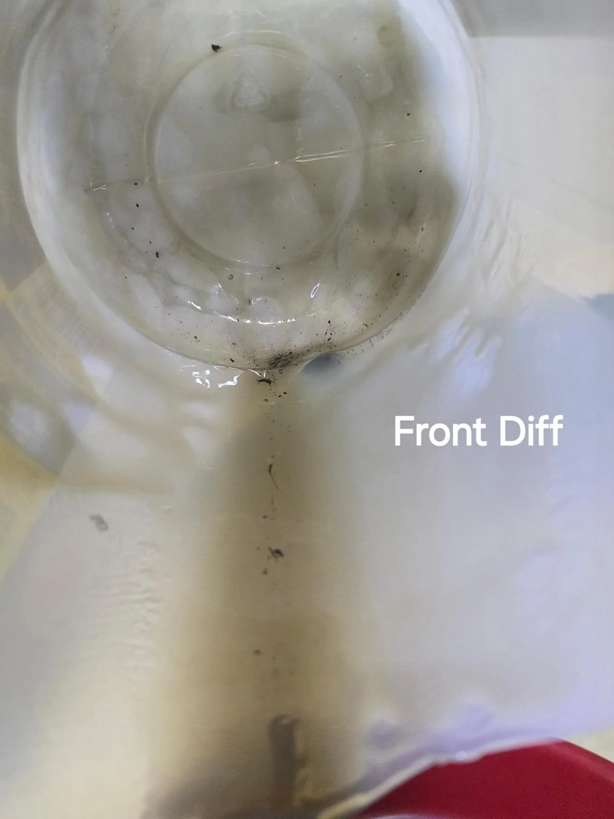

Did the the front diff, this is the magnet, metal paste on it.
Ford Bronco Change Driveline Fluids Early! 1000018602

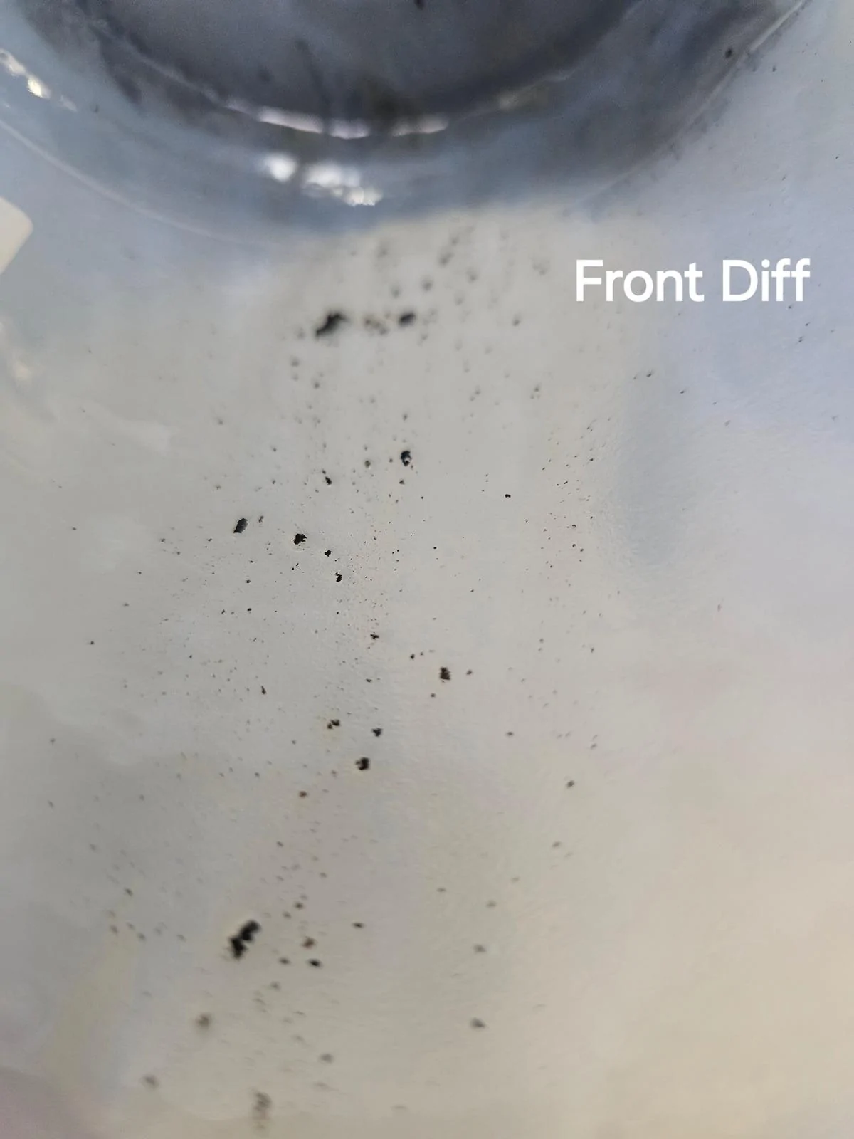

Drained into a container to see how it looked. You can see metal grains in there
Ford Bronco Change Driveline Fluids Early! 1000018609
Ford Bronco Change Driveline Fluids Early! 1000018610
Ford Bronco Change Driveline Fluids Early! 1000018611
Fluid pouring into drain container you can see it's pretty dark!

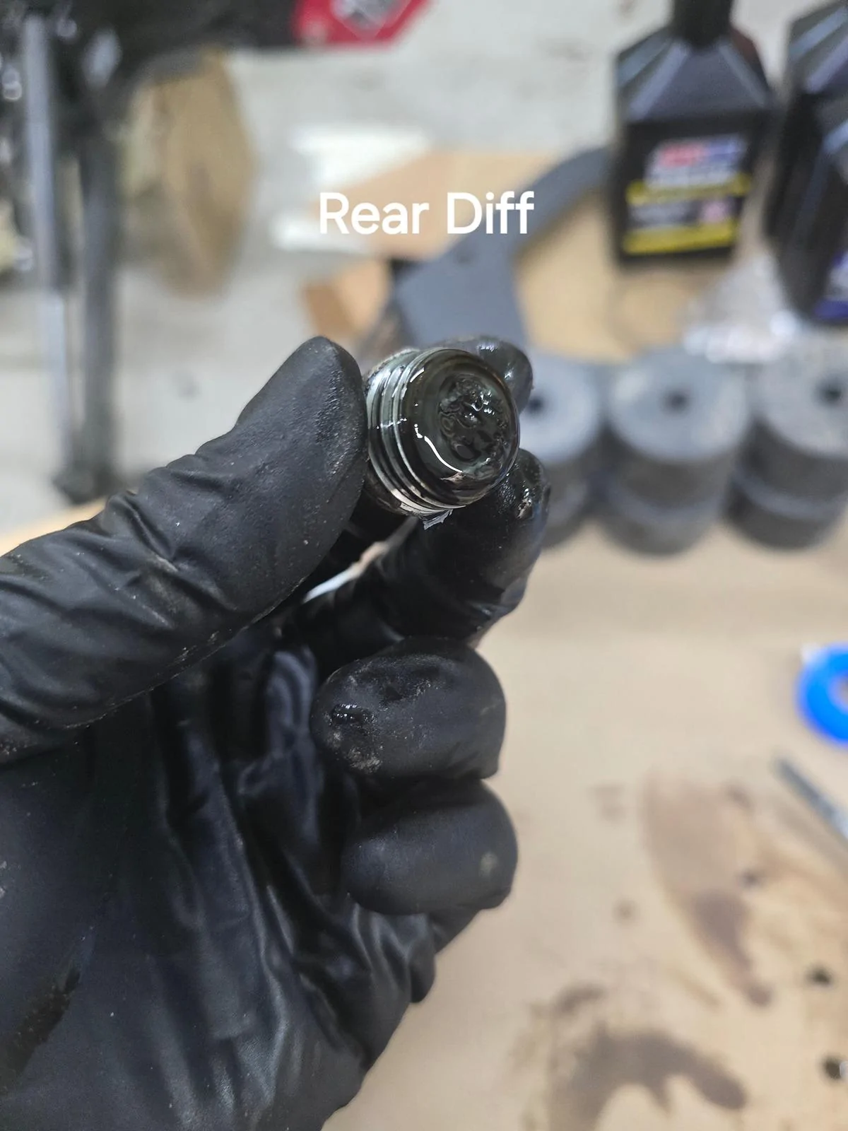

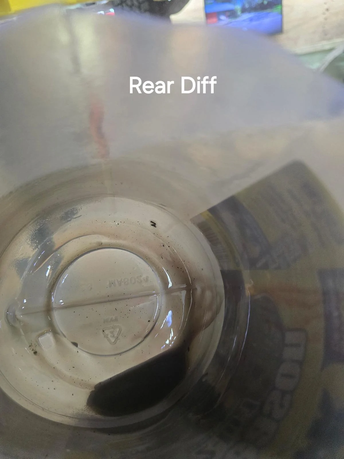

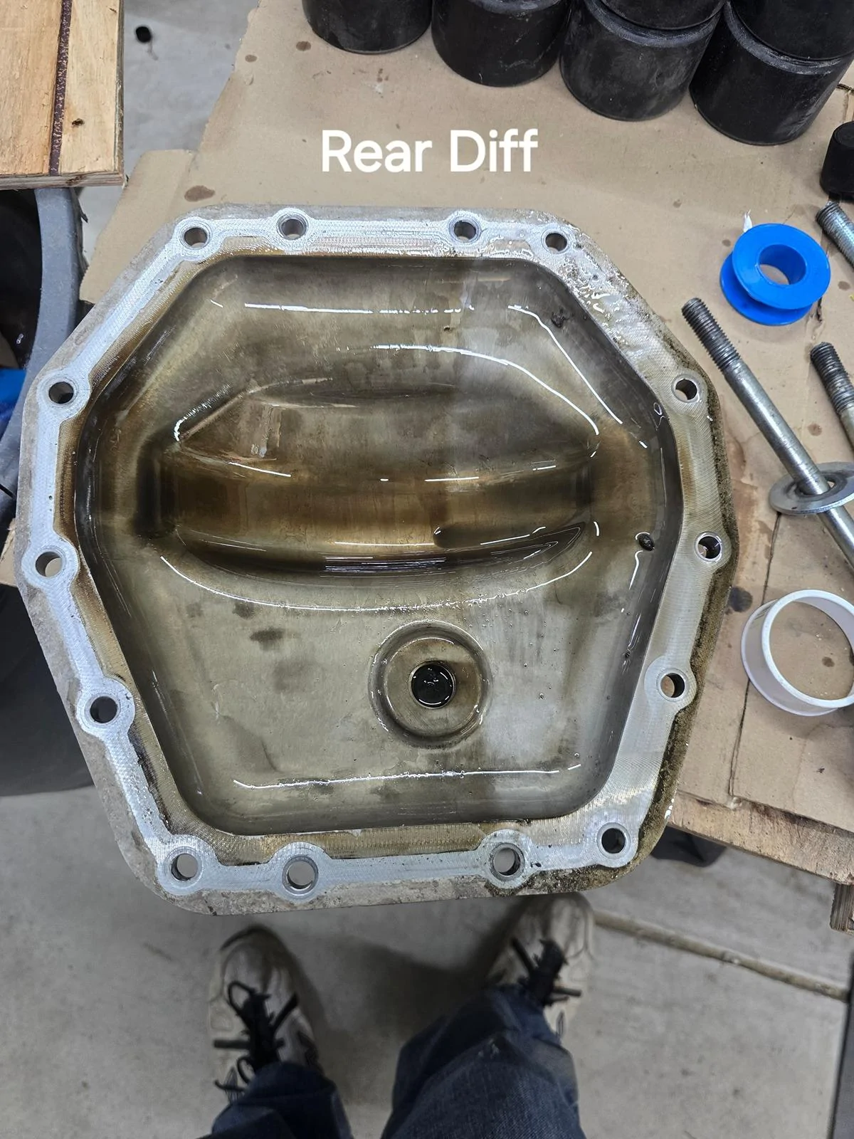

This is the rear diff.
Ford Bronco Change Driveline Fluids Early! 1000018614

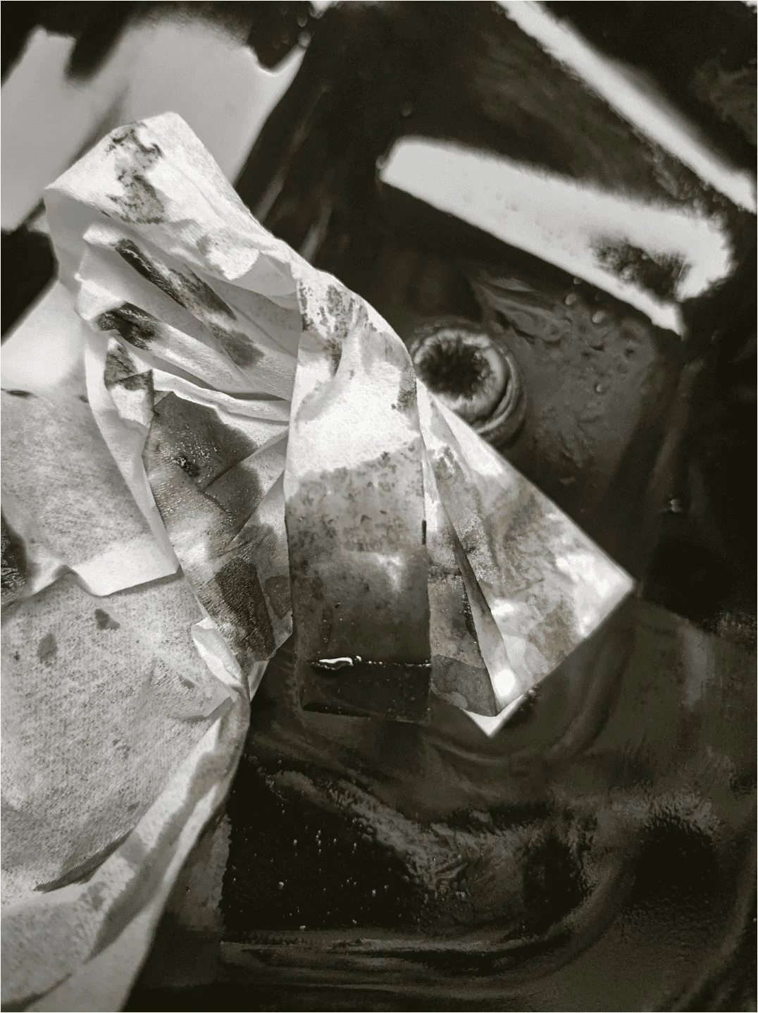

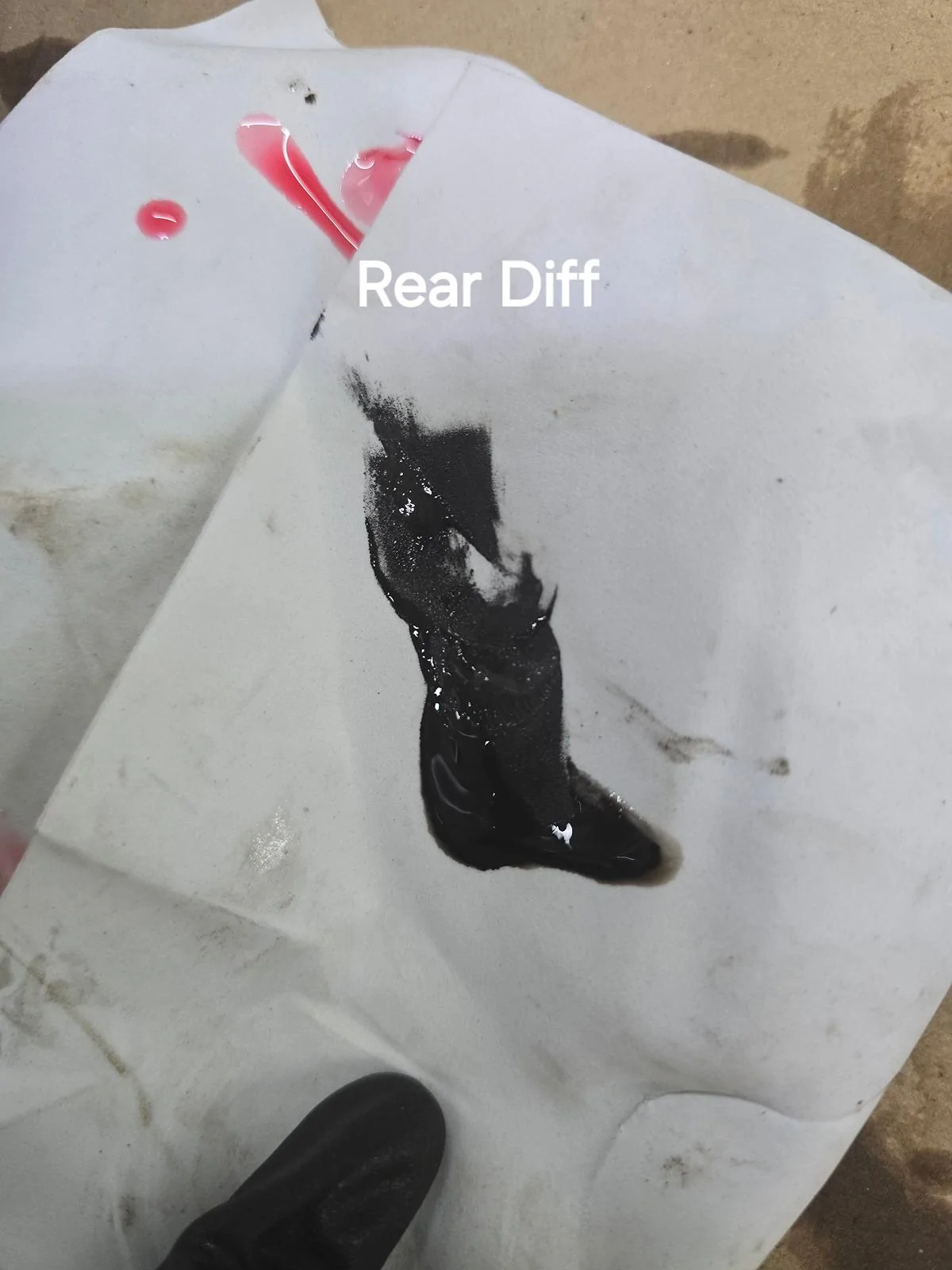

More metal paste
Ford Bronco Change Driveline Fluids Early! 1000018615

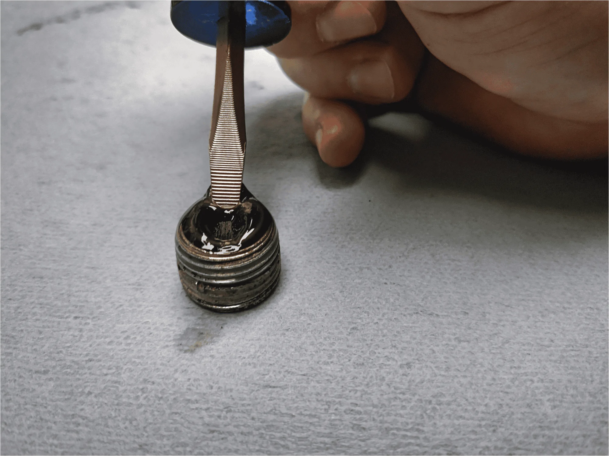

Metal paste smeared on a paper towel
Ford Bronco Change Driveline Fluids Early! 1000018616
As you can see that's dark as well.
Some metal grains in here as well
