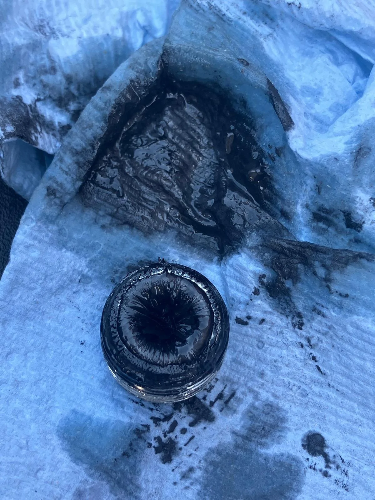

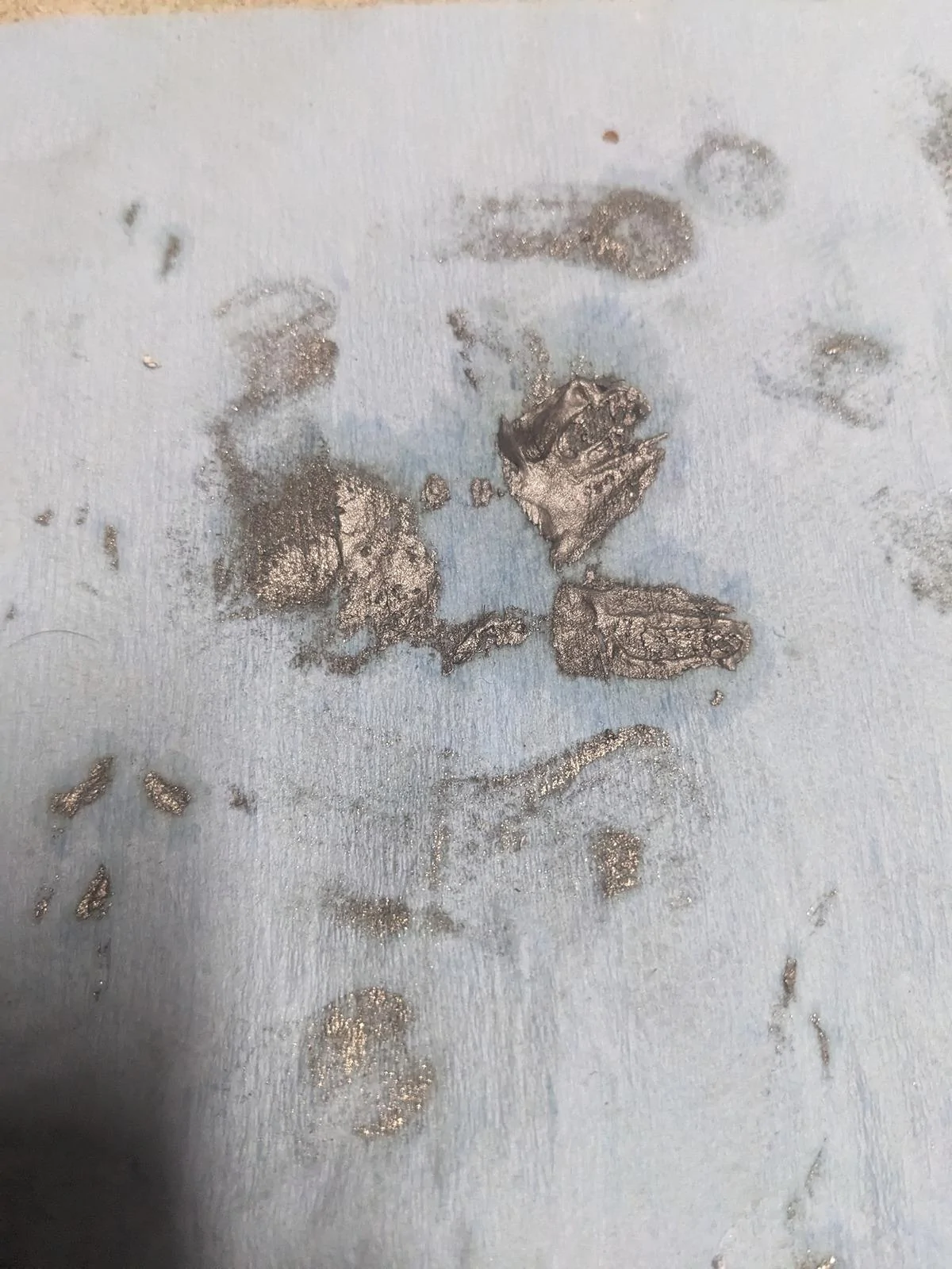

Scott towel showing metal from cavity:

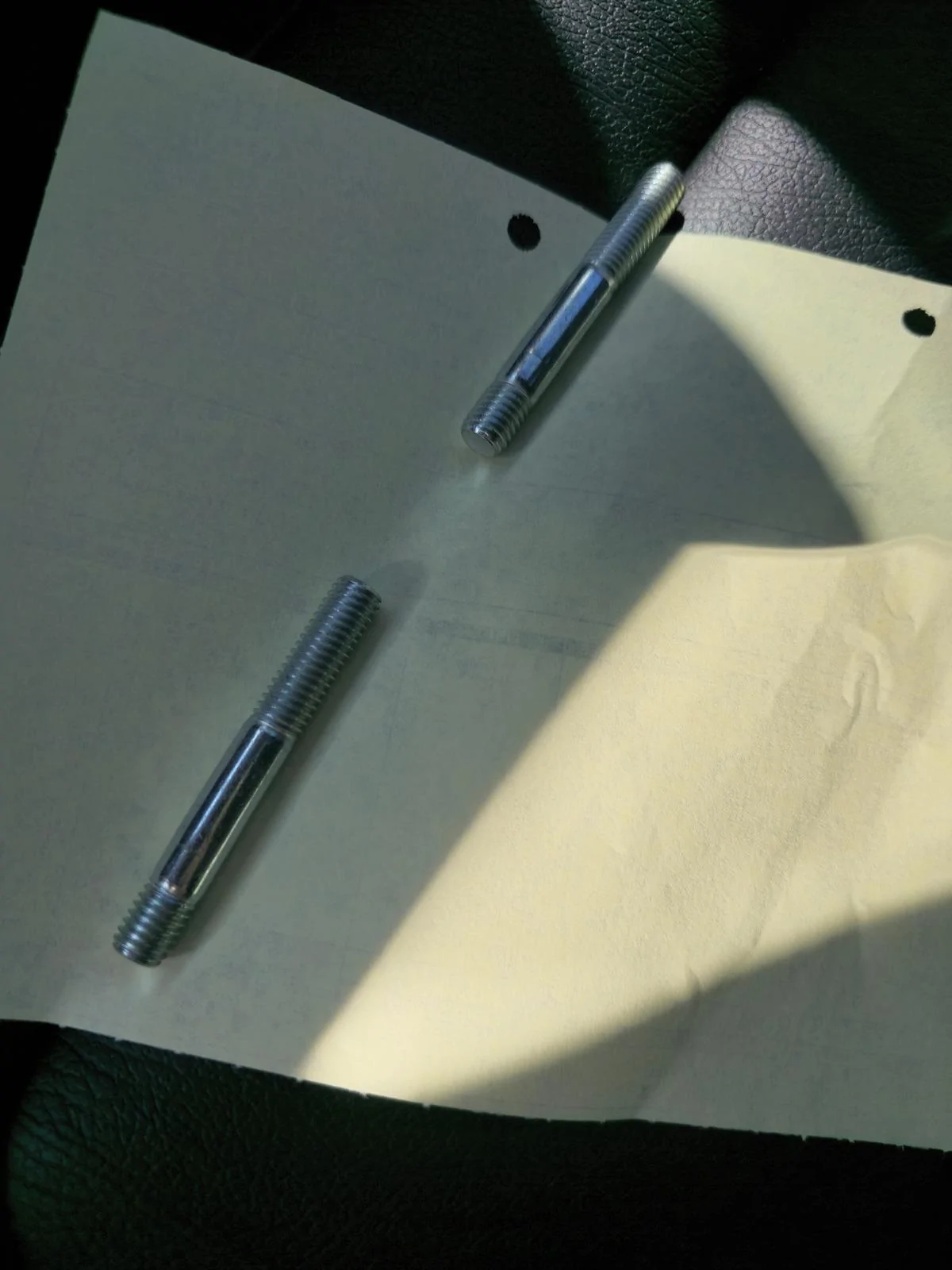

@CarbonSteel looks like everyone bought out the studs Lol any ideas where I can get some? Looks like I may be able to use a shorter stud?

I picked these up just to see but I think the threaded area might be to short? 60mm total length
They will be about a 1/2" too short. PM me your address. I have some 80mm that I'm not going to use.

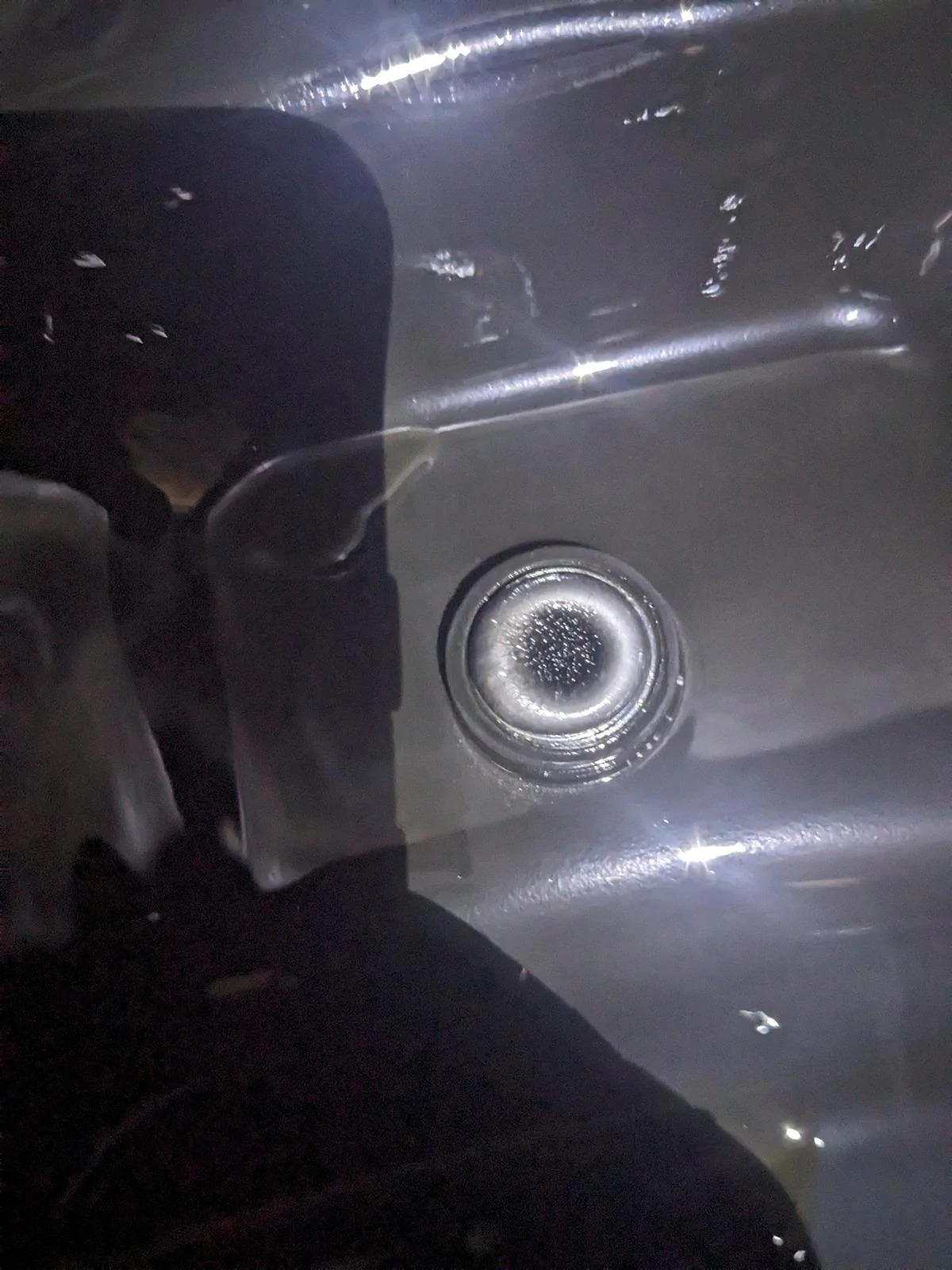

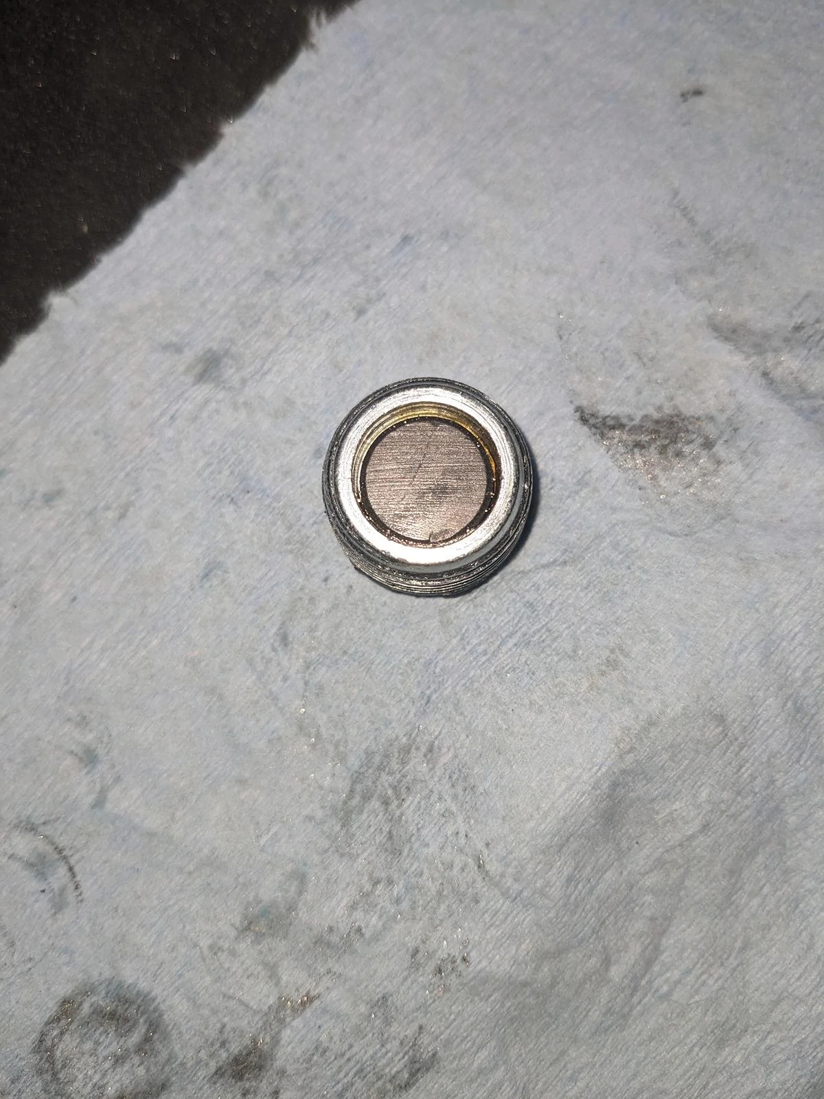

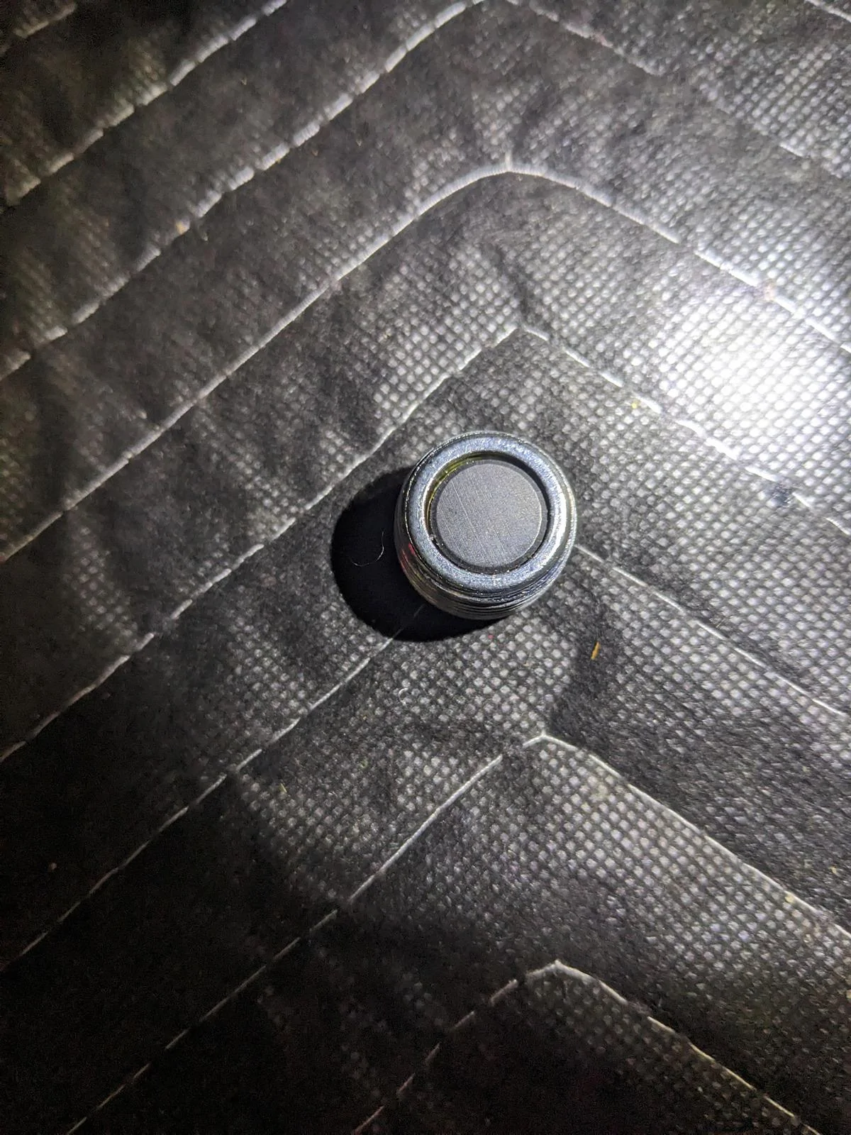

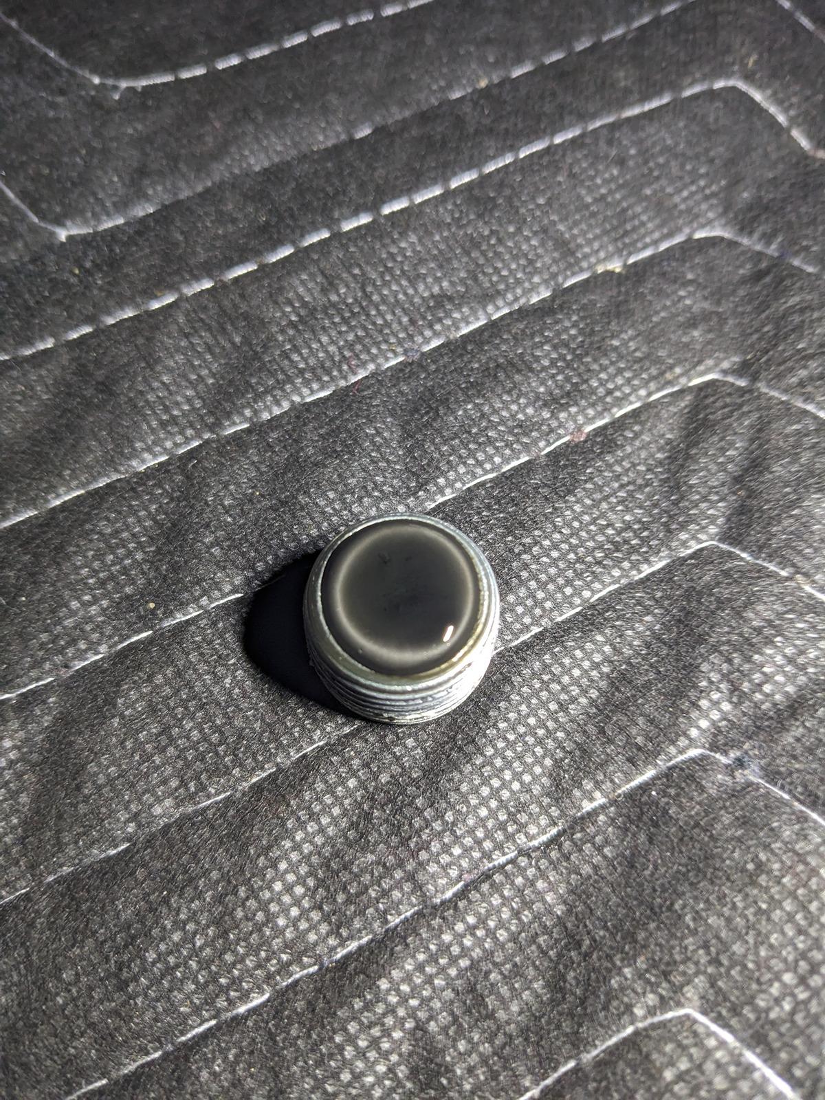

Changed out the front-axle today, along with the first oil change. Here is the drain plug before and after cleaning it. definitely some metal bits and paste present
Ford Bronco Change Driveline Fluids Early! PXL_20240518_213836853
Ford Bronco Change Driveline Fluids Early! PXL_20240518_221914039

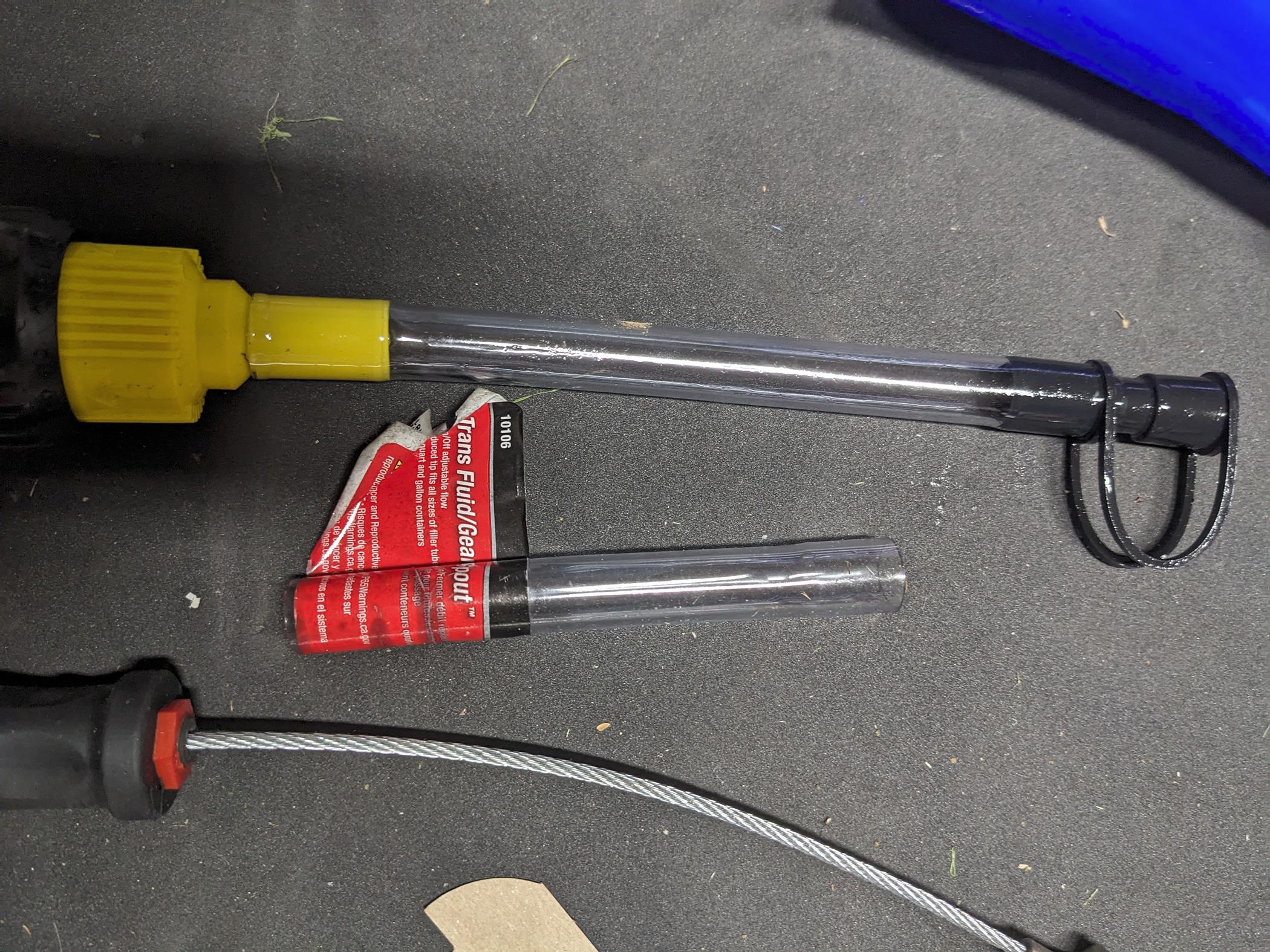

I did have issues refilling, tight fit for sure, that is until I cut the funnel a couple inches, it became a breeze thereafter.

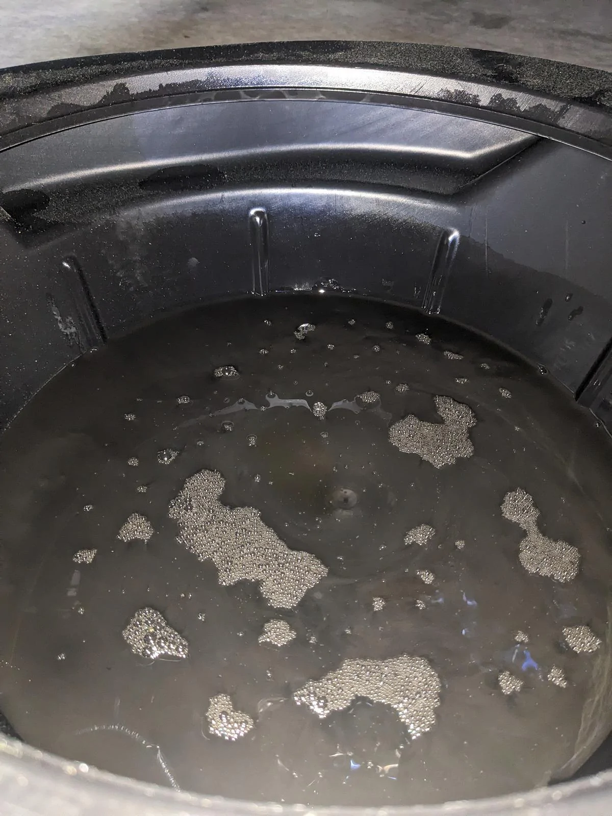

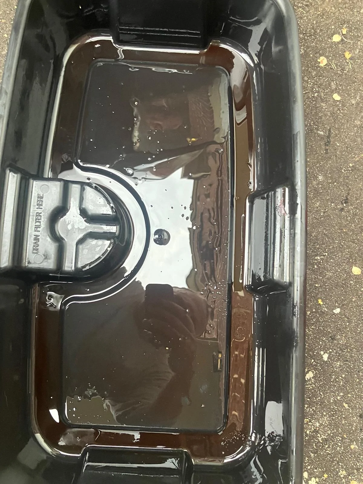

Transfer case fluid change at 5k miles this evening. You can see some grit in pan. Zero offroading so far - this is city and highway driving. Also changed the engine oil using Amsoil. Differentials and manual trans are next.

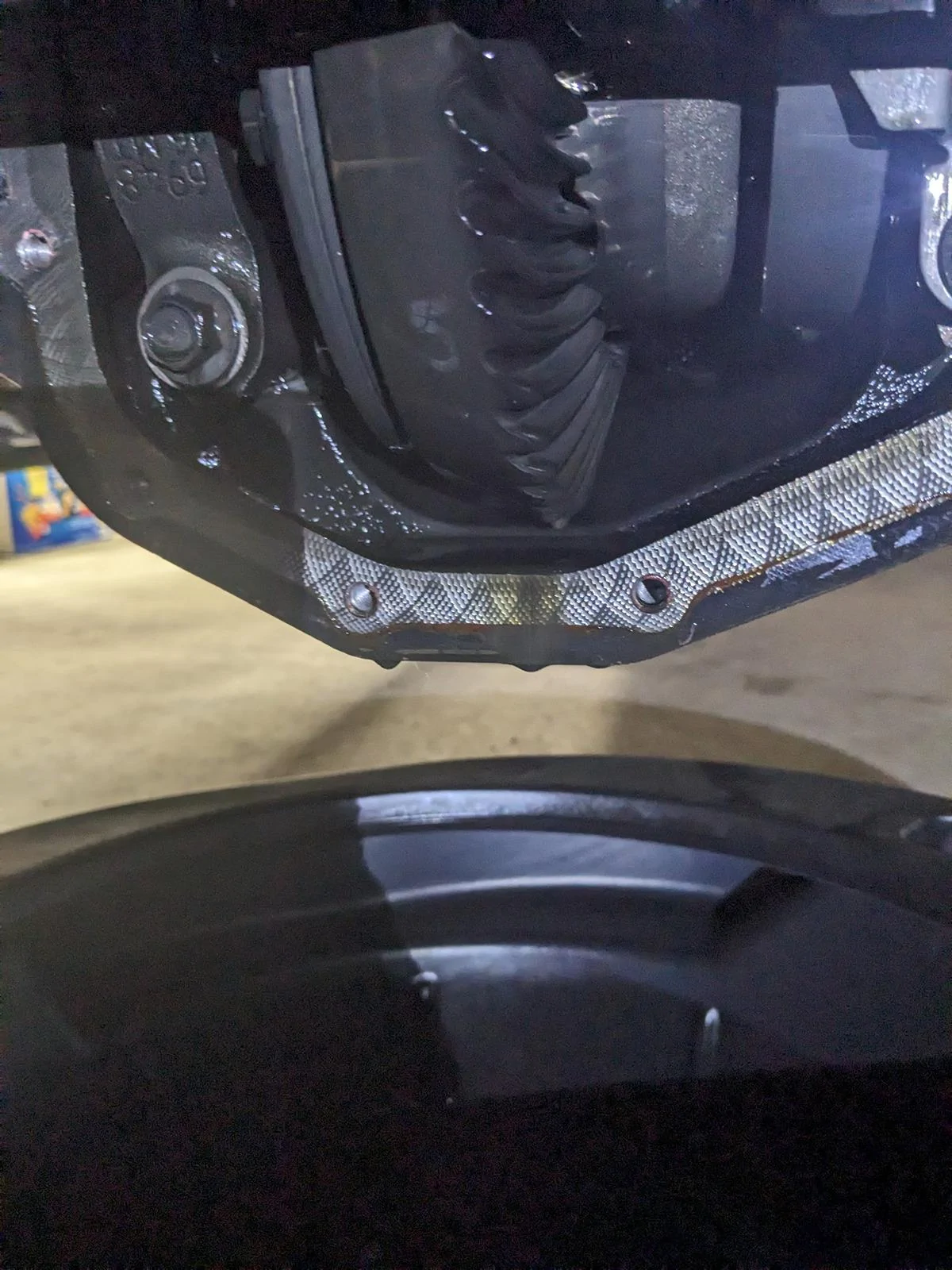

finally got around to doing the rear diff, so much gooey paste on the plug. Took the full 2qts
Ford Bronco Change Driveline Fluids Early! PXL_20240530_013658923
Ford Bronco Change Driveline Fluids Early! PXL_20240530_040617898
Ford Bronco Change Driveline Fluids Early! PXL_20240530_014624177
Ford Bronco Change Driveline Fluids Early! PXL_20240530_013734032
Ford Bronco Change Driveline Fluids Early! PXL_20240530_013712647
I replaced the OEM cover for now, I plan to install the FP cover at 5k when I redo these fluids.
