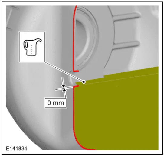

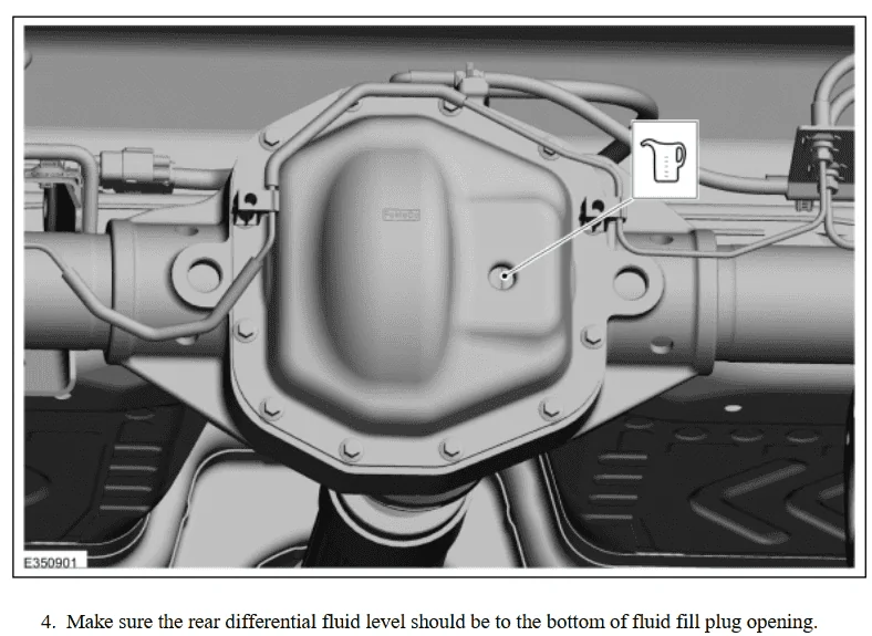

I would fill to the bottom of the fill hole. There could be some variations in capacity, though 10 ounces is quite a bit more than stated by Ford.
Thank you 👍 the illustrations sure make things clear. Makes me want to buy the 3 day license just to see what other good stuff is in there!
No idea why I was so far below the line - I squished in two quart bags, then added a decent sized squeeze extra from a 3rd bag to account for the extra required ounce or so, plus whatever I may not have gotten out do the first two bags. I figure that got me to “somewhere in excess of 65oz” but I dipped my finger in and found to my surprise I was still somewhat below the fill hole. Maybe I missed more fluid than I thought 😰
Was my first experience with quart bags… I like em.
anyway, thanks again 🍻
