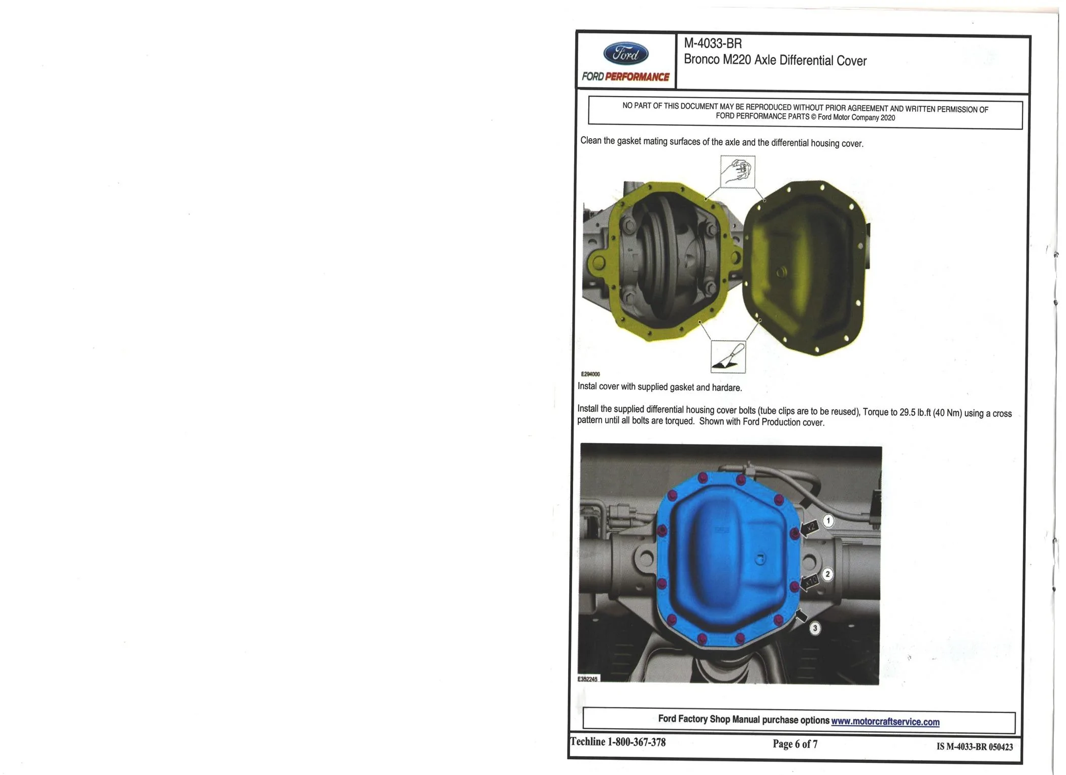

Clean the basin inside the housing with lint free towels only. Do not introduce brake cleaner into the housing, there is zero need--no advantage--and it will attack the seals.
The OEM gasket can be re-used at least 10 times and given there is no replacement on the market for the one that comes with the FP cover, why would you use it? It is a fiber gasket that would need sealant applied which is messy whereas the OEM gasket comes off with no cleaning required.
I would torque the bolts to 22 nm to start and go up to 25 nm if needed. I would not go 30 lb-ft, you are risking twisting off the bolt.
Ford's torque spec is 20nm + 25 degrees. 30 lb-ft would be about 40nm.
How is brake clean, which quickly evaporates, going to get into the pinion seal and axle seals unless it is sprayed onto them or dumped into the housing?
The instructions with that cover specify 30 ft lb. They are 10.9 (grade 8 equivalent) bolts.
Why would the gasket that came with the cover need sealant? Both the housing and cover are perfectly machined.

I do what the manufacturer recommends.
If that works for you. I prefer to use the OEM rubber gasket because you will not find a replacement fiber gasket if you pull the FP cover so why bother? The OEM gasket is reusable and does not require that much torque.

Replacing the OEM cover with a FP cover is a very straightforward process and it requires a minimum of tools, though you do need a torque wrench that can apply 22-30ft-lbs of torque (most any 3/8" torque wrench can do this).
I would be happy to walk you through it, but in any case--find another dealer!

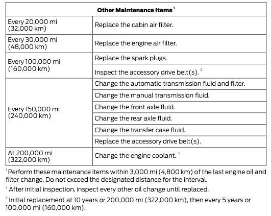

This spreadsheet that I created may help you make some decisions.
Front Axle = 75W-110 or 75W-140. For 75W-110, I use Amsoil Severe Gear as there are few choices for this viscosity on the market. If you want to use 75W-140, Amsoil for 75W-140 is my choice, but Valvoline, Mobil 1, or Castrol will also serve you well.
Rear Axle = 75W-140 in any of the aforementioned flavors.
Transfer Case = Mercon LV. I use Motorcraft brand because there is little to be gained by using a high-end aftermarket brand. There are no combustion by-products to combat and it is better to change it more frequently with a "normal" fluid versus extending and using a higher end one.
Manual Transmission = Motorcraft Dual Clutch Transmission Fluid. On this one (and the automatic), there are very few choices and as such little reason to deviate from the OEM.
Hope this helps!
