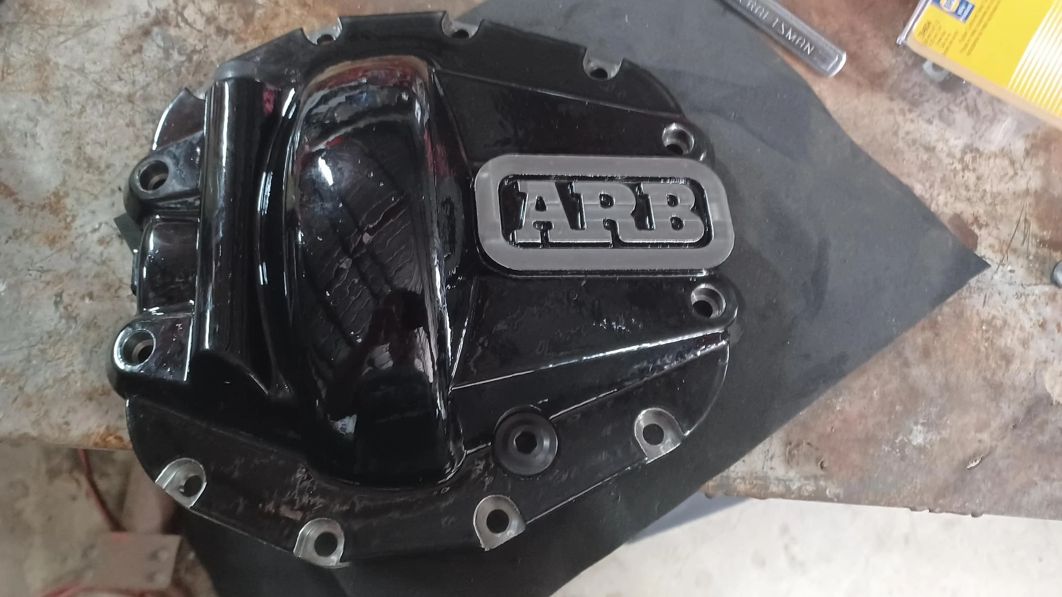

So I got my ARB diff cover a few days ago, got me some Mobile Uno 75w-140 today.
Got more stuff coming next week to do the rest of the driveline.
Just under 12K miles.
What took the longest was drilling out the bolt holes in the 1/4" adel clamps for the brake line.

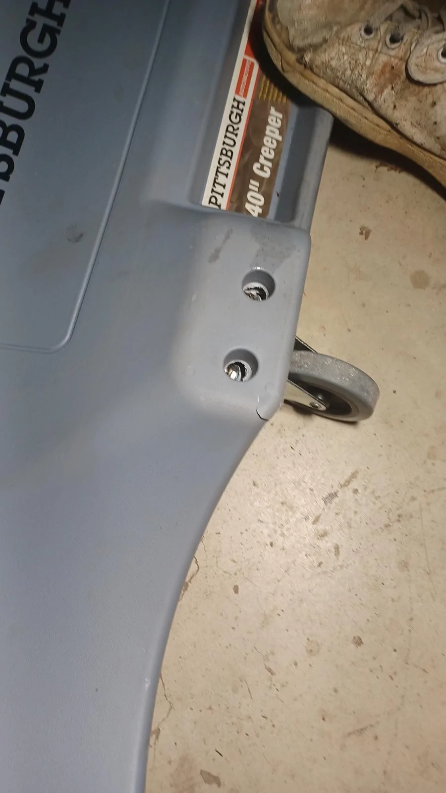

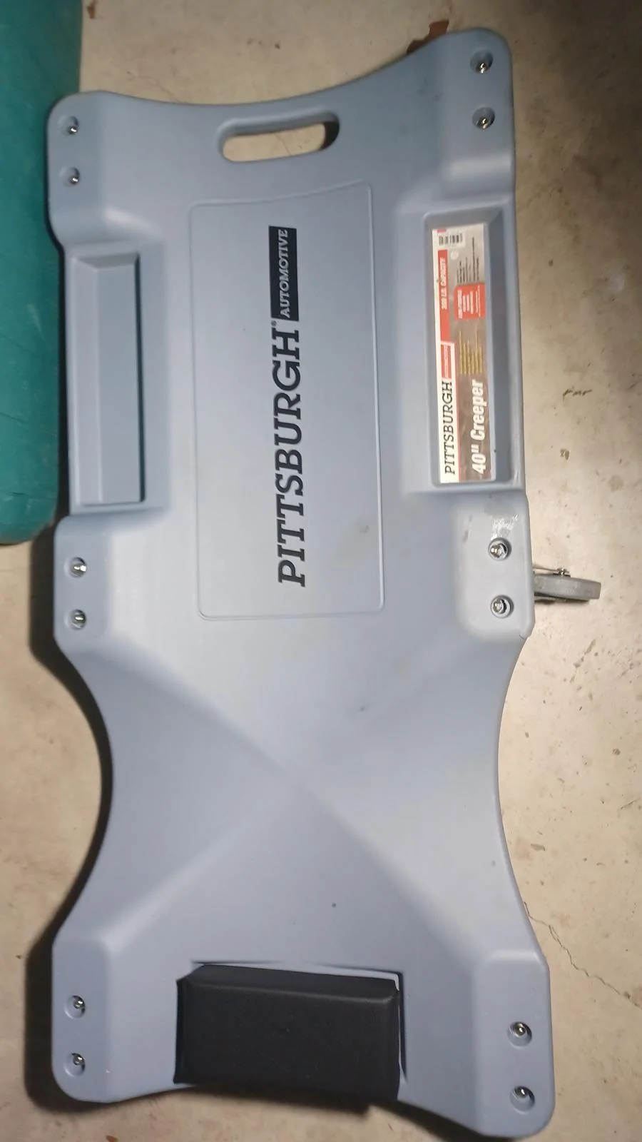

Chunk Of Shit creeper!!!
Used TWICE!!!
And I don't weigh 300 lbs!!!

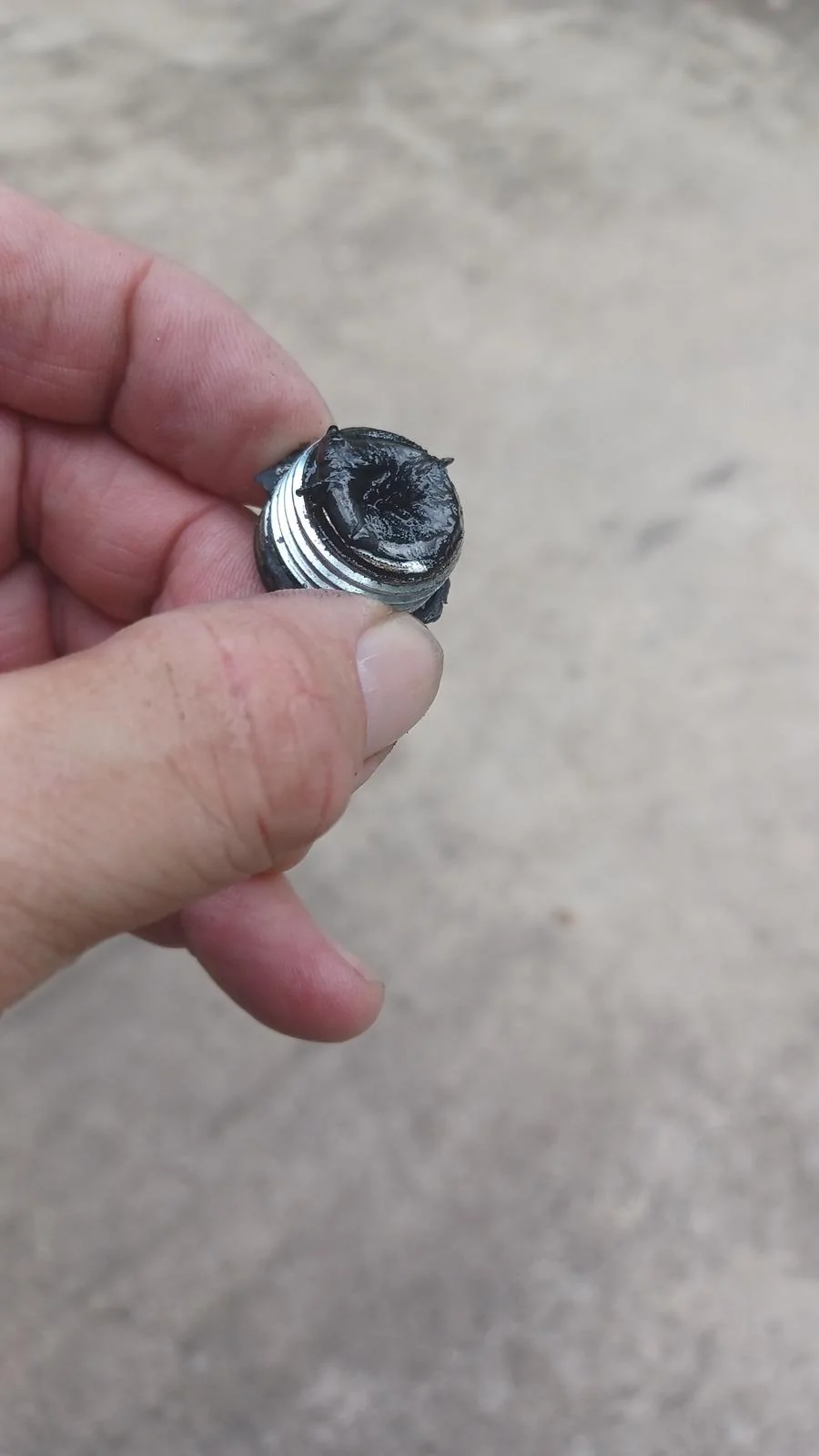

With 1K on my HE I did an oil change, front diff and T-case oil change. I have driven it it 4A a couple of times since receiving it the first of Feb but no off-roading yet. The engine oil on the dipstick was clean but really dirty in the pan. The catch can had a little over a teaspoon of oil in it so I believe it was worth the investment. Front diff had a lot of metal on the magnet and the gear oil had some shine to it from break-in. Filled the front diff with 75-140 because I had it and will switch to 75-110 next go around. The T-Case did not have a magnet and was laced with black break in/wear materials. I took a spare magnetic plug I had and replace the T-Case drain plug, refilled with Motorcraft LV but will change to Castrol full synthetic at 3K when I do my next oil change.

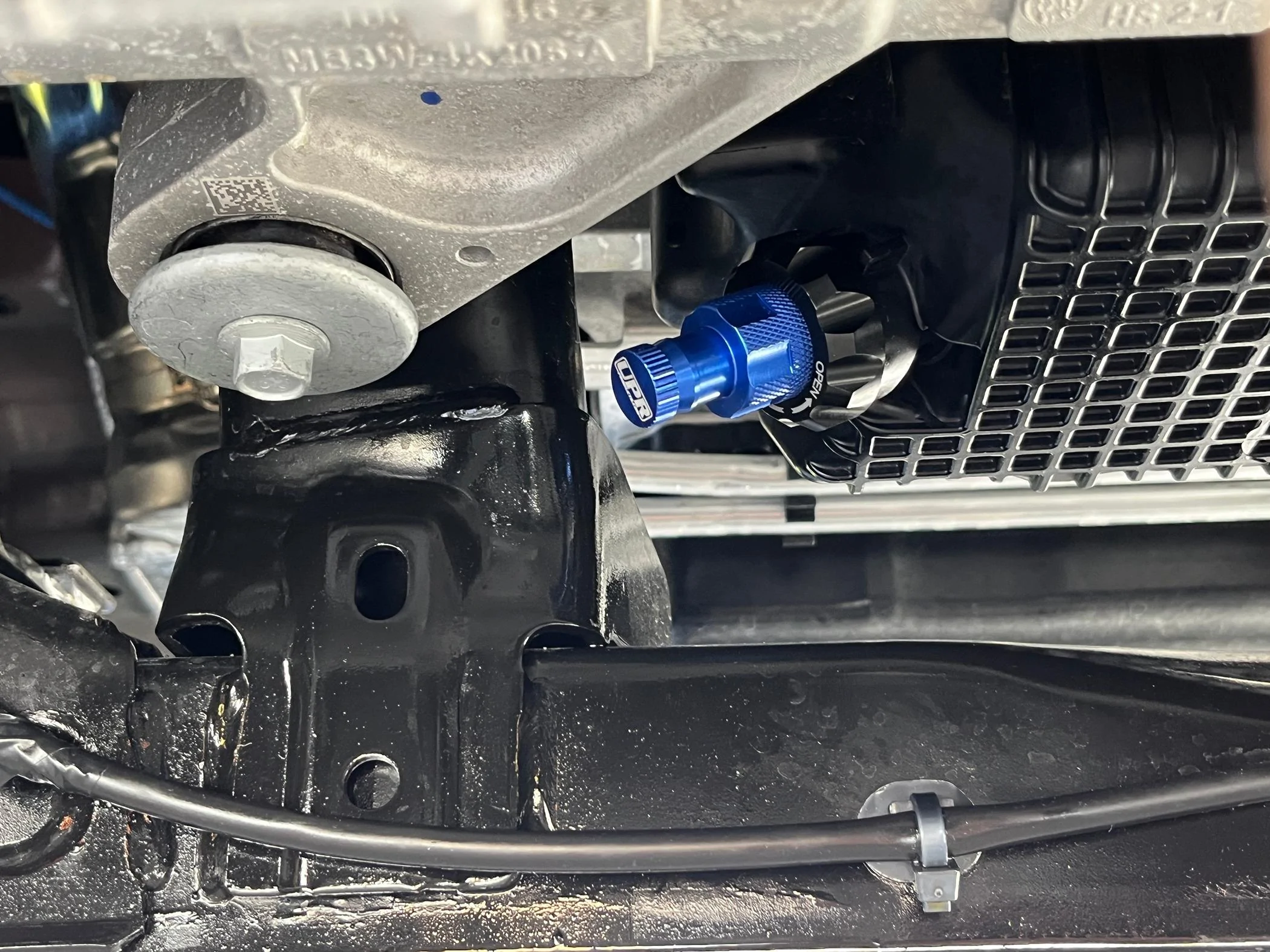

Forgot to mention, I changed the oil drain plug.......

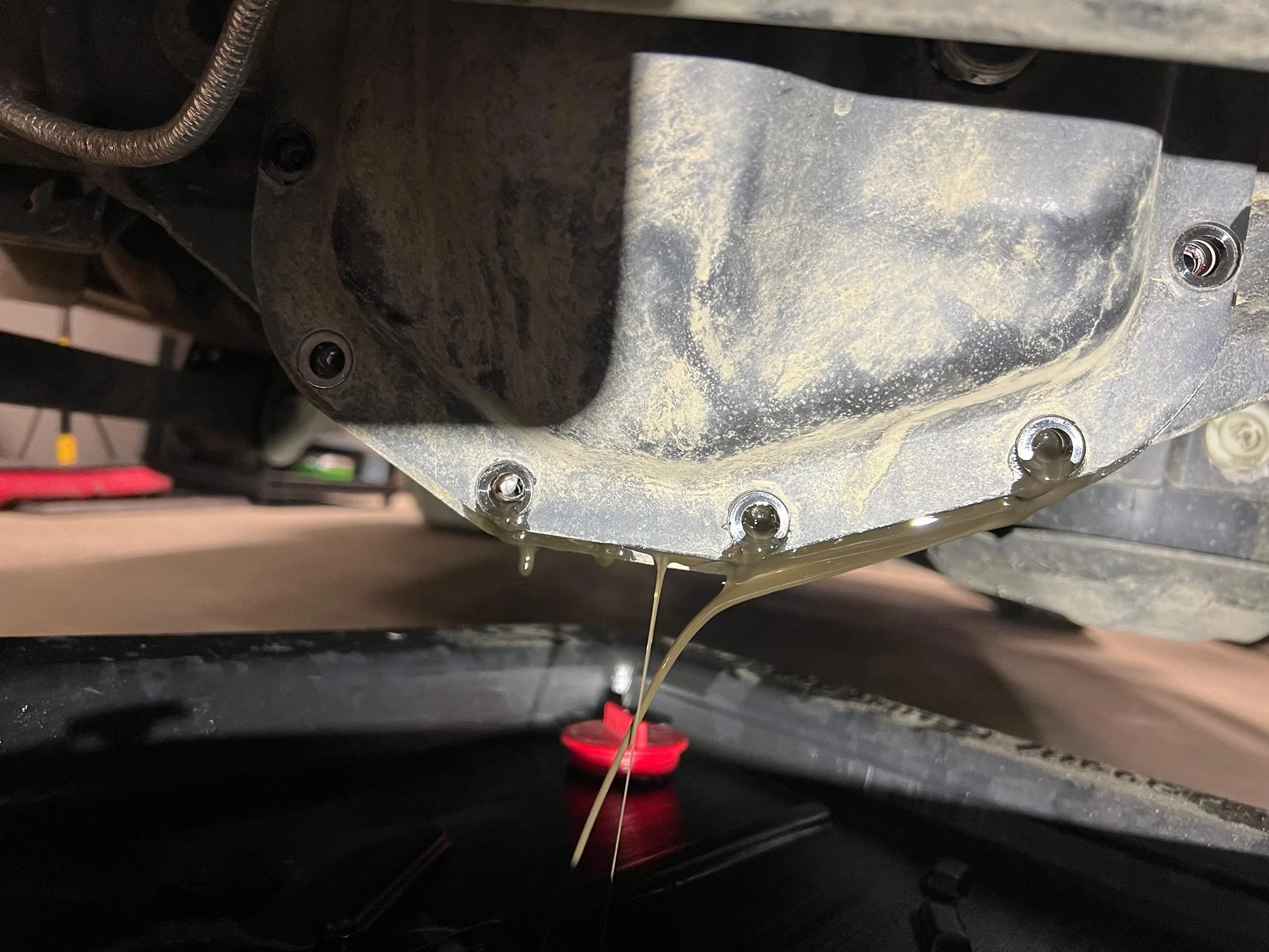

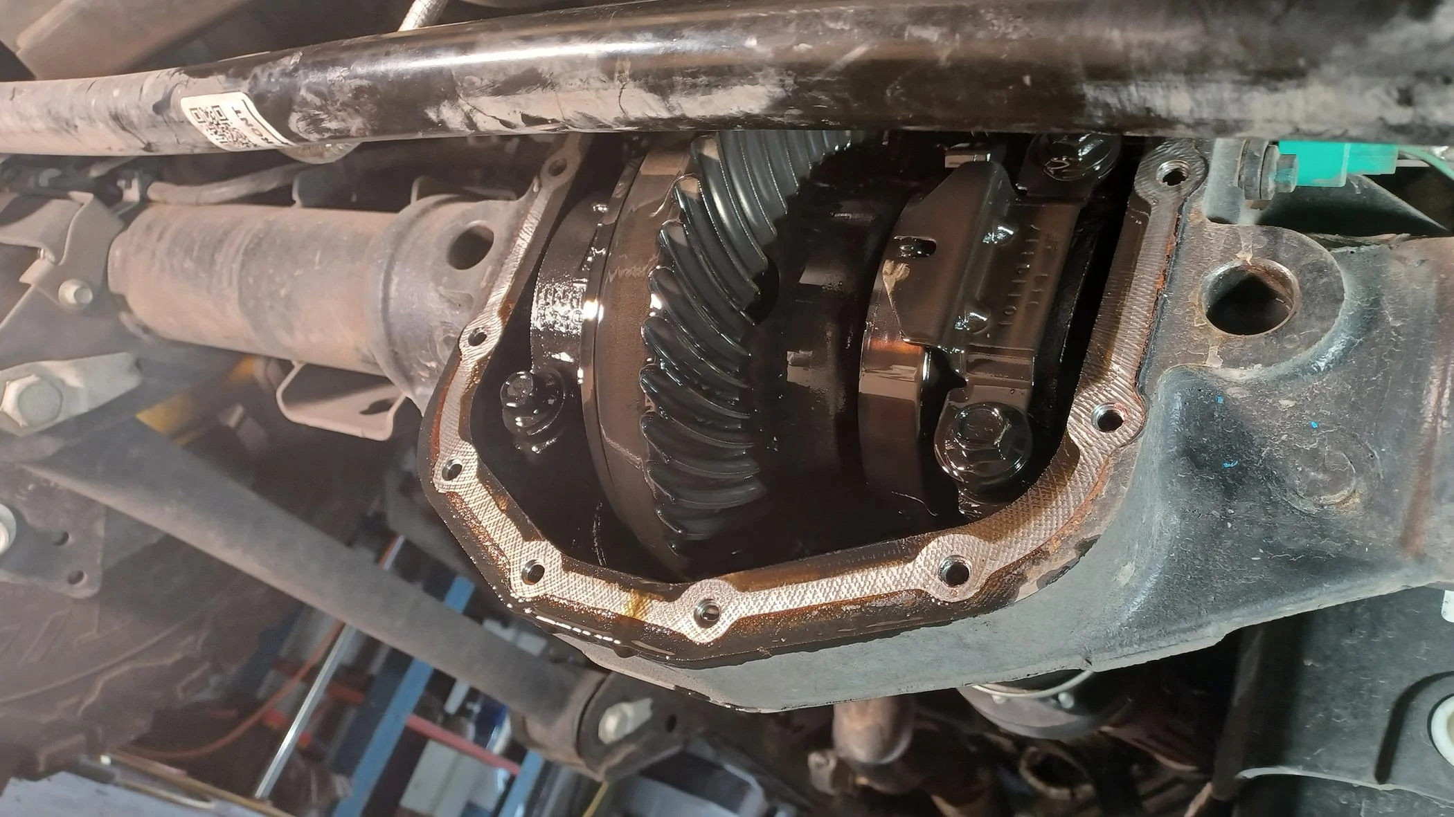

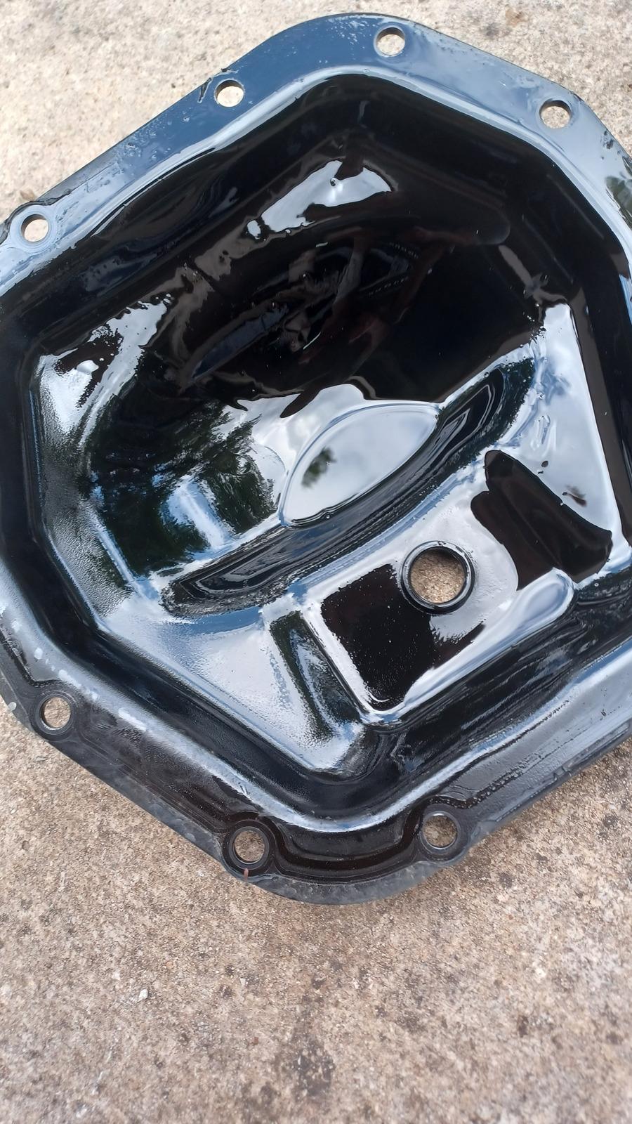

I changed my rear diff fluid yesterday and installed the FP cover. At 1K miles it looked like hot garbage with a lot of metal on the magnet. I will change it at 3K and as I mentioned before 6K at which time I will fill it with Amsoil ILO Valvoline.

glamor shot of the drain process. Def a bit nasty:
