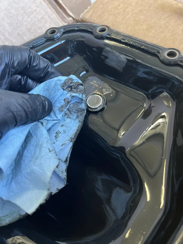

Went ahead and had dealership flush the transmission fluid at 36k miles. Came back with report of "contaminated/burned". At least now with the PPE pan, I can change it myself.

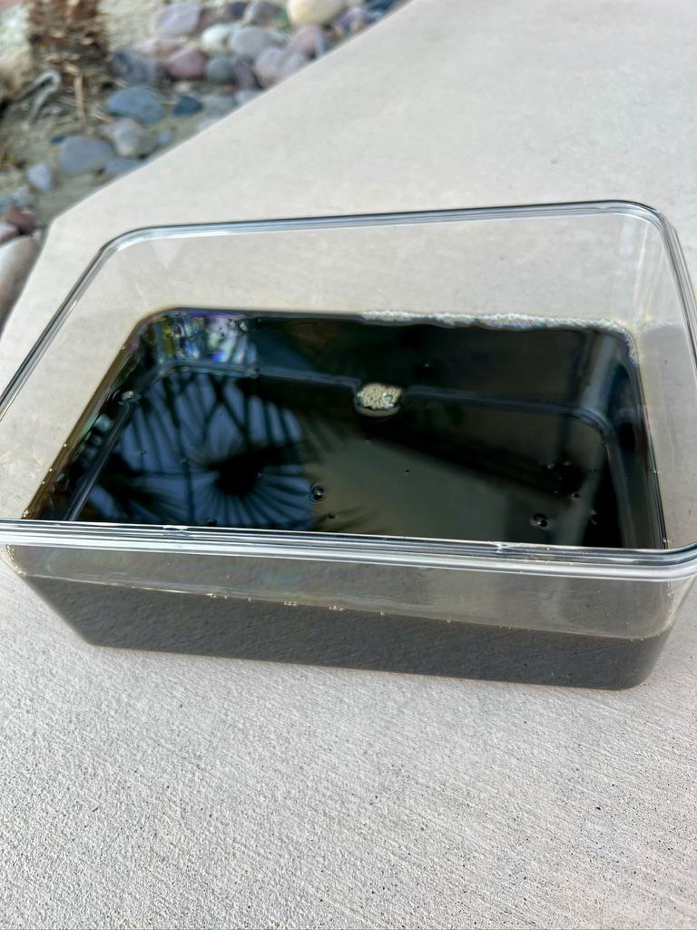

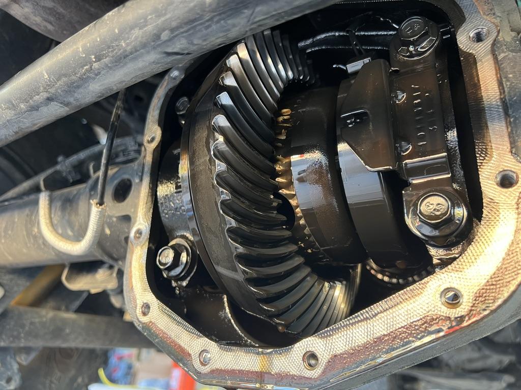

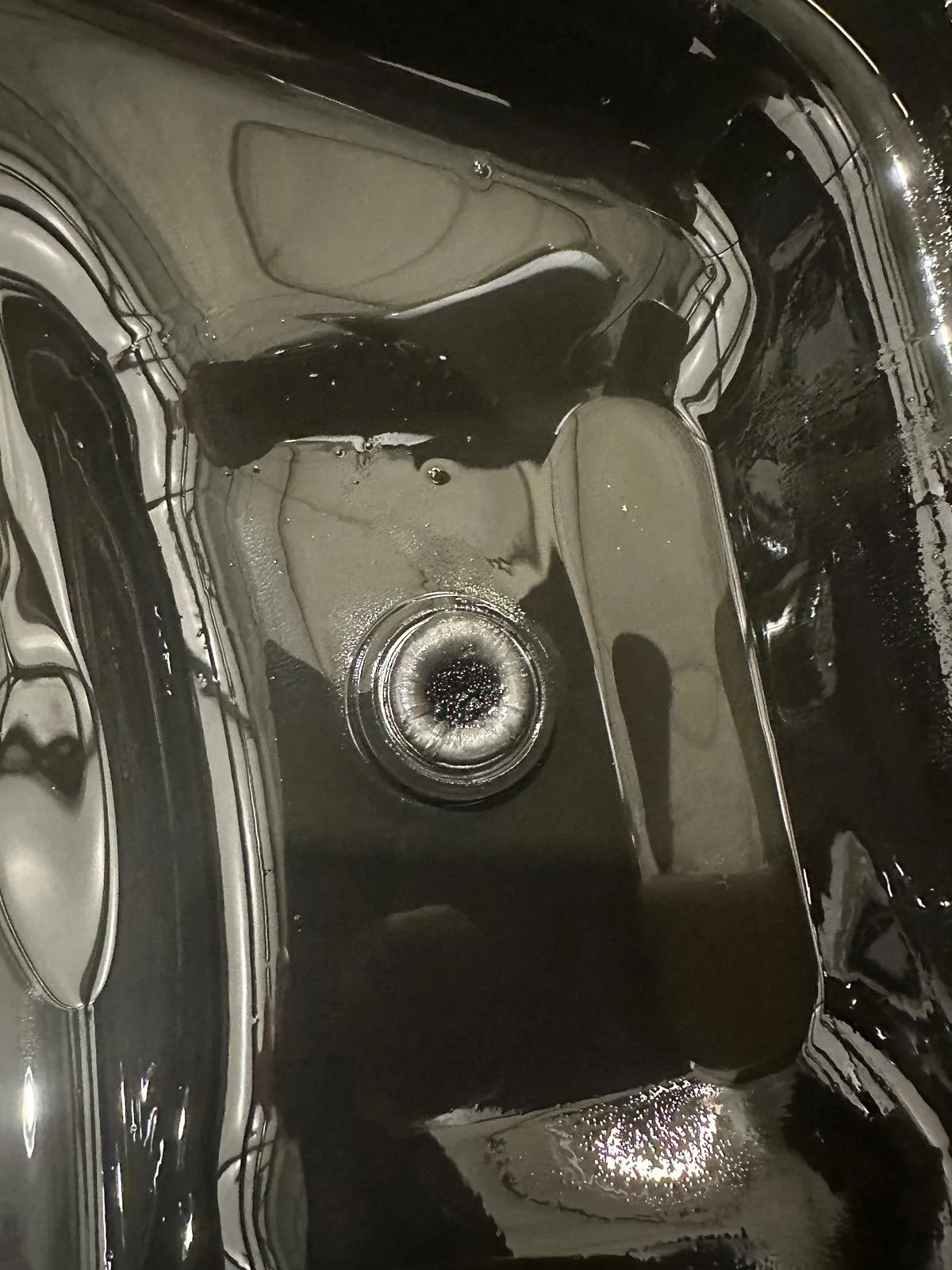

I changed out all of my driveline fluids over the past week (about 12k miles. Badlands SAS 2.7). I saw mostly the same as the majority have reported. Rear differential was coffee black with a thick paste on the magnet and lots of black residue on everything inside. Front Diff was slightly better looking but still not what I would expect for such low mileage. Transfer case was a reddish brown.
The rear looked so bad I ran a cheap flush oil for 1k miles and then drained it again and filled with Amsoil. It was surprising how dirty the flush oil was. I recently changed my dad's 2500 HD Duramax rear diff fluid. It tows a trailer for most of its life and it wasn't as dirty as my bronco :(.

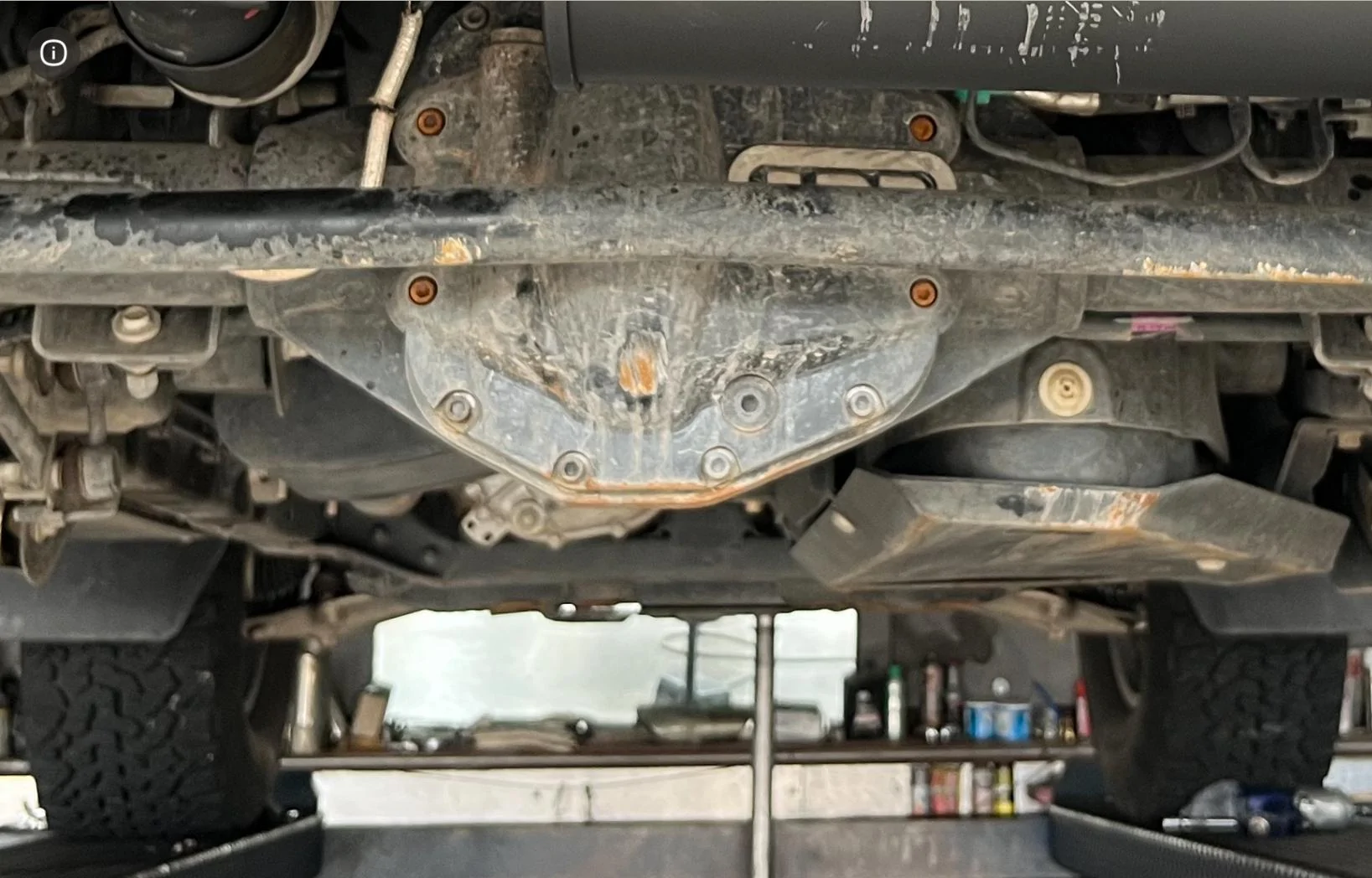

I’m doing my rear diff for 1st time this week pre-K2 in TX, everything else right after. Here is a picture of my 2023 WT rear diff after 7K and heavy highway, local, and off road wheeling.
The 4 rusted bolt heads next to the axle housings have caught my attention at mile 1500 post-Moab and some mudding in CO, now I think it may be from heat generated on serious trail rides and crawls. What do you or anybody think?
