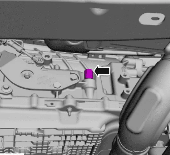

This may be a dumb Q, but is the automatic transmission sealed in the Bronco? I noticed I don’t have a transmission dipstick like some older cars.
If not, should the auto trans fluid be changed early as well?
There is a dipstick, it is just only accessible right by the transmission. I forgot what side it is on.
Check owners manual for the "official OCI," but personally I like doing drain and fills every 40k.
@malpais - Driver's side towards the rear on the upper side. It looks like a large nut.
@malpais (a quick edit):
Ford Bronco Change Driveline Fluids Early! Transmission Dip Stick
Here is the level (should be between 4 and 3 on the stick with the transmission at temperature and the engine idling in park):
Ford Bronco Change Driveline Fluids Early! 10R60 Fluid Level
Which if it’s like the Ranger - it only gets to correct temp (190-200°F) for testing during ambient temps of 70°F+ and driving 10 or so miles above 70 MPH and/or hauling.
