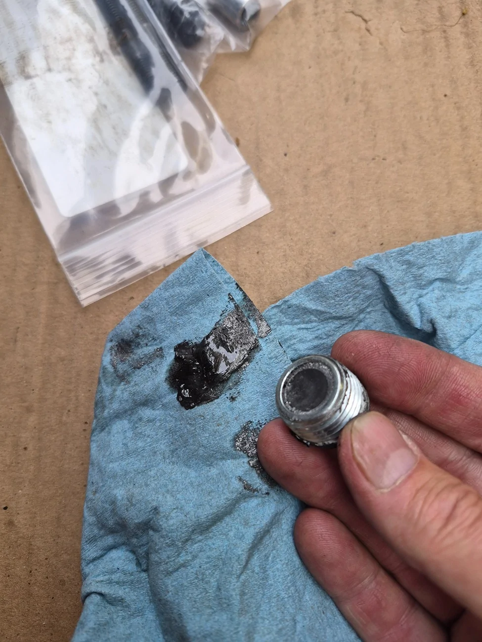

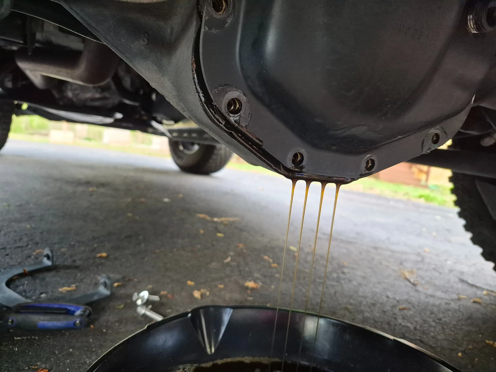

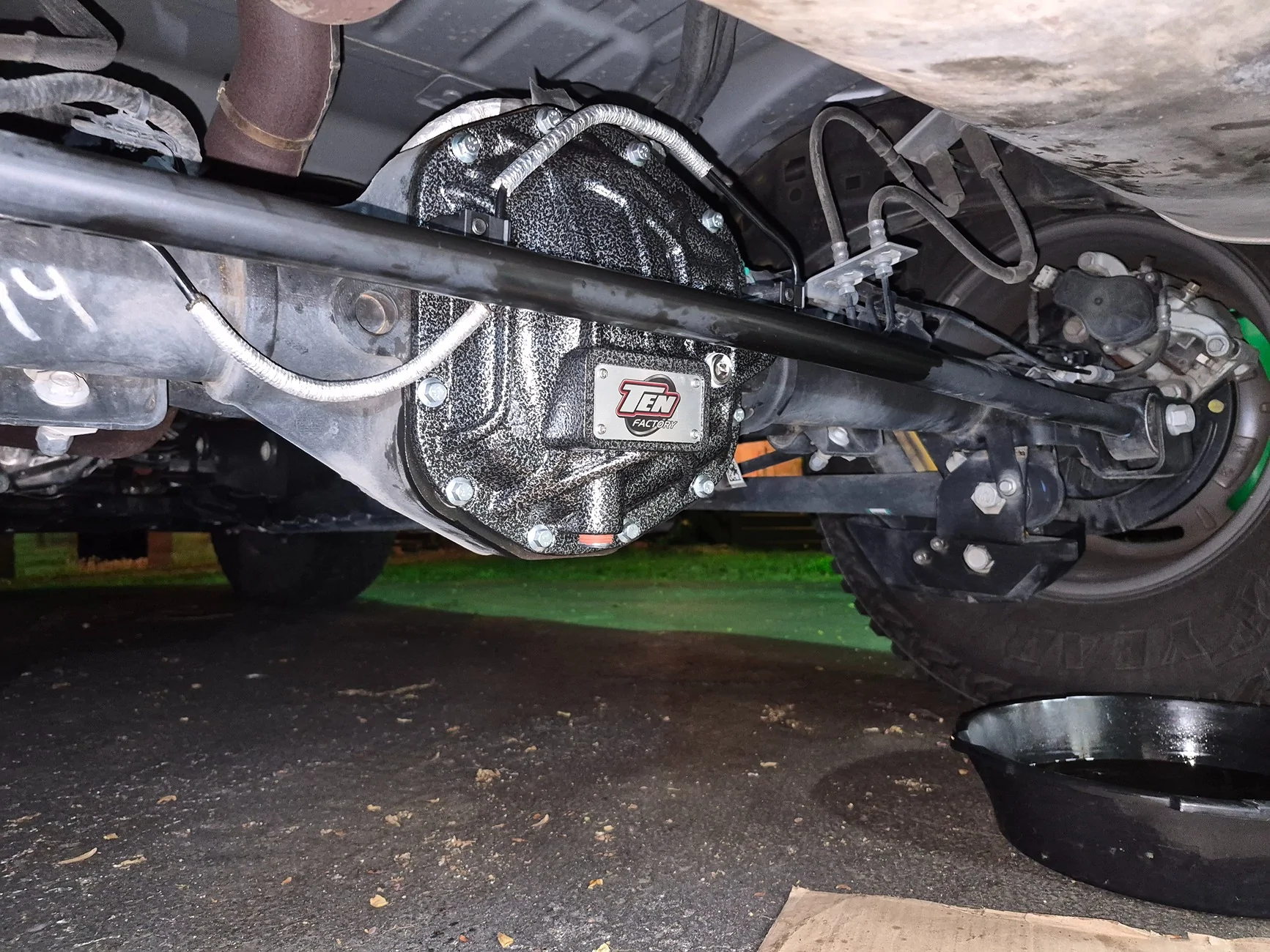

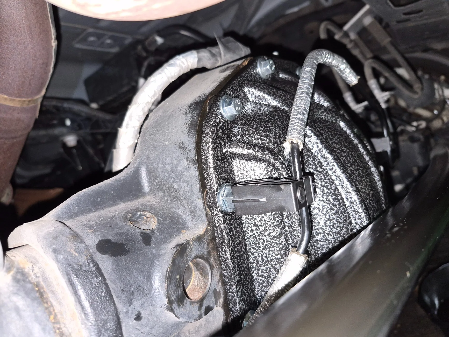

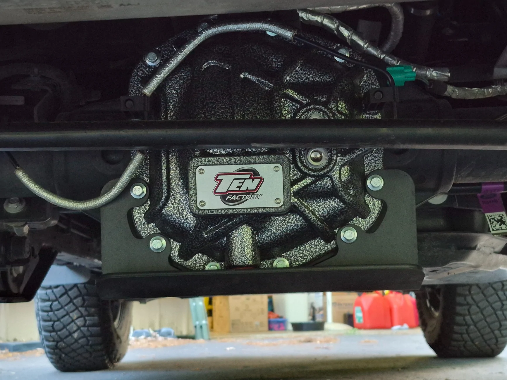

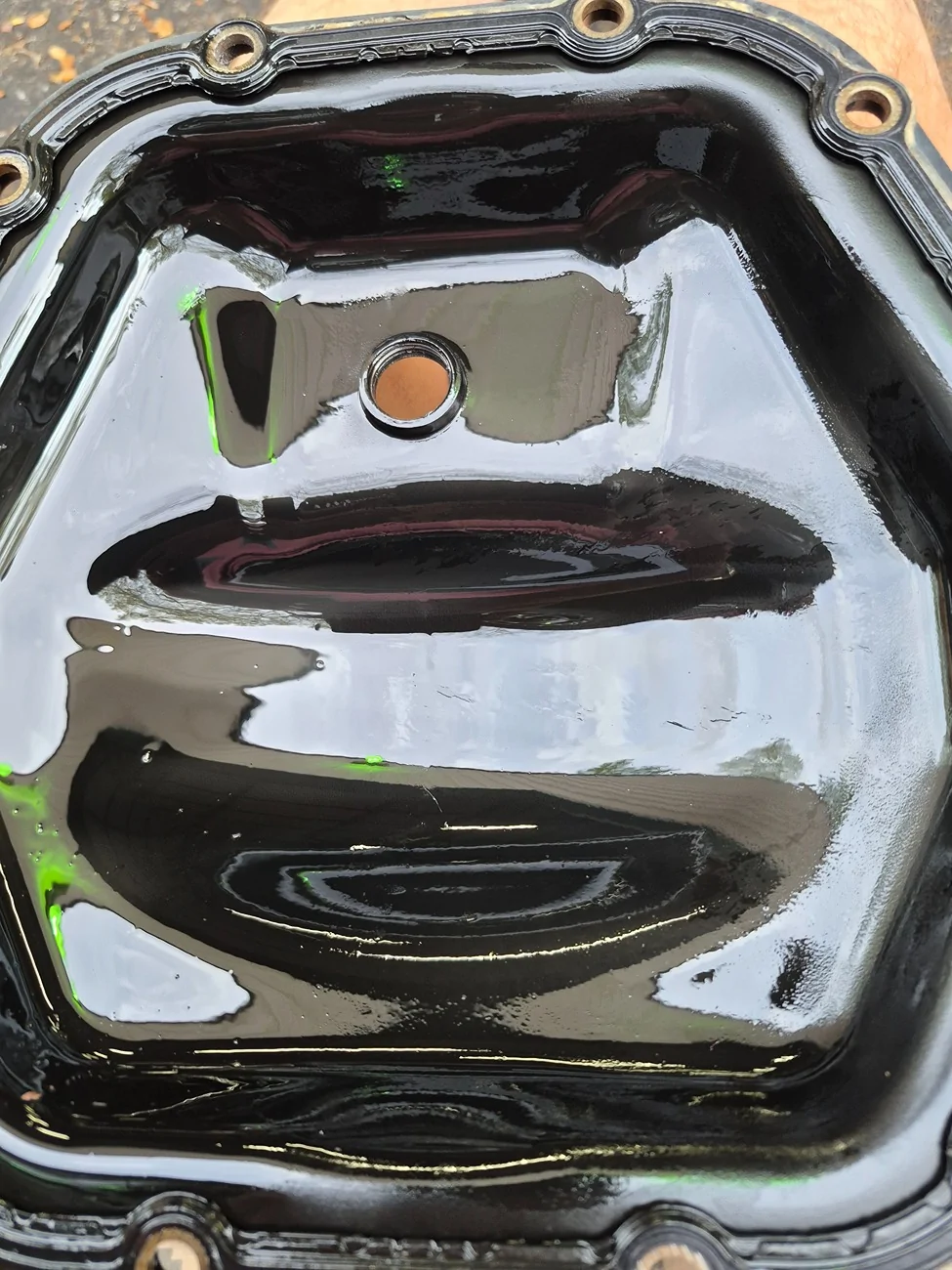

Seeing how the Ford diff covers are on perpetual backorder....save a few bucks and went with a Ten Factory. Oil was not bad at 20K, but had a nice bit on the magnets. Like the looks and with the hardware suggestions from CarbonSteel, the armor was able to be used and stock brake line brackets.

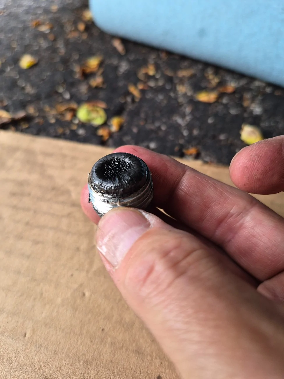

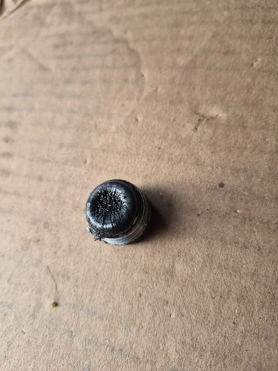

Late to the party. Did the front & rear diffs and xfer case at 65k. The magnets on front & rear (especially rear) has a lot of metal paste. Fluid was dark. Xfer case was easy but made a mess as I couldn’t remove the xfer skid ( asfir trans skid was so deformed I couldn’t remove. Another day)

front diff only took 0.8 liters before it started draining from fill hole. Maybe the angle didn’t allow all fluid to drain? It was level on a lift. Is that odd?

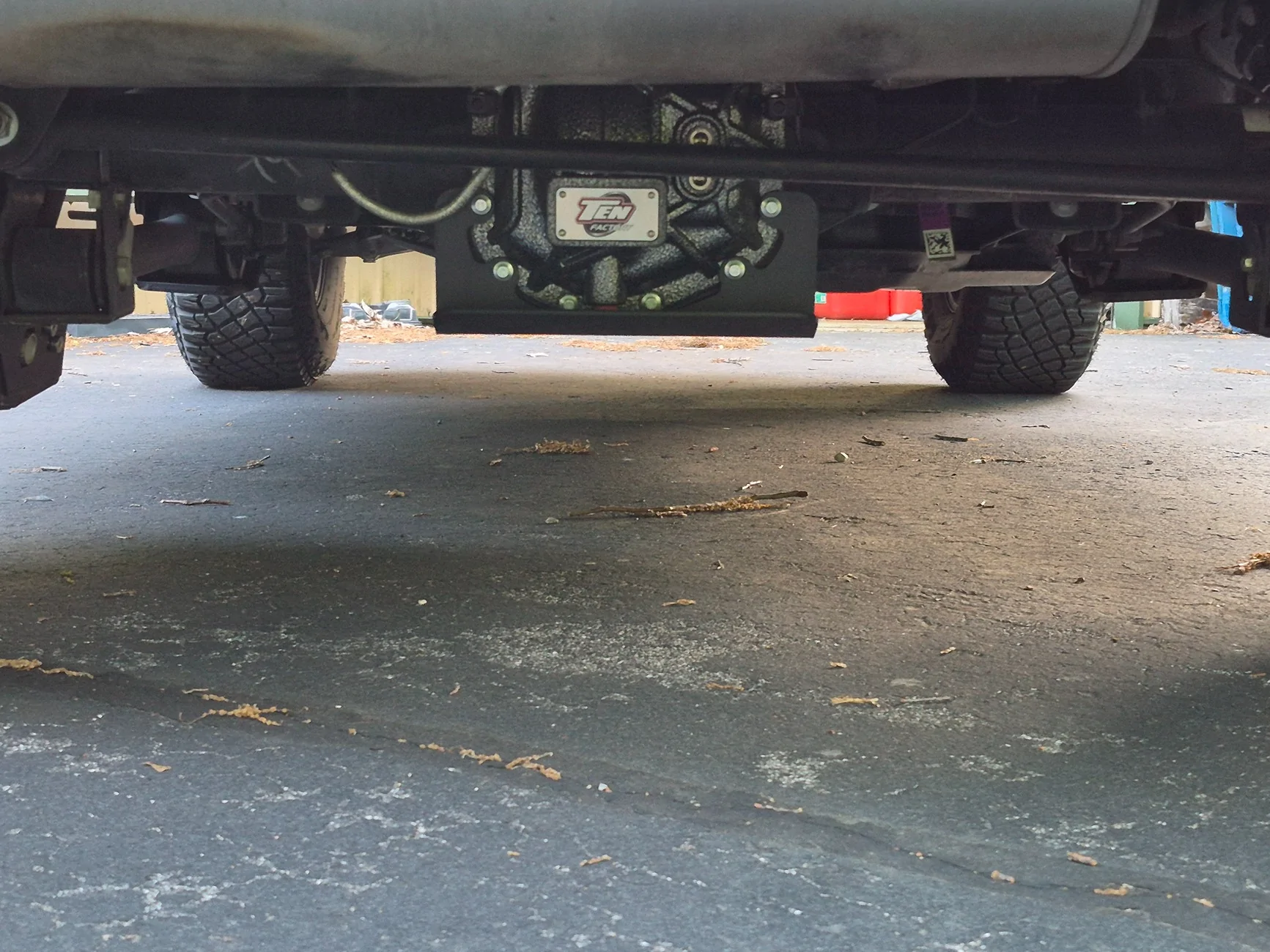

Also added a Ronin oil drain plug. Not sure if that’s good or bad. I’m sort of annoyed that I need to keep track of a drain plug threaded thingy. Didn’t know that when I bought it. My mistake.

Also added a Ronin oil drain plug. I’m sort of annoyed that I need to keep track of a drain plug threaded thingy. Didn’t know that when I bought it. My mistake.
Its a good drain plug. A very odd thing to complain about, but you do you.
Just keep the Plug Threaded Thingyā„¢ļø in the back, where the jack is stored. Solved that problem.

Like I said, I’m not sold on Ronin convenience (yet). Having to keep track of yet another ā€œthingā€ to thread in to drain the oil makes me anxious. That’s just me. It’s a very well built plug. I don’t regret it (yet). I didn’t expect I’d need to carry another part that is easily lost.
I equate it to a wheel lock. Sounds good in principal. Yet YouTube demonstrates it’s a false security. And it’s a pain anytime you need to replace/rotate/fix a tire. So I’ve removed wheel locks. Unfortunately my new Method wheels require a tool to remove the lug nuts… so I’ve gained nothing. Oh well such is life.
Not bashing anything. It’s the rambling of an old guy who creates calendar events for things, eg Property Taxes Due. So I don’t forget. Heh.

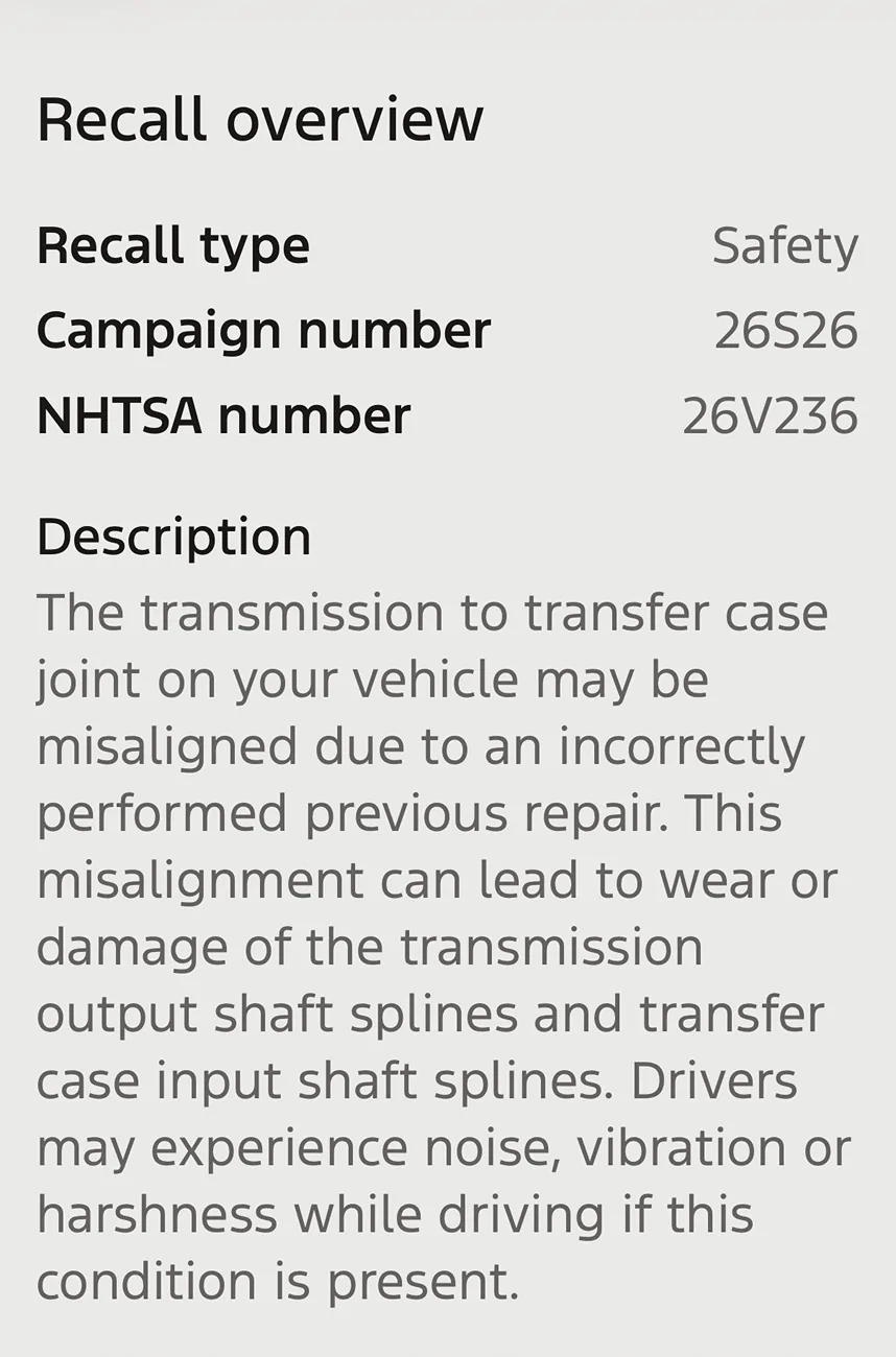

I was going to do the transmission fluid and filter at 30k, but… surprise! I’m getting a new transmission and transfer case instead. Guess I’ll be doing that fluid change at about 59k. I’ll probably have the dealer do the diffs at 30k when I get back from my road trip. Assuming they get the Bronco back to me in time for the trip next week. They say they will…
For context, this was because I failed the inspection for the recall below.
I don’t want to give the impression that I’m broken up about it. The bad part has been not having my Bronco for 4 weeks while the whole evaluation, parts ordering and repair process plays out. Assuming that the replacement is done properly and all is good, it’s hard to complain about resetting the clock on my transmission and transfer case back to zero at no cost to me.
