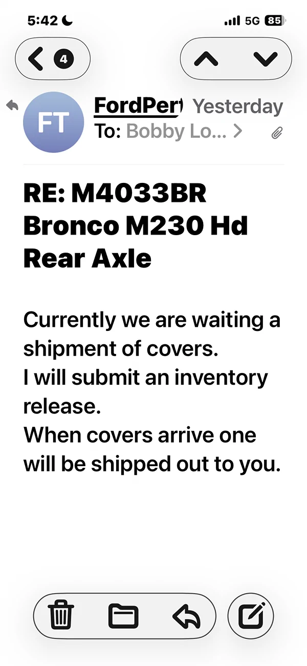

Worth a try. Is ot ALU alloy or steel? Can always have it powder coated.
In my experience FP is a joy to deal with and go beyond.

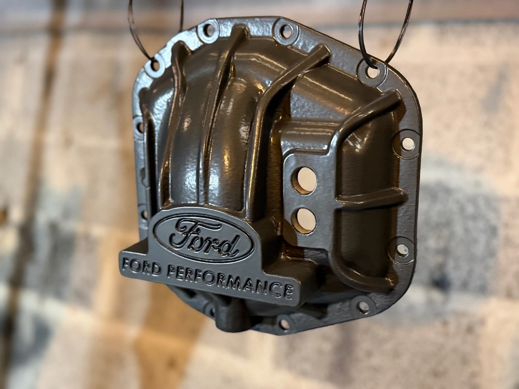

@Bobio - damn! That’s bad. I just got mine back from Powdercoat. Glad I did that in advance.
Did you use the factory gasket or the one that came with the cover? I wonder if @CarbonSteel was right all along…minimal thread engagement cause this or poor torque?

I used the original, and torqued to spec. If I remember correctly correctly. Lol
Where did you get yours Powder coated?

Looks like Ford Performance is awesome!
They seem to do well on warranty. I bought the tailgate reinforcement which was cracked, and they sent me a new one with no questions asked.
