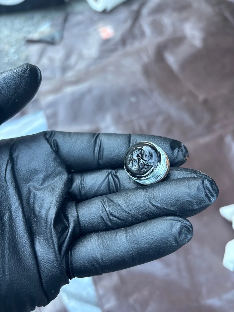

Finally got around to this just over 10,000 miles. I’ll be sending the motor oil in for analysis. Transfer case and front differential are done. I’m waiting on my rear diff cover to get back from powder coating. Then rear will get flushed. Transfer case was a little dark, but nothing alarming. Front looked pretty gray and had a decent amount of metal on the magnet.

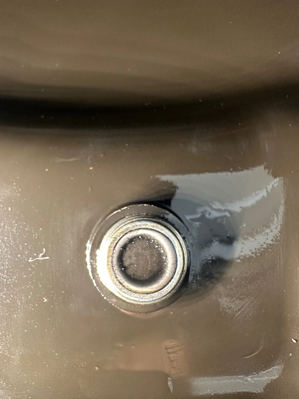

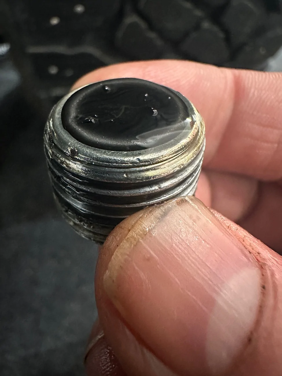

Did my Front and Rear diffs and transfer case for the 3rd time at 30k miles last night, after having done them previously at 3k and 11k.
Despite a few 2+ ft water crossings the fluids all looked fine. Will probably just do this every 30k or so from here on out, along with the transmission fluid.
Refilled diffs with Amsoil Severe Gear 75W-140 and T case with Mercon LV.
Front diff:
Ford Bronco Change Driveline Fluids Early! IMG_7314
Rear Diff:
Ford Bronco Change Driveline Fluids Early! IMG_7317
