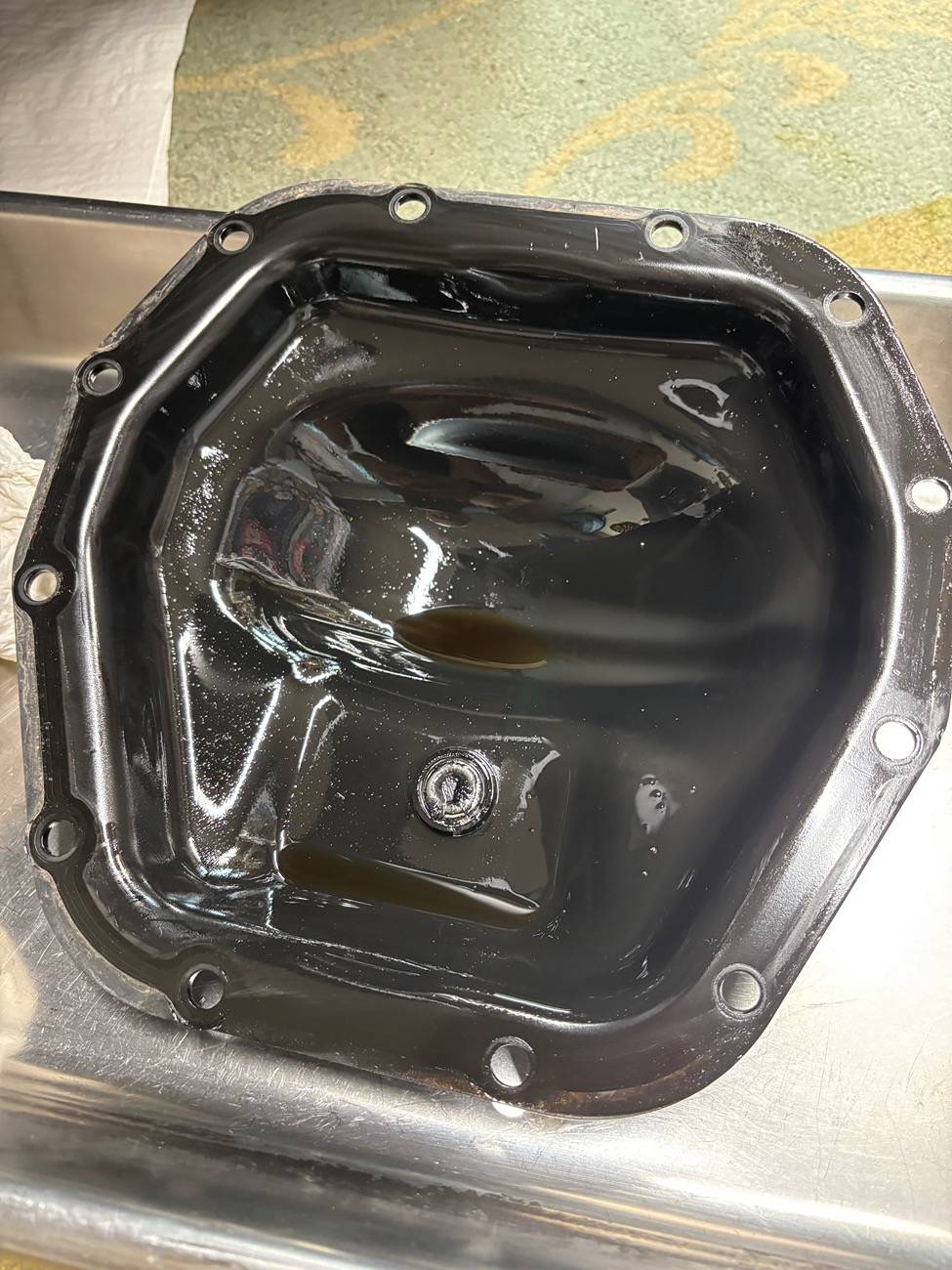

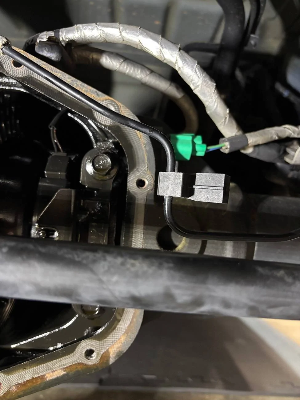

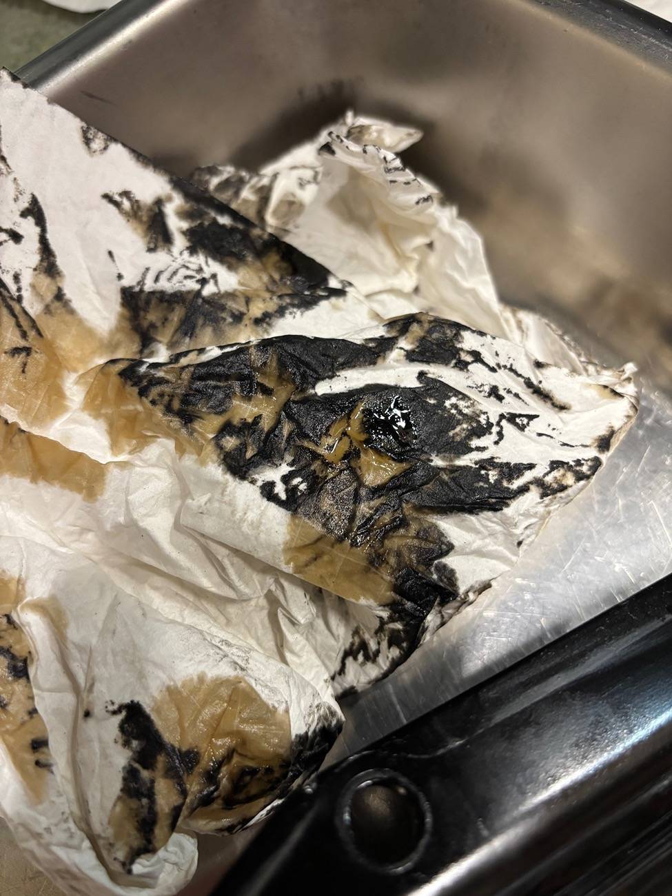

Not sure if this was mentioned (didn't see it on the first page). As mentioned in @popo_patty 's video you can just pop the brake line clips off of the studs with a trim removal tool (they're a Christmas Tree type of clip) and rotate them out of the way. There's no need to remove them from the brake line.
At 34K miles mine wasn't as bad as I was expecting. Some "paste" on the magnet but not too terrible.
I was a bit surprised at the effort required to remove the bolts, looks they might have had a small bit of sealant on them from the factory.
The fill plug was a tad over finger tight (I could have took it out without using a ratchet), didn't expect that either.
