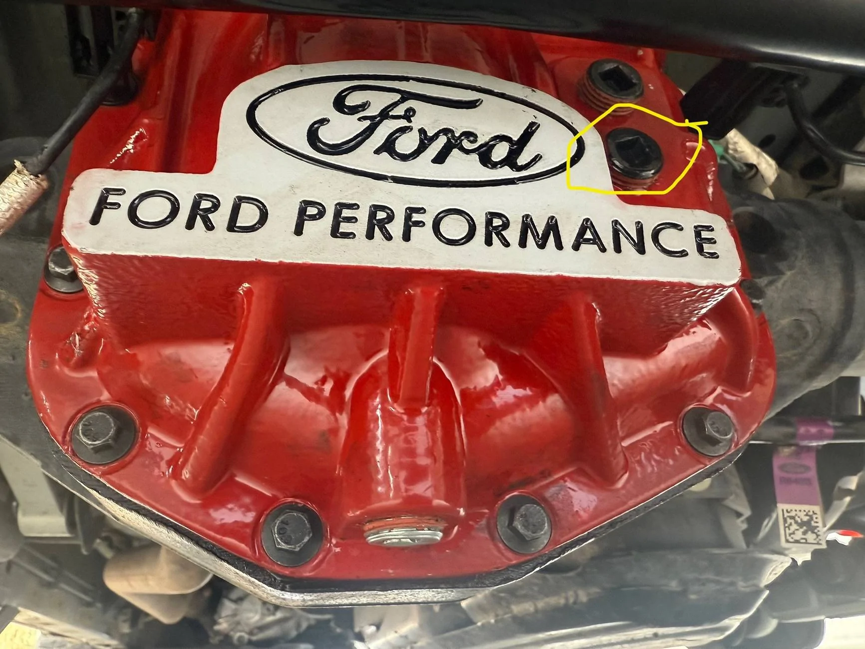

As far as lift goes from the stock SAS height, I am probably 3 inches lifted with Icons. Assuming you mean this lower plug?

Thanks. Looked just now and not a drop came out, assuming I wouldn’t see anything with it sitting anyhow will have to get some miles on it.
Correct; but given your lift, the top plug is likely fine.
