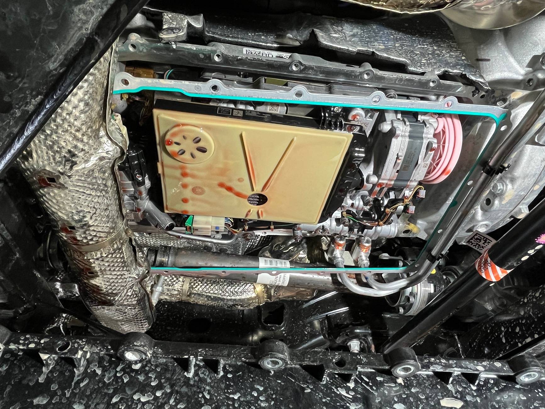

Hmm... strange, as I had to on mine, also a 2.7. Mine is non-sas OBX though, perhaps that's the reason?
I took this picture while doing it. You can see the Ford gasket. Mine was getting snagged up on the far left, looks like the exhaust pipe wrapped in a heat shield. I had to lift it up to slide that edge of the PPE pan above it to seat correctly. When lowered back down, it's about an inch of clearance between the pan and that exhaust pipe.
Photo reference - the exhaust pipe is towards the rear of the car. Photo taken from the passenger side of the car.

I was able to drop it down slightly and rotate it as I took it out--both the OEM pan and the PPE pan with no issues.
Nc211
Dec 16, 2023
48
813
1,508
Washington DC
yeah I couldn't figure that part out like you did! I got the OEM pan out fine with no issues, but couldn't get the PPE in without it. Now granted, by this time, I had been at it for a couple of hours and my 51 year old arms and back were starting to scream at me a bit, so I may have defaulted to the "f-it" factor on ease of plan with the tools I had handy. If you have to lift it, it's really simple to do as well. The two bolts to unmount the transmission from the cross member are right there as well and easy to back out. A simple floor jack with some wood did the trick. On mine (non-sas) it was a small piece of a 4x4 block I had with plenty of lift to spare.

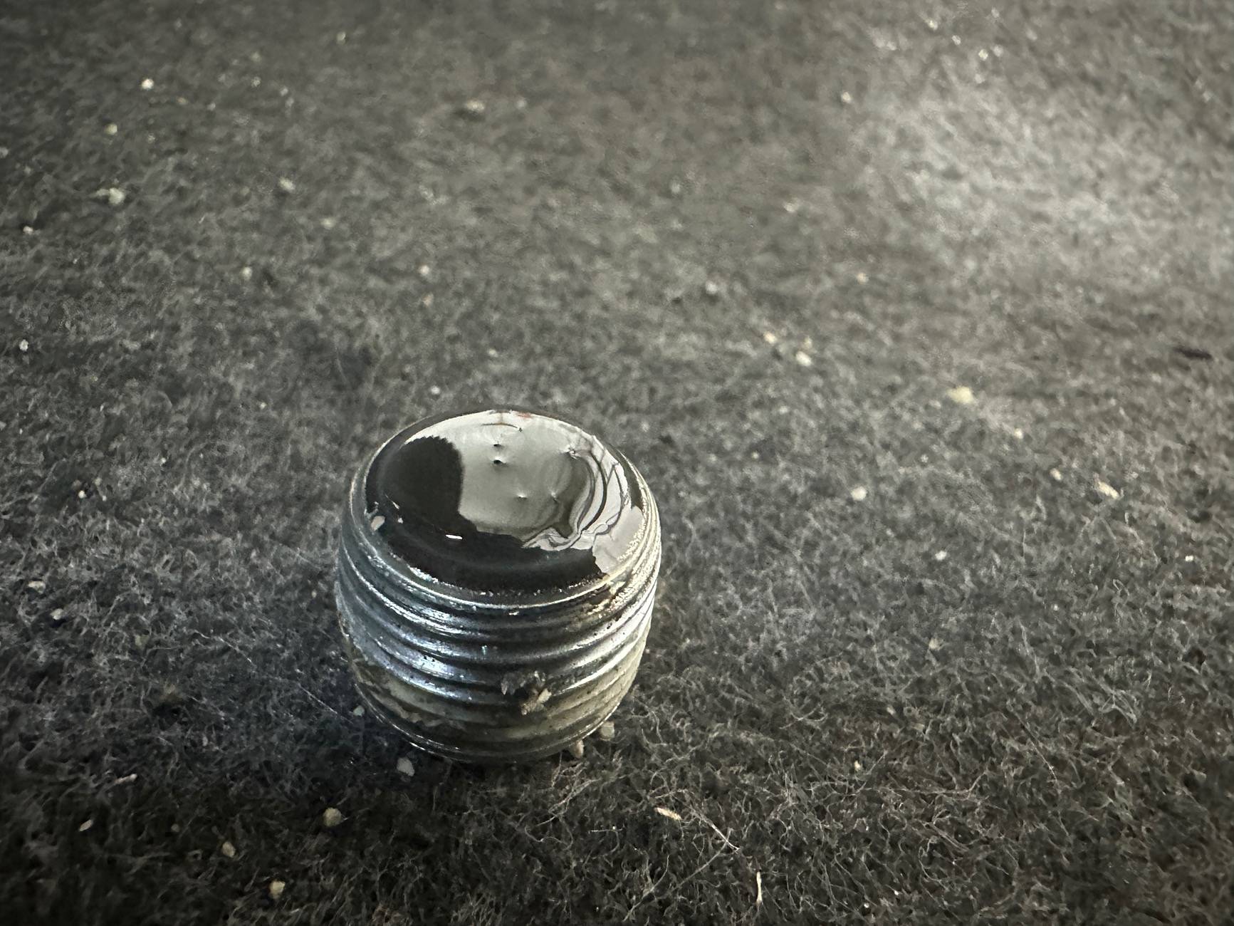

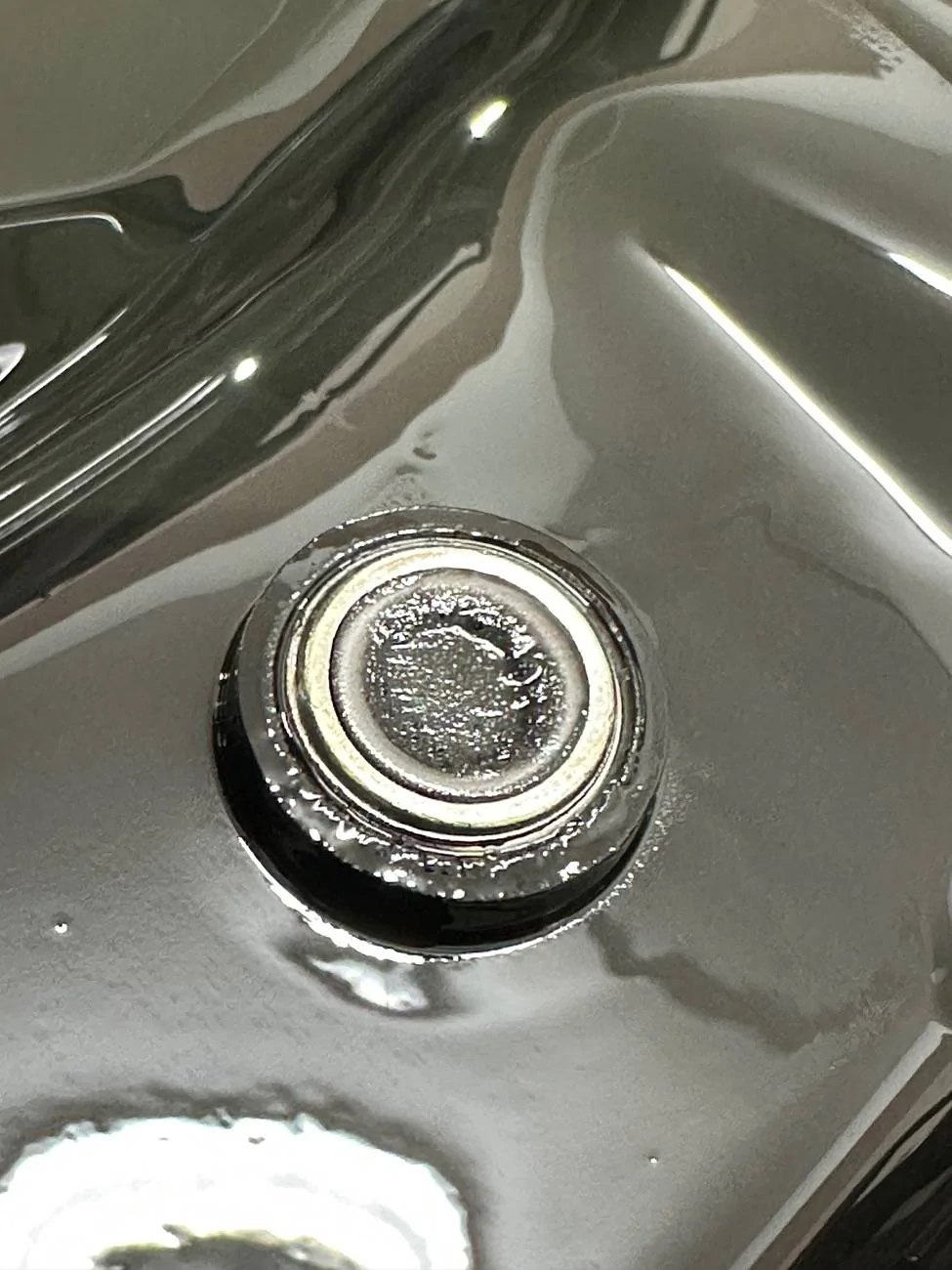

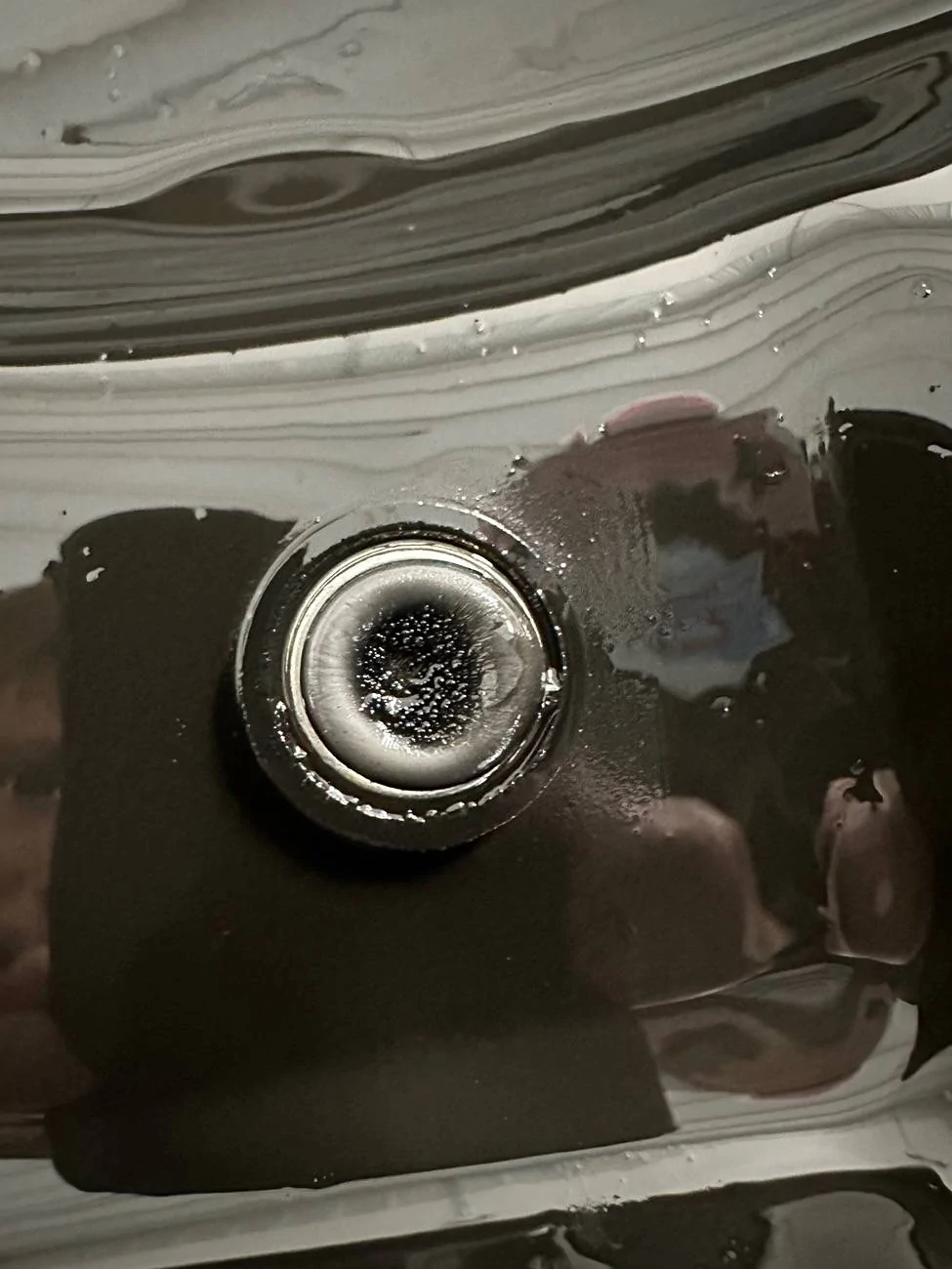

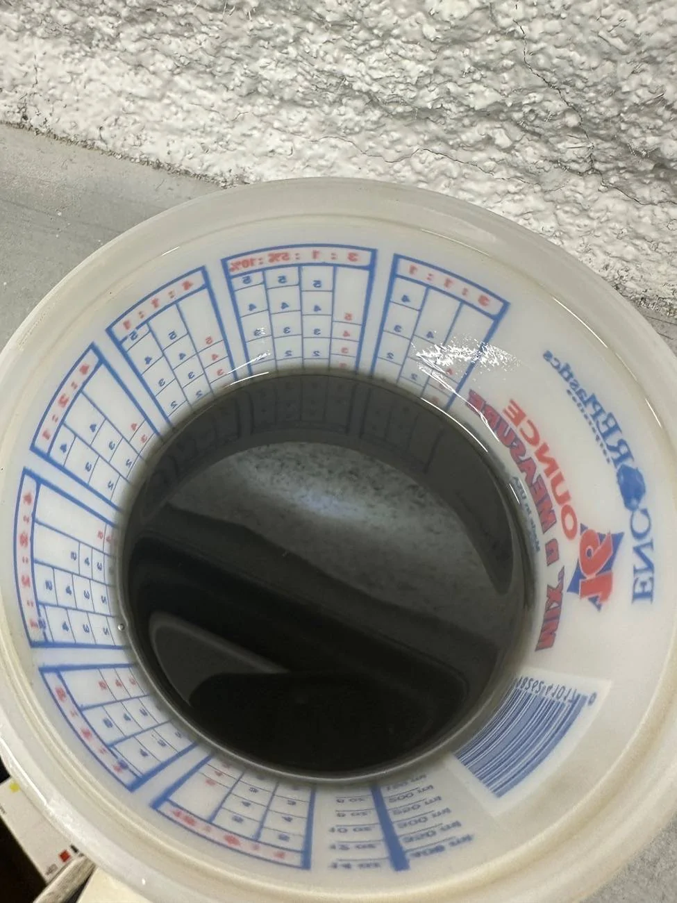

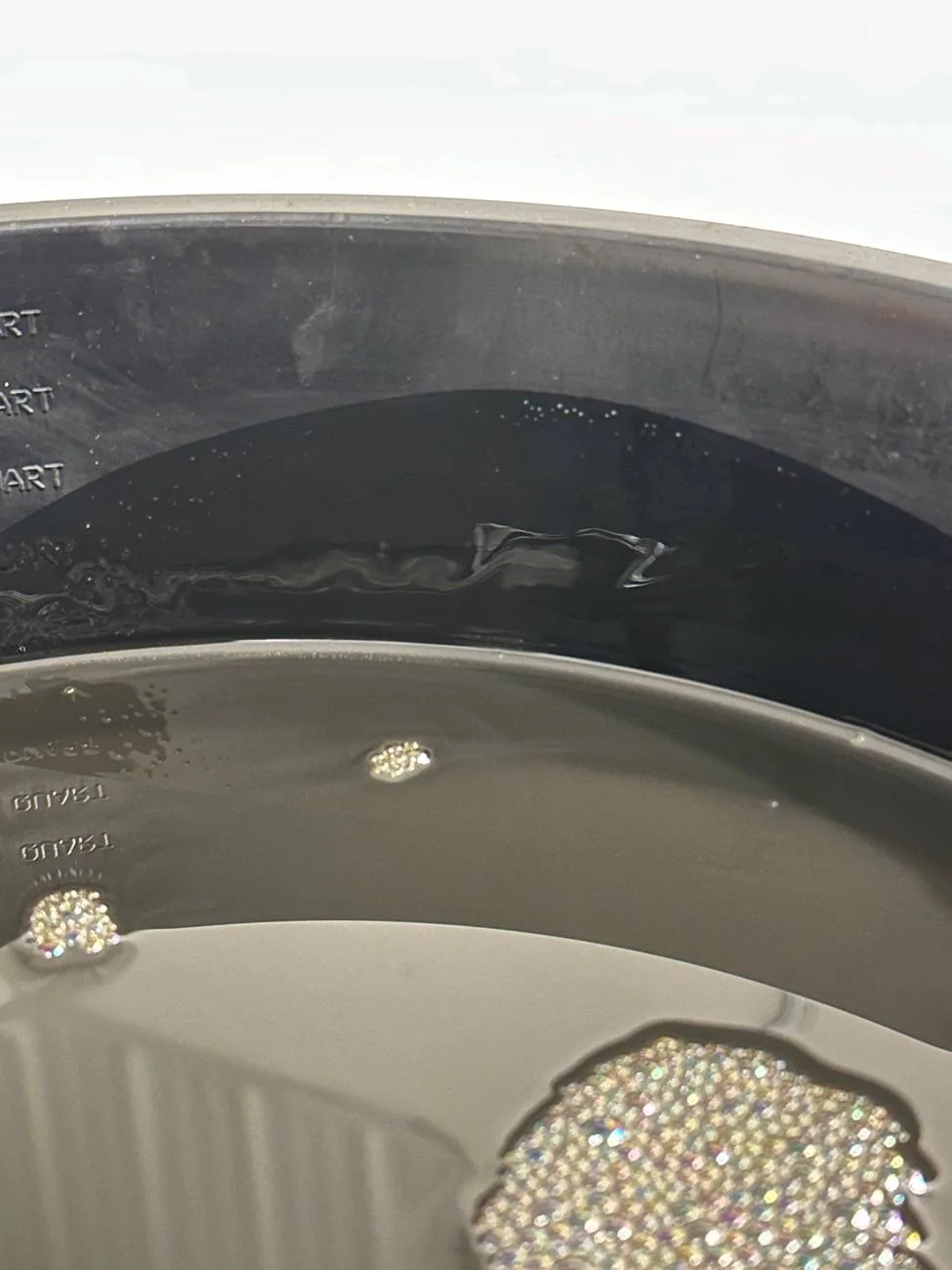

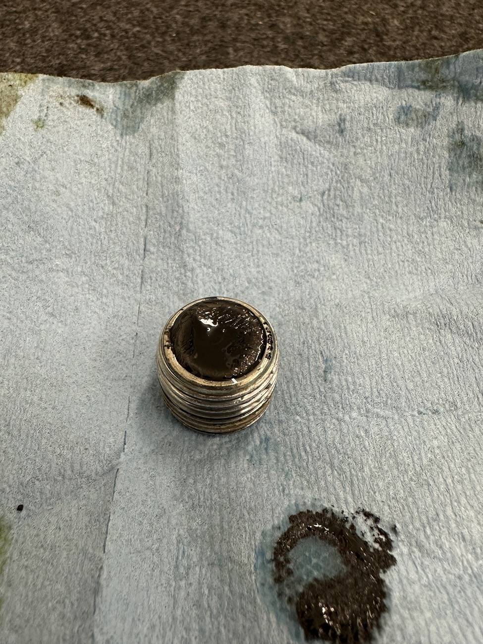

Did the second round on my Wildtrak at 11,000 after doing it before at 3,000. Id say about 20% as much metal on the drain plugs and the transfer case fluid still looked pretty bright. Will probably wait another 20,000 miles. I did a few ~30” water crossings and partially wanted to check for any water. Didn’t find any that was discernible. Refilled with Amsoil Severe Gear 75w-140 and T-case with Mercon LV again.
I’m still using the factory rear diff cover and original bolts with no problems or leaks after a few reassemblies.
Just need to figure out what my transmission philosophy is going to be. I’m thinking I’ll wait until 30k and hire it out, dropping the pan and the hot refill sounds tedious. Maybe I will change my mind and try it.
Rear diff plug at 11,000 mi.

vs 3,000 mi
Ford Bronco Change Driveline Fluids Early! IMG_2355
Front plug at 11k
Ford Bronco Change Driveline Fluids Early! IMG_3948
Front at 3k
Ford Bronco Change Driveline Fluids Early! IMG_2366
Rear diff fluid at 11k
Ford Bronco Change Driveline Fluids Early! IMG_3950
Rear diff fluid at 3k
Ford Bronco Change Driveline Fluids Early! IMG_2356
