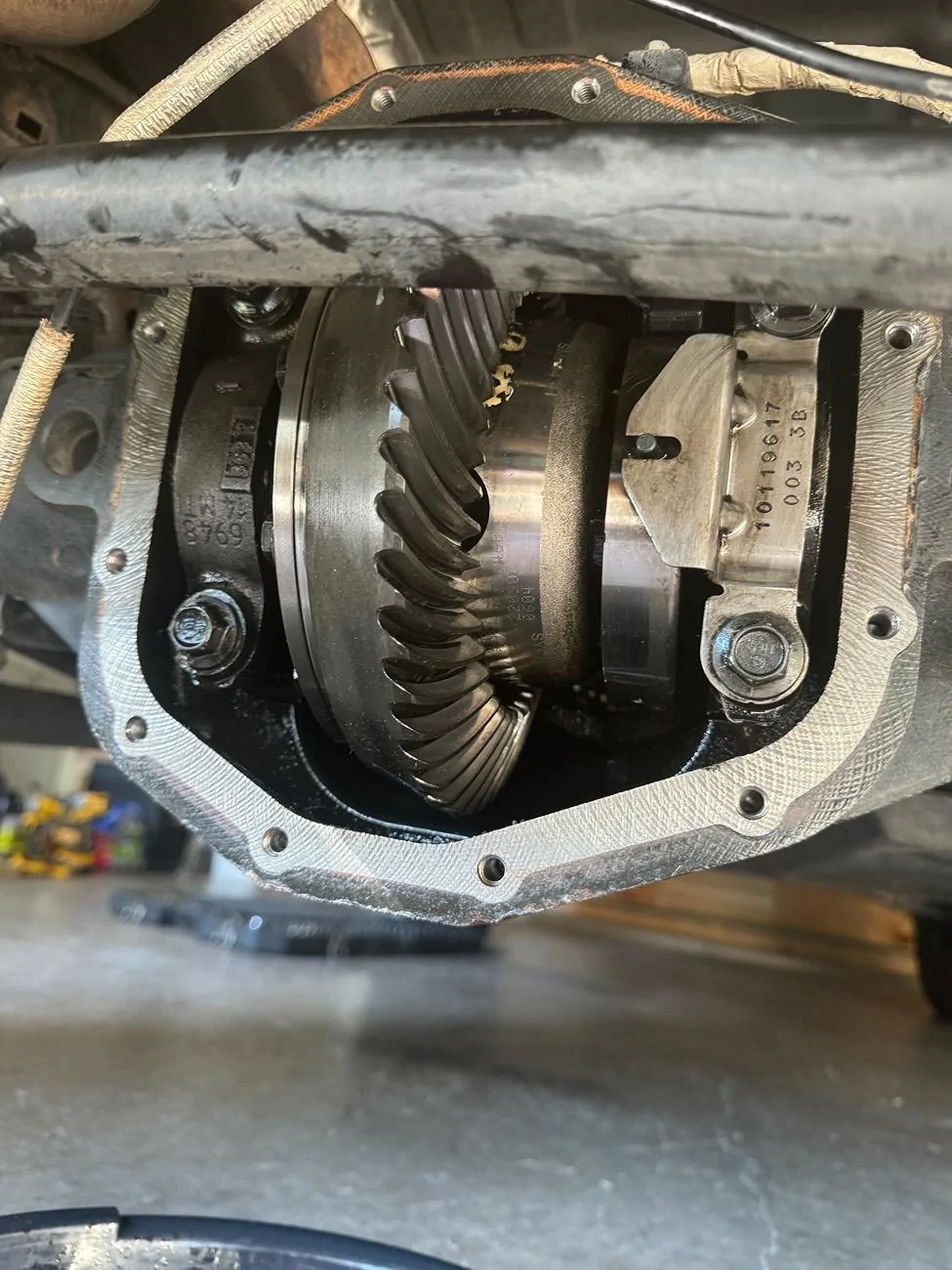

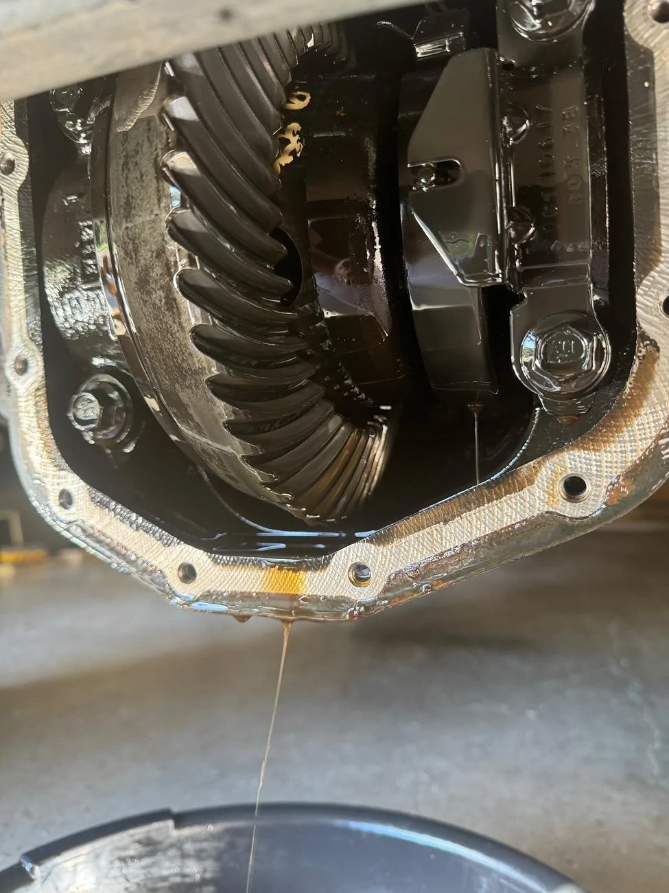

Changed my rear diff fluid for the first time this weekend at a little over 21,000 miles. Thankfully my fluid looked extremely clean with no noticeable metal floating in the oil. The magnetic plug had a little metal “paste” but all in all it looked significantly better than OP’s fluid. Maybe the 2.3 is gentler than the 2.7? I’ve done some towing at or near max capacity and a fair bit of off-roading so I expected worse. It did have the same black residue that wipes of easily. Before and after pics show shiny parts that were black in the first pic

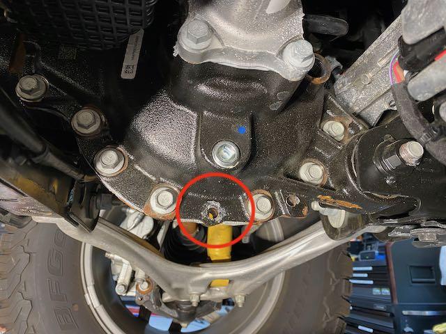

Now, on to the question for the group. I'm sure this has been asked, but my google-fu has failed me. I am missing two bolts on the forward diff. Forward hole def doesn't get one. How bout the hole circled in red?
edit to add: 2024 BL
Thanks,
Martin
Ford Bronco Change Driveline Fluids Early! IMG_4120
Ducati1098
9,957
23,121
Midwest
Thanks,
Martin
There shouldn't be a bolt in either one of those holes. Nothing is missing.
