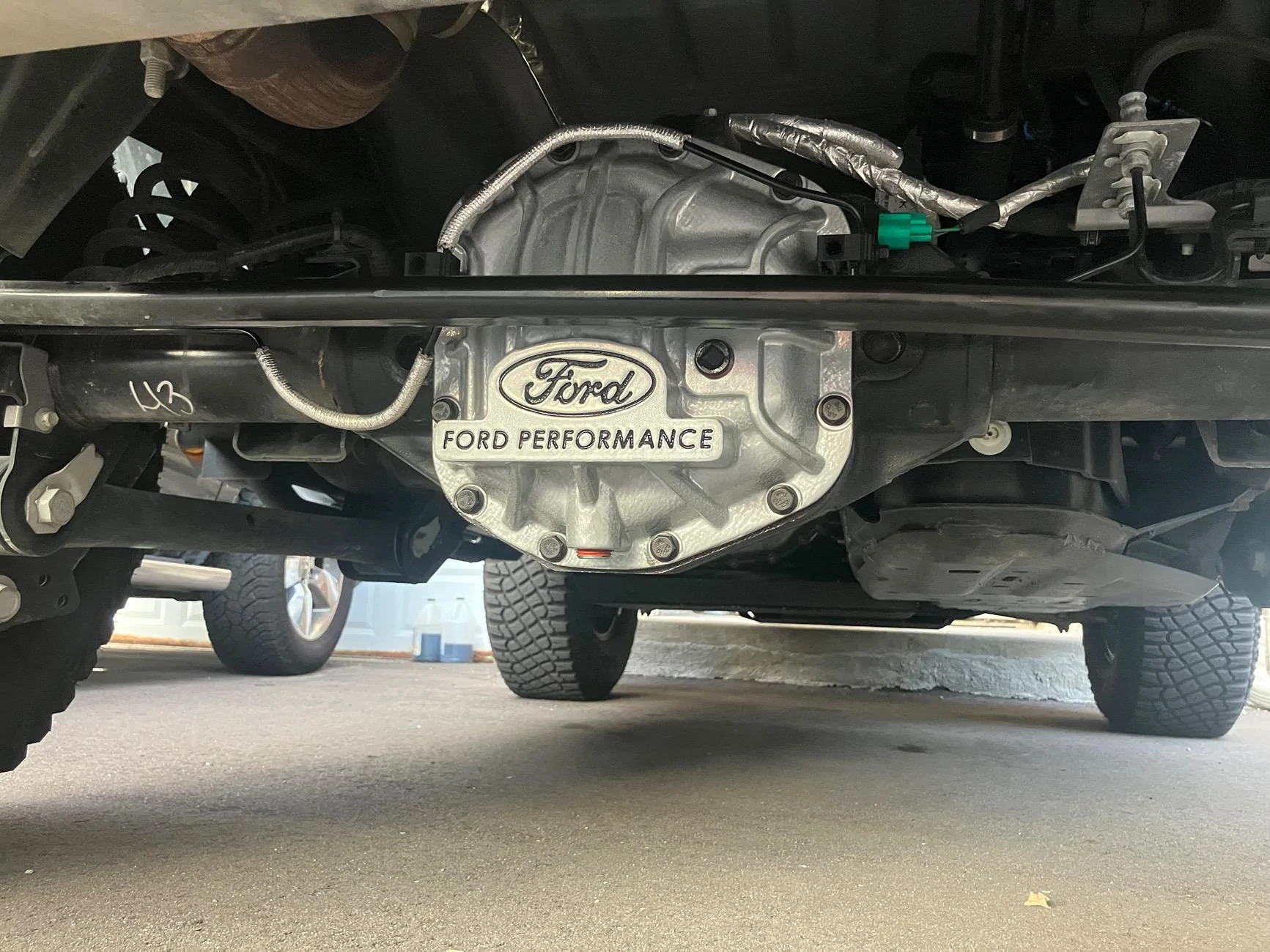

Finally got around to changing front & rear diff and trans case fluids at 19,249 miles. Also installed the FP Rear Diff Cover. Like others, front diff fluid was dark and magnet doing its job:
Ford Bronco Change Driveline Fluids Early! FD Plug
Ford Bronco Change Driveline Fluids Early! FD Fluid
Same with rear:
Ford Bronco Change Driveline Fluids Early! RD Plug
Ford Bronco Change Driveline Fluids Early! FP Rear Diff

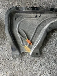

I found the cause of an unknown rattle when I removed the t-case skid. You can see the outline of where it came to rest/rust/rattle... For the record, it's not mine.
Ford Bronco Change Driveline Fluids Early! TC Skid

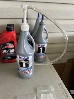

I found this pump & hose to work well and minimize spillage although it requires a lot of pumps...
Ford Bronco Change Driveline Fluids Early! Pum
Thanks again @CarbonSteel

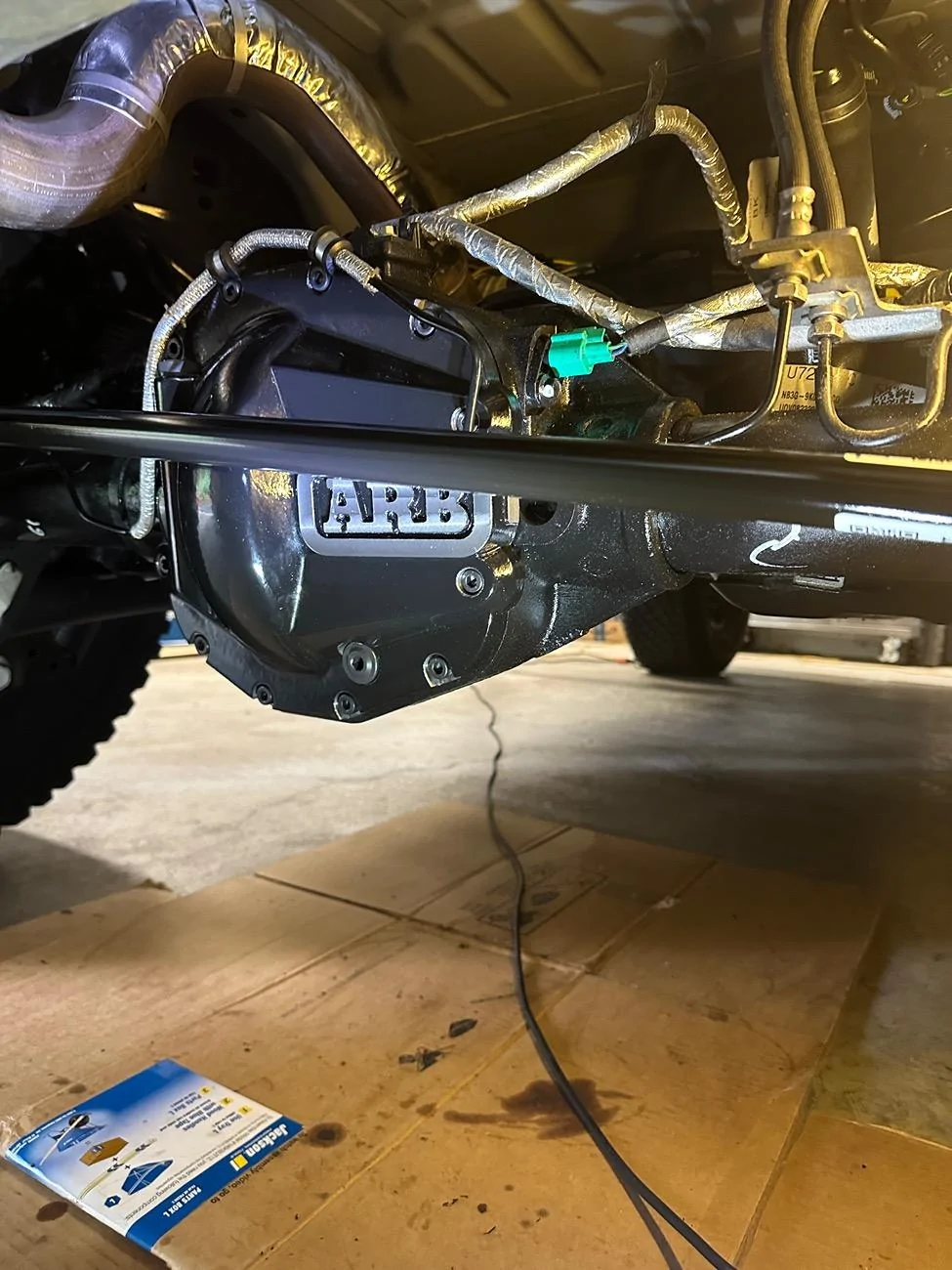

I took today to complete front differential, transfer case, and rear differential fluid change at 4700 miles. As others have reported, I too found the rear differential in need of fresh lubricant. Replaced transfer case fluid with Motorcraft Mercon LV and both differentials with Valvoline synthetic 75W-90 fluid in flex packs. Additionally, I replaced the rear differential cover with the ARB unit ($177 shipped from Extreme Terrain) allowing for ease of future fluid changes. Love the magnetic dipstick and ease of filling the diff with fresh fluid using the flex packs.. Also the magnet on the drain plug is a beast!

I haven’t heard much about the ARB diff cover. How does it compare to the FP cover with regard to gaskets and bolts? Why choose it vs FP?

Lots of differential cover options out there to choose from; the ARB met my needs. With the ARB cover you reuse the oem gasket and M8 hardware is provided in the this kit. I purchased and used two, 3/8-inch rubber insulated clamps from the depot to secure the rear brake line. I did have to enlarge the clamp's bracket hole slightly so as to accommodate the larger M8 hardware.

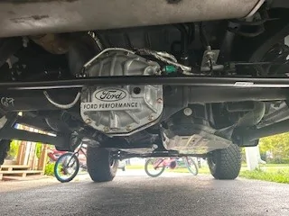

Finally got the rear pig cover installed. Guys, I can't tell you how happy I am to see that $&@! on there! Thanks to everyone who took the time to share your knowledge and suggestions.

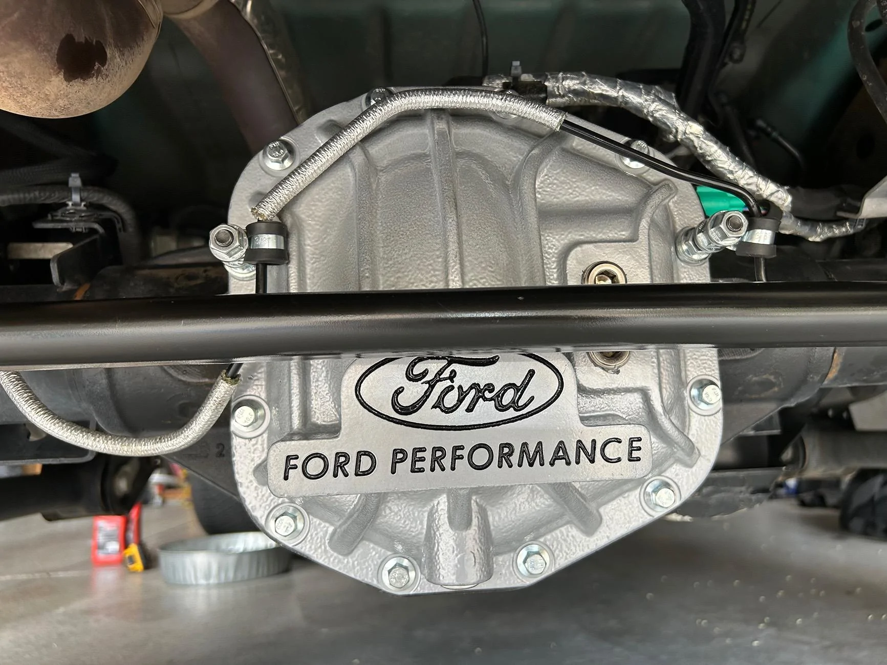

Thank you everyone for your advice. Everything worked great! Amsoil 75w-140 F&R, BG Syncroshift II in the manual transmission, Ford Mercon LV in the transfer case. 23,000 miles, better late than never.
